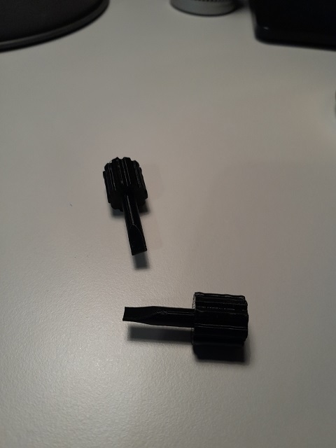

Have you like me cursed all living and dead carburetor designers that placed the idle mixture screw on the underside of the carbs?Blessed are the guys at Mikuni that placed the screws on top, genius engineering that when into that.
Every now and then a friend shows up and ask if I can adjust their carbs, lately I was unlucky and a friend owning a CB750F -83 showed up and unfortunately, I agreed to help out. Little did I know about the Keihin VB42 carbs, what a pain. The floats cannot be adjusted, and they only come into styles, overflowing or much too low.

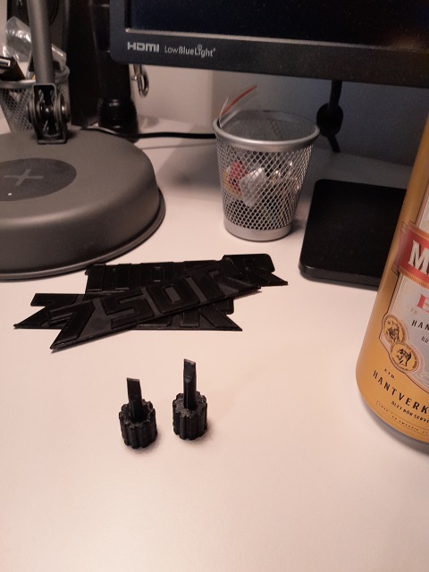

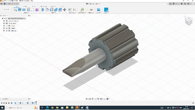

Anyhow trying to set the Idle mixture turned out to be a close to death experience, I had not tool except just a screwdriver bit to try to adjust the mixture. Definitely not the right tool for the job, so I made these if any of you need.
Whipped out a miniature screwdriver in Fusion 360
and printed them on my Creality Ender 3 Pro.
Fusion project and SLT files for 20 and 25 mm screwdrivers attached.
Brgds Anders

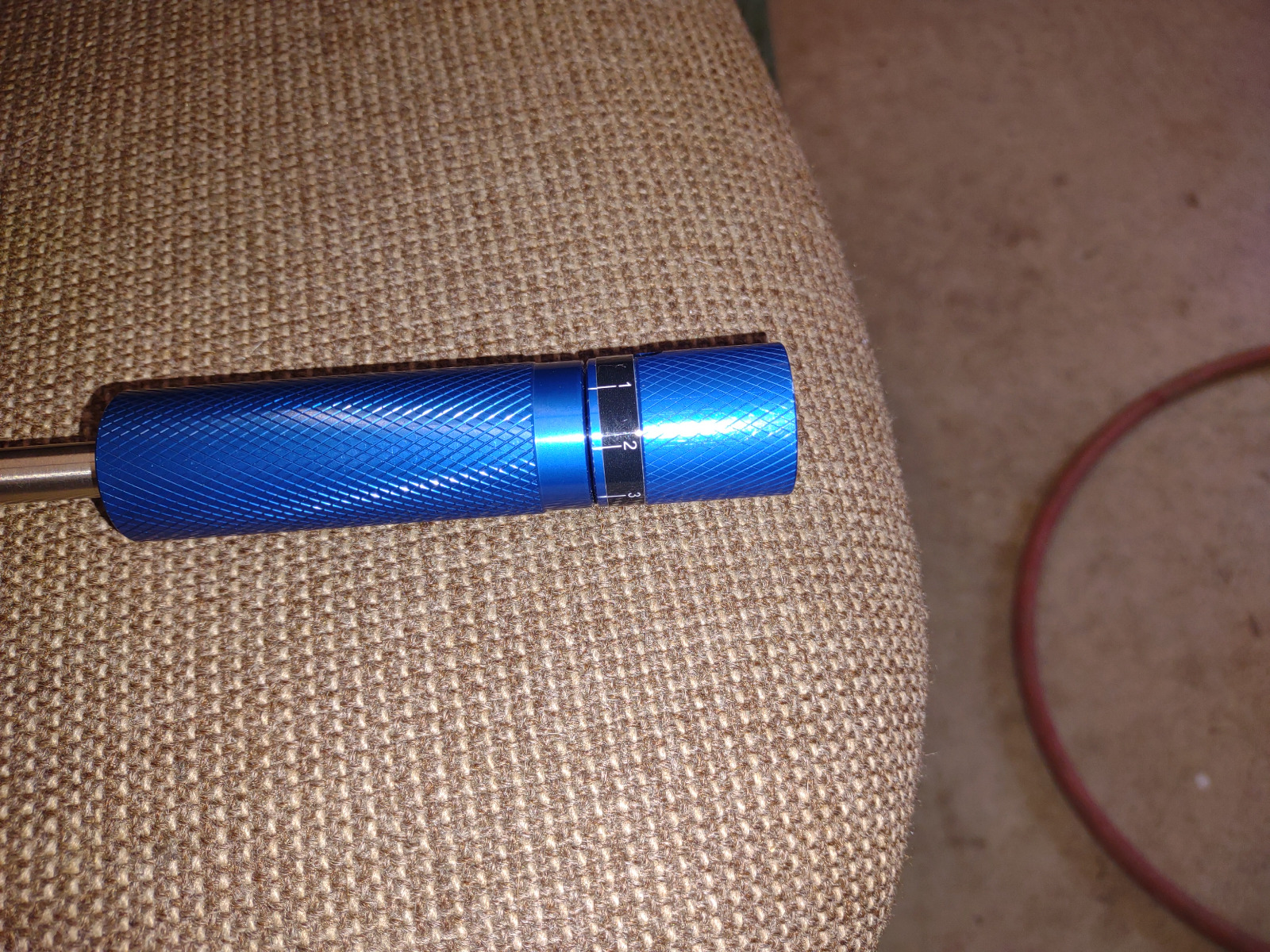

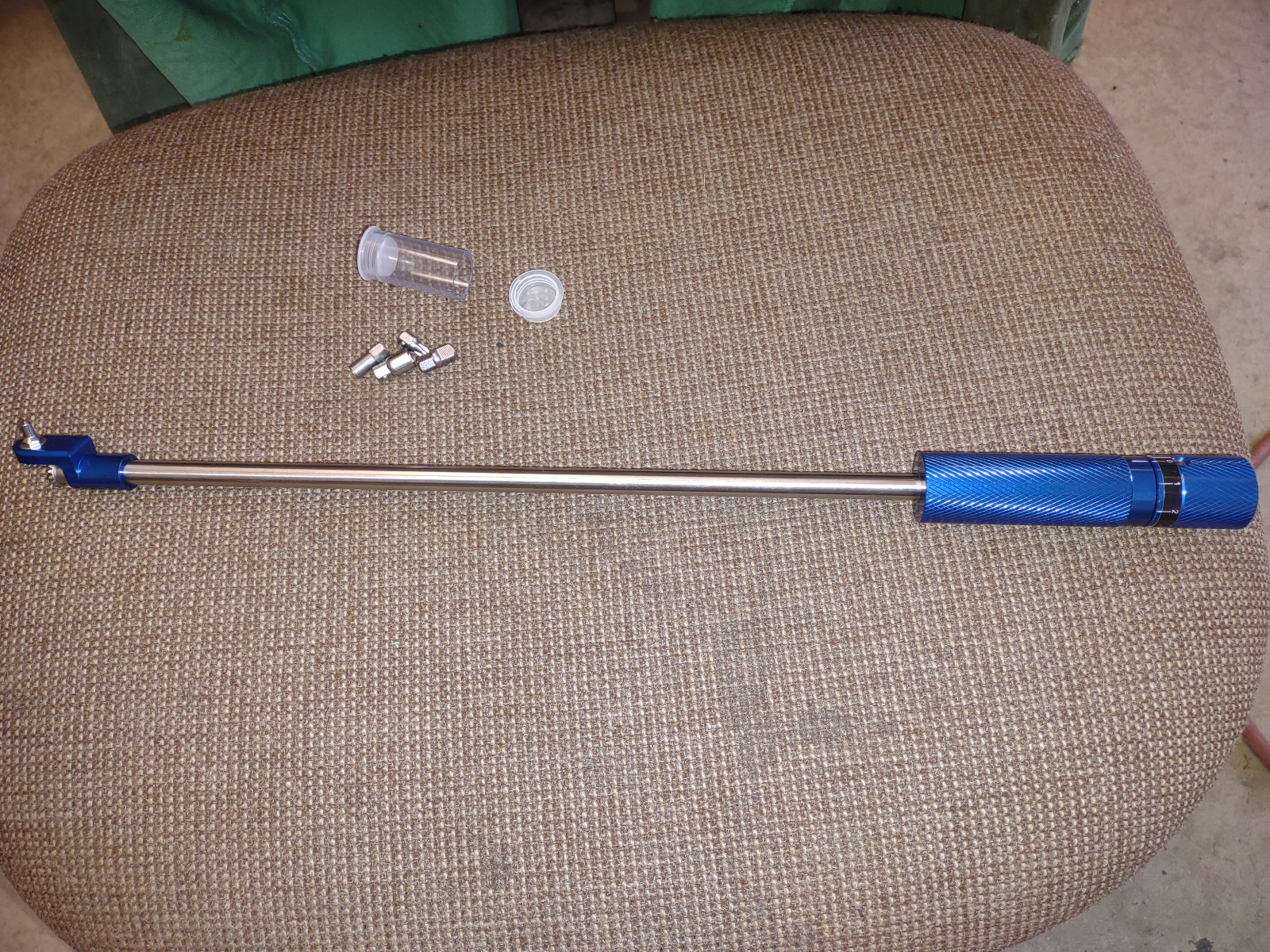

We use a Motion Pro geared 90° screwdriver. It comes with tips and the handle clicks in 1/8th turn increments.

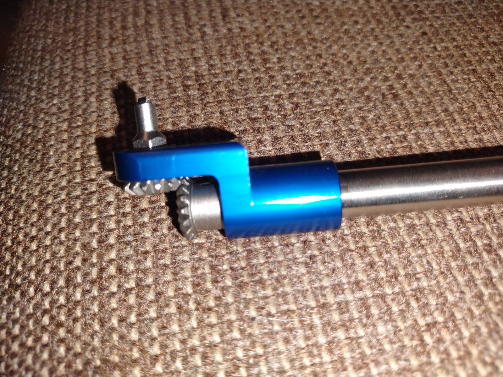

Dang-it, I neeeeed one of those!
Seems like a perfect subject to 3D-print, except of course the steel tube, main shaft and screw-driver bits (got loads of those in the bottom of my tool-box, for some reason !)
Maybe I should to draw helical bevel gears, for a smooth action... hmmmm

Simple tool to make using radio controlled model car differential bevel gears.

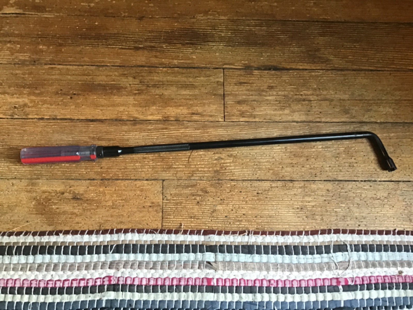

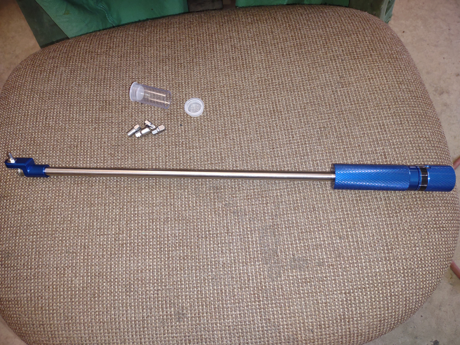

Not mine but rather belonging to someone who does it for a profession Mike Nixon
motorcycleproject.com/text/tools01.html
motorcycleproject.com/text/tools02.html
