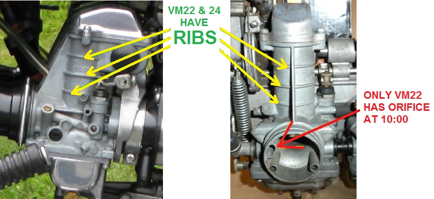

First as I understand it for the 78 650 SR, there was a D1 and a D1a offered that year. The main difference is the size of carbs that came stock on them. The D1 came with vm24ss carbs that to the best of my knowledge came with an air screw only. The D1A came with vm22ss carbs that only came with a pilot screw. You indicate your carbs have pilot screw, so are they vm22ss carbs? If they are they should have an oblong port like structure at about 10 o'clock in the intake bell of each carb.
Since it will not idle with the pilot screws set 1 1/8 I would attempt to increase the pilot air to fuel ratio by turning the pilot screws out some more (1/8 to 1/4) see if it will idle without the enricher/choke engaged.

If your carbs are properly set up....correct float height, proper synch, etc....Nessism is right. You need a proper air box. Without it your bike is getting too much air and not enough gas at idle. Using the choke adds gas, which is why the bike will idle correctly with the choke on. The larger main jets won't help at all when the bike is idling.
