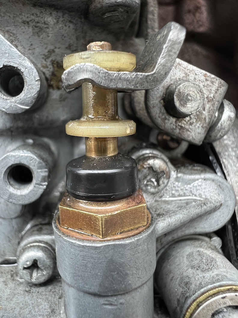

Did you hit the starter plunger or its mechanism?
If you did, then in all likelihood one or both are bent. Unless the bend is sharp enough to cause metal fatigue, they can be taken apart and straightened. Some pictures would help.
If you try the tapping method again, stay away from all the mechanisms. A few moderate taps on the bowl is all that should be tried. If that doesn’t work, the needle and seat need to be carefully cleaned or replaced.

Below are a few photos. This is what it looks like when the choke is closed and in the normal position:

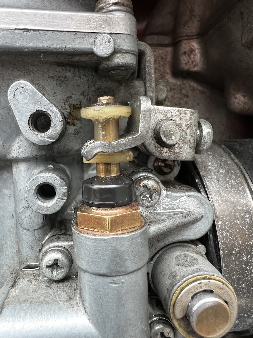

This is what it looks like when I put the choke on:

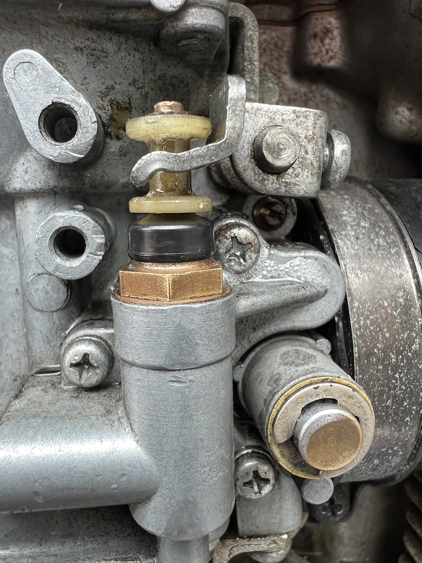

then I close the choke, you can see, it doesnt push the yellow part down and the choke is still open

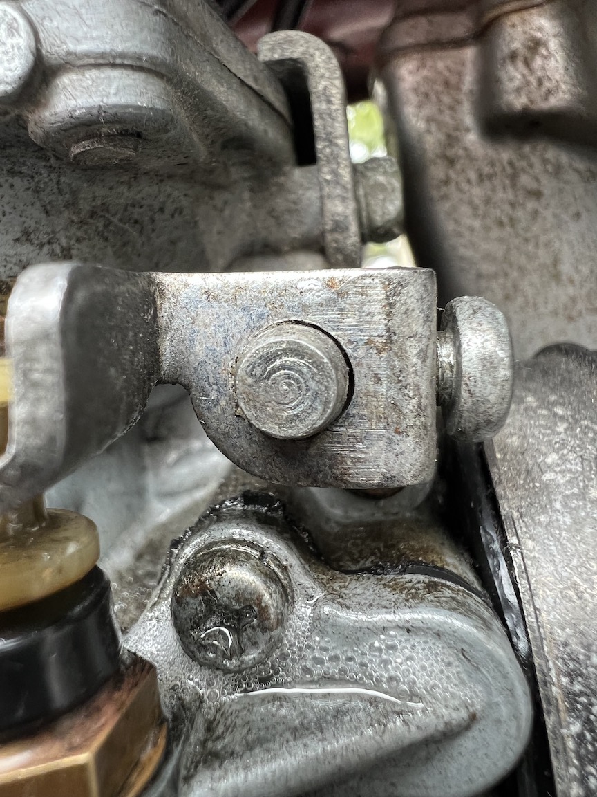

I did notice this little pivot thing which looks like i may be able to adjust it to close. havent tried yet but will when I take the carbs off the bike which should be easy (I have the manual)

Your choke plunger accutator rod could be twisted. The plunger fork arm fingers should touch the yellow plastic part and press the plunger fully down to the OFF position. The tention of the plunger spring only should press the plunger fully down to the OFF position, if not the plunger sticks some how like a bent plunger shaft or guide pin.
