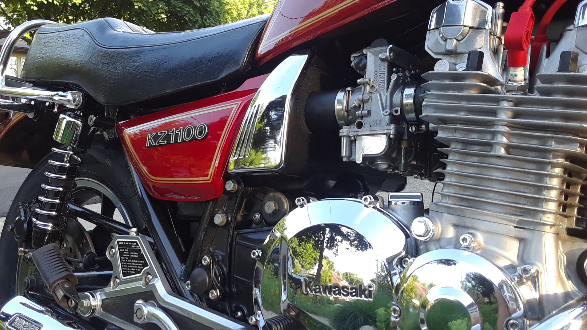

Five years ago...the air box was modified to accept Mikuni velocity stacks, while maintaining it's original design purposes for the most part.
Stock air box width was increased 1.5"

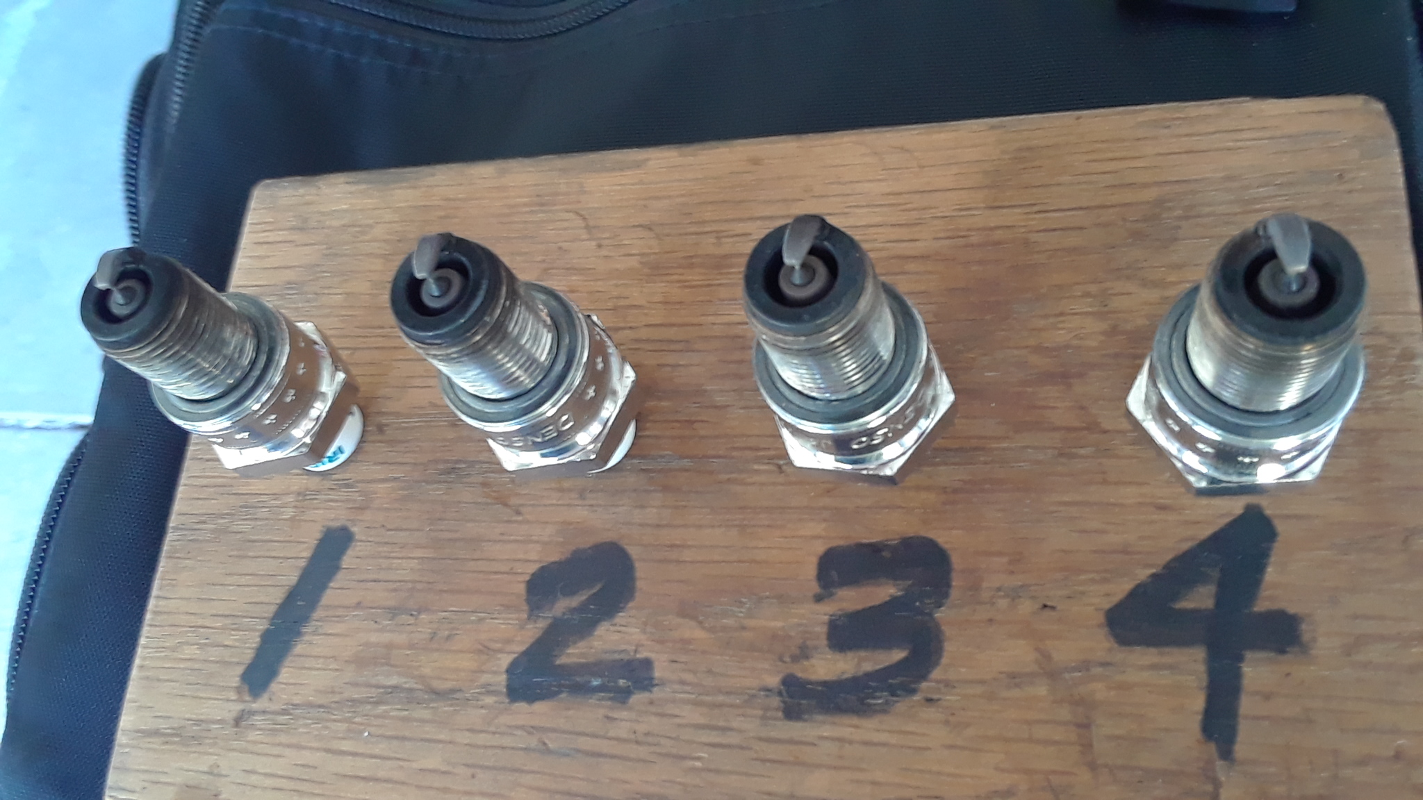

13 Jul 2022 15:52 - 13 Jul 2022 21:14Here's a shot of the plugs after 100+ miles. Purrs at idle, and runs like a champ with current jetting:
130 Mains
35 Pilots
1.1 Air Jets
Clip #2 Needle Slot
Fuel screws 1/8-1/4 Turn Out
1982 KZ1100-A2
