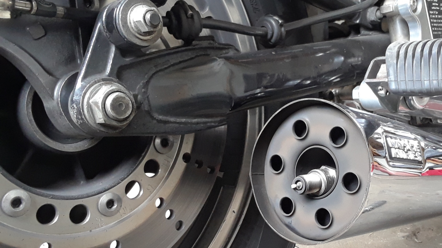

I wonder if the baffle exhaust coloration is a good indicator of carb jetting, and spark
plug condition.
plug condition.

That'll work as long as it don't back fire and suck it back in.
You might want to think about a tie strap to stop that happening and you may experience slightly retarded ignition.
