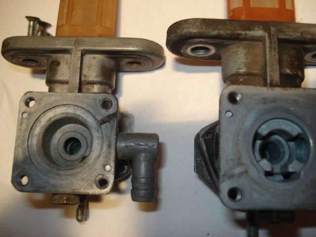

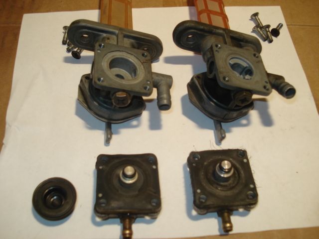

Hello, on my '78 KZ650 the petcock started leaking so i ordered a rebuild kit for it and once taking it apart the diaphragm part that was original to the bike does not match what came in the rebuild kit. I have checked rebuild kits at a few different sites and they all have the same replacement diaphragm but it does not match and i can't get the new part to fit. Does anyone have any insight into this? I have attached some pictures, the first pic is the new replacement diaphragm and the last 3 are the original part and i can't find anything like this.

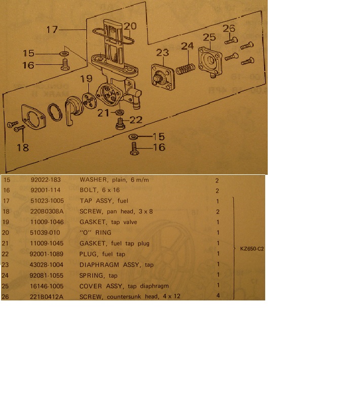

In the past there was a long topic on the kz650.info site about this topic. Here are the part numbers I could find for the vacuum petcocks that came stock on the 650s from the earliest to the latest.

To the best of my knowledge the first one listed does not have the "top hat" looking part. I have attached parts list for it (1005)

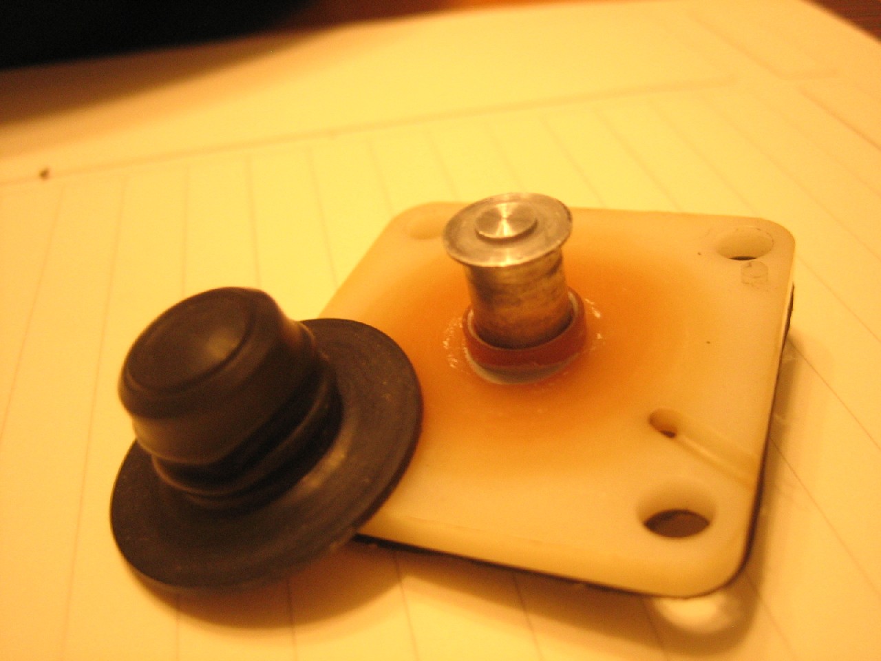

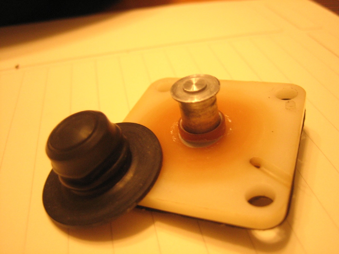

I ;have also attached some pics showing the difference between the petcocks without and making use of the top hat item.
It would appear that the kit with the hat has been NLA since like 1999.

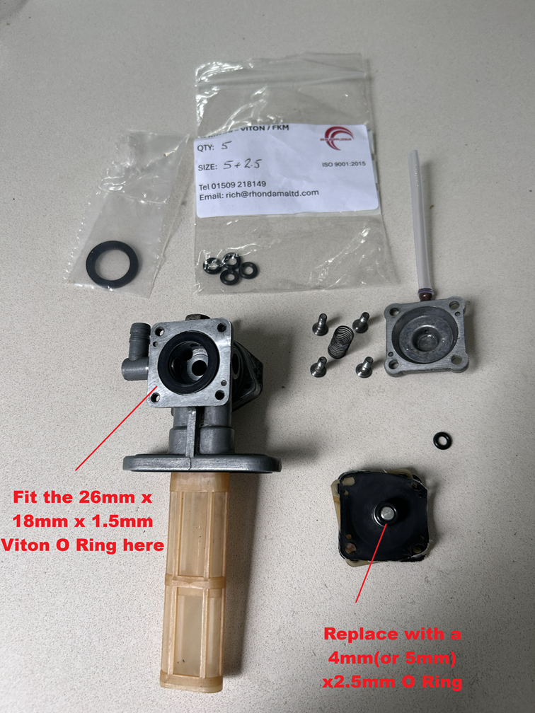

The top hat type petcocks can be rebuilt but require a couple of extra seals. The reason for them leaking is that the 'top hat' forms a seal for the diaphragm plate air vent. I found someone on eBay who makes viton seals and they made a 26mm x 18mm x 1.5mm washer. This sits in the recess of the petcock. You also need a larger thickness 'o ring' on the diaphragm seal. I had a 5mm ID x 2.5mm O ring hanging around and this made a perfect seal but a 4mm x may fit tighter on the shaft and be more appropriate. Hope this help anyone wanting to keep their existing petcock.
