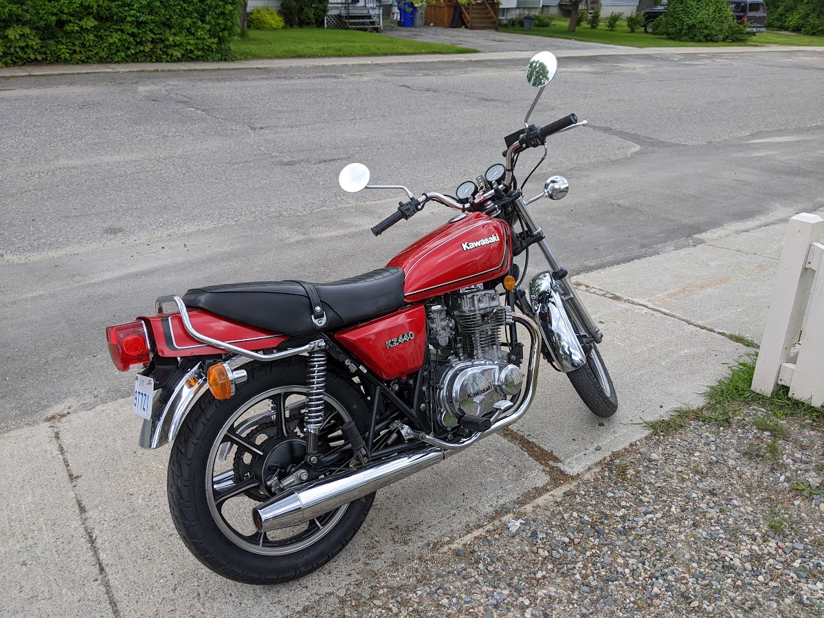

I'm all complete the restoration of my KZ440C. It looks great, runs great, has lots of power but just a couple issues.
When I go to shift gears, the RPM hangs up and stays reving for a couple seconds in between shifts. If I wait long enough or decelerate with the clutch engaged, the rev's come down ok. So the way it is now, the rev's stay up until I shift and release the clutch and then they are forced to come down. This is not the right.
I have very little experience with these carburators. (actually none)
The throttle slides snap back into place fast so I doubt it's that.
I am wondering if the diaphrams are too old and not responding quick enough? They seemed soft and supple when I rebuilt the carbs.
Any suggestions?
