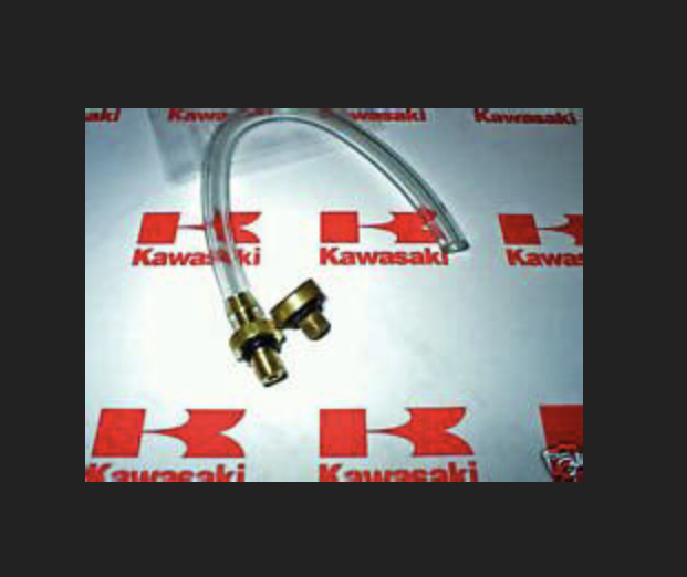

This?
if you loosen the drain screw and fuel starts to drain from the brass nipple on the bottom of the bowl then all you need is a piece of clear tube attached to the nipple. Then open the drain screw. The tube will fill and show you the float level

There’s no nipple, just a drain plug. That adapter you pictured seems like it’d work though

Nessism process will screw into the threaded hole of the drain plug. The brass adapter is cheap also. Under $20 if I remember.

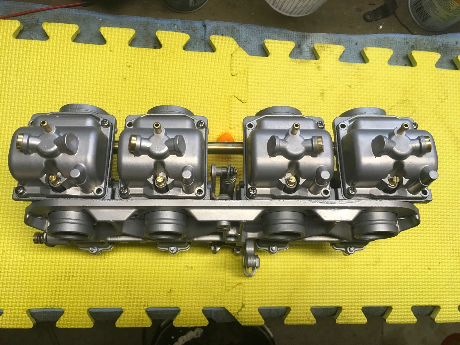

Wait, no nipple. That doesn’t sound right. Can you post a picture?

04 Jun 2022 10:36 - 04 Jun 2022 10:38Drain and overflow are not connected on vm24's. Drain is on the bowl lower side overflow is straight out the bottomWait, no nipple. That doesn’t sound right. Can you post a picture?
