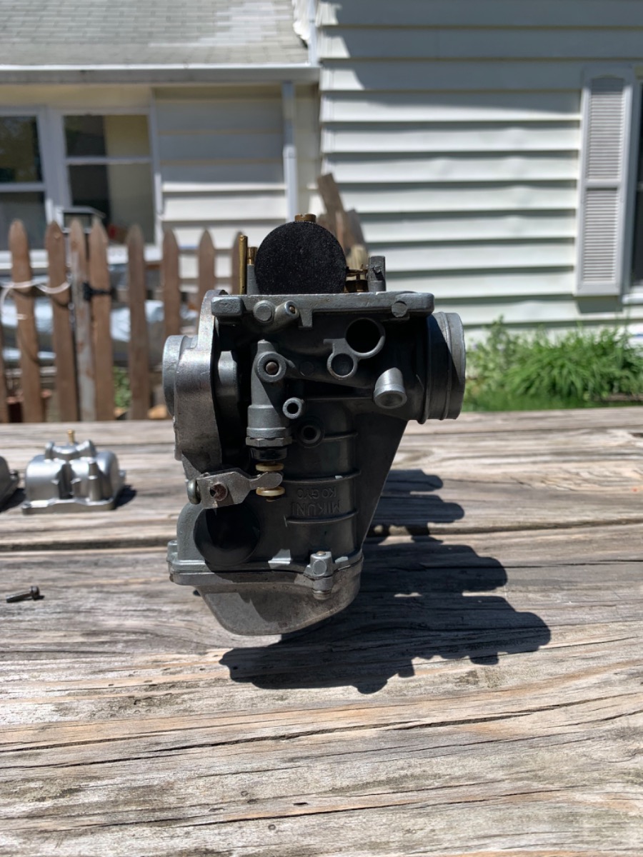

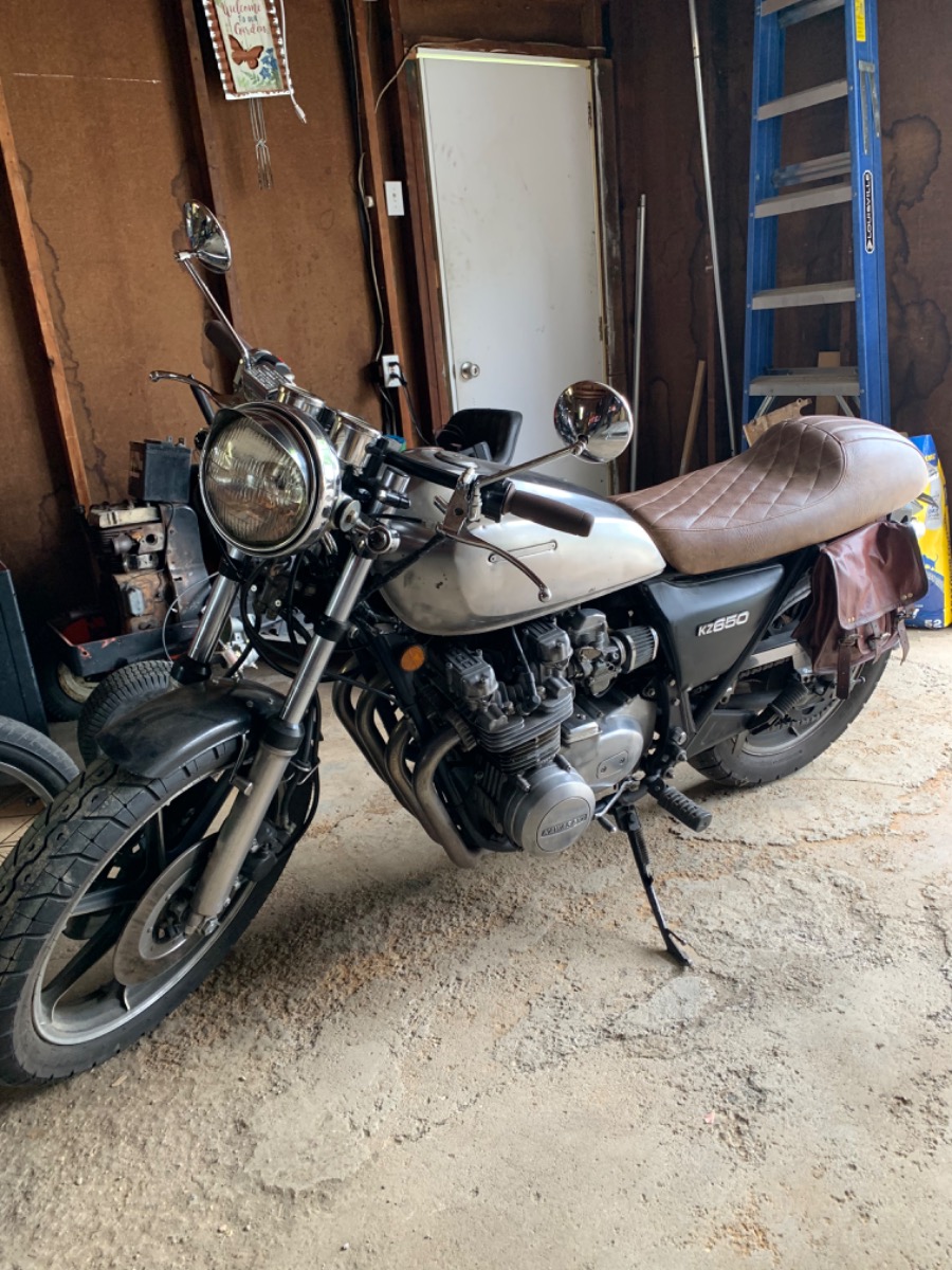

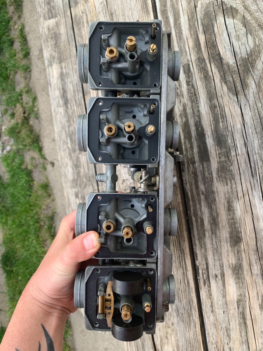

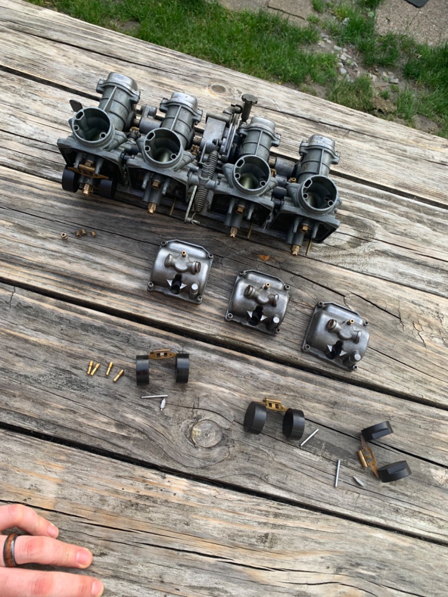

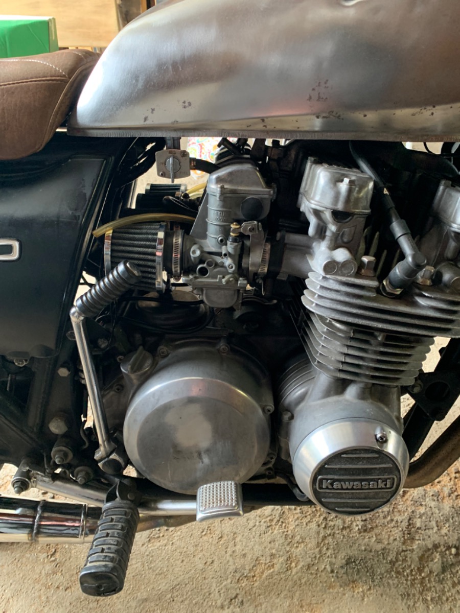

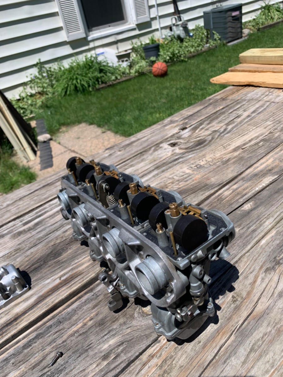

I have 4 miKuni kogyo carbs and cleaned them as well as the pilot and main. It does have 4 aftermarket pods. I noticed it revs really high with choke on and then dies when choke is off. Also, when I pull the throttle it sputters and wants to die. Petcock is on as well. What should I do?

What condition are the carb mounts? Air cleaner on? Pods or stock air cleaner?

When using pods, you have to rejet the carbs. I'm not an expert, but moving up 3 sizes on the main, lifting the needle a couple of notches, and opening up the pilot fuel screws to 2.25 turns open from lightly seated, will help.
- Posts: 4836
- Thanks: 1851
Re: 1978 Kawasaki kz650
04 Jun 2022 09:26
You can pm zed1015, he sell air corrector Jets for vm carbs with pod filters. Once installed you stay with stock pilot jet and needle position. You only need to tune main, which still might involve moving the needle but they give you a great baseline to start off.
