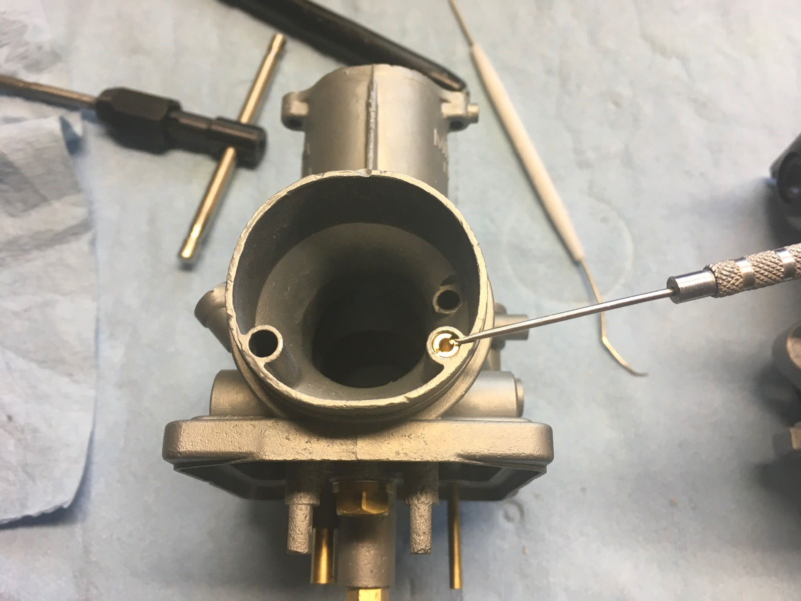

There was a guy a year or two ago who produced a mod to the inlet holes of my carbs that you would tap with threads and install in order to be able to fully tune after converting to pod filters. Anyone know what I’m referring to? Or am I losing it?

Is this a reference to Zed1015's air corrector mod ?
- zed1015
- Posts: 3172
- Thanks: 1791
Re: Carb mod once posted on here
18 May 2022 00:41 - 18 May 2022 04:49Yes! That's me and i'm still here.There was a guy a year or two ago who produced a mod to the inlet holes of my carbs that you would tap with threads and install in order to be able to fully tune after converting to pod filters. Anyone know what I’m referring to? Or am I losing it?
Air corrector jets ( Main air jet conversion ).
Eliminates the off idle hesitation and bogging when fitting pods or running open carbs.
Just fit in the needle jet air bleeds and increase the main jet size to suit.
NO other mods needed and leave ALL other carbs settings, needle height , pilot jets size etc stock..
Original thread is here ---
Air corrector jets for Mikuni VM 24, 26 and 28mm round slide Mikunis. - KZRider Forum - KZRider, KZ, Z1 & Z Motorcycle Enthusiast's Forum
