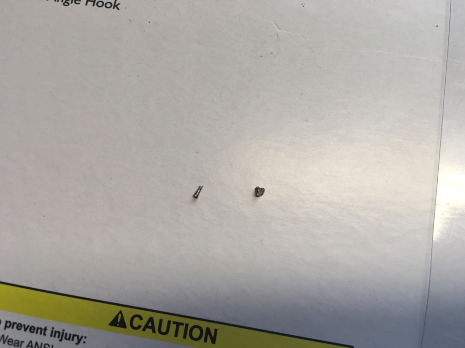

10 May 2022 18:41Yes, Ed save my butt in that regard. I twisted off two tips because I couldn’t feel the bottom because the threads were boogered. He talked off the ledge with a repair procedure to remove the tips.Just make sure the pilot screw port is open. As you know some of these screws have been broken in the past and left points behind.

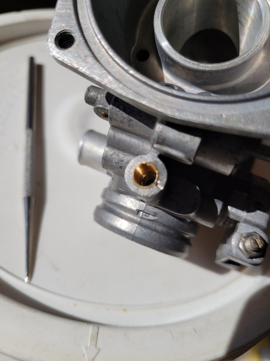

I've fixed buggered threads before on CV carbs, but the idea is the same as VM's. This photo is of an older set, but I did a set just this last weekend too. I'm (sadly) getting pretty good at it.

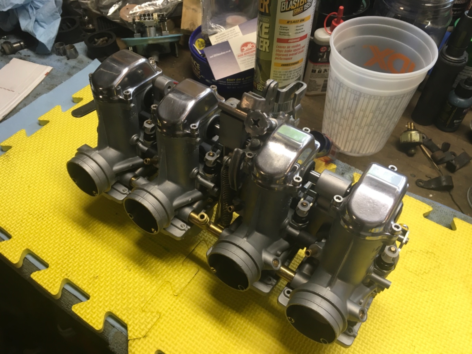

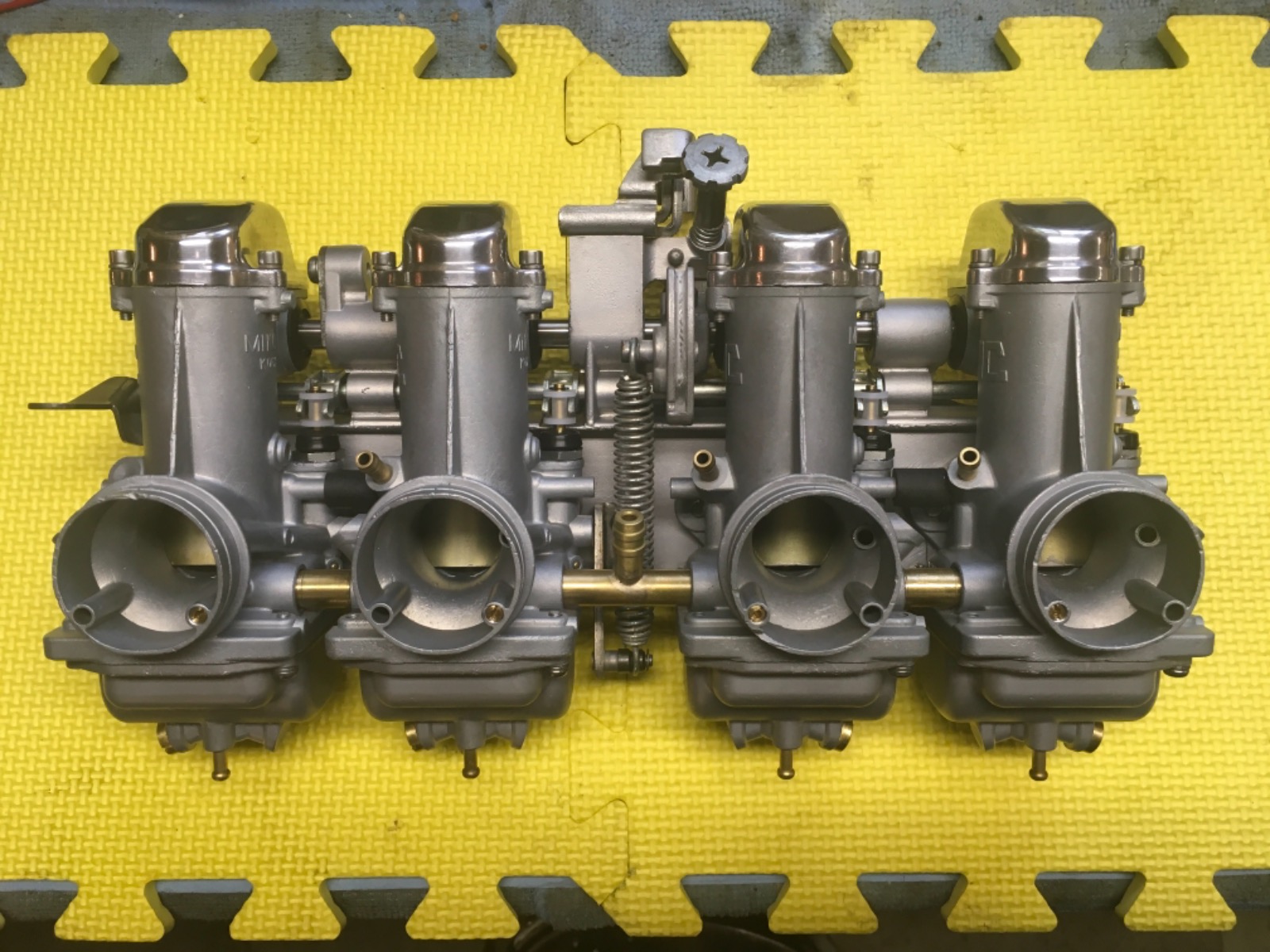

Seeing how this post was about these carbs I figured I’d post the 95% finished product here. Needs top and bowl gaskets, bench sync, fuel levels set clear tube and one last go through to make sure everything is tight.
Thank you to Nessism for talking me off the ledge over broken fuel pilot tips, and helping with the fuel transfer tubes.
A thank you also to Zed1015 for rebuilding the choke plunger seals and supplying the air corrector Jets.
These are going to Wheelhop for thanks for his Most Excellent Adventure and tossing my parts in with his. Thank you Jim!.
