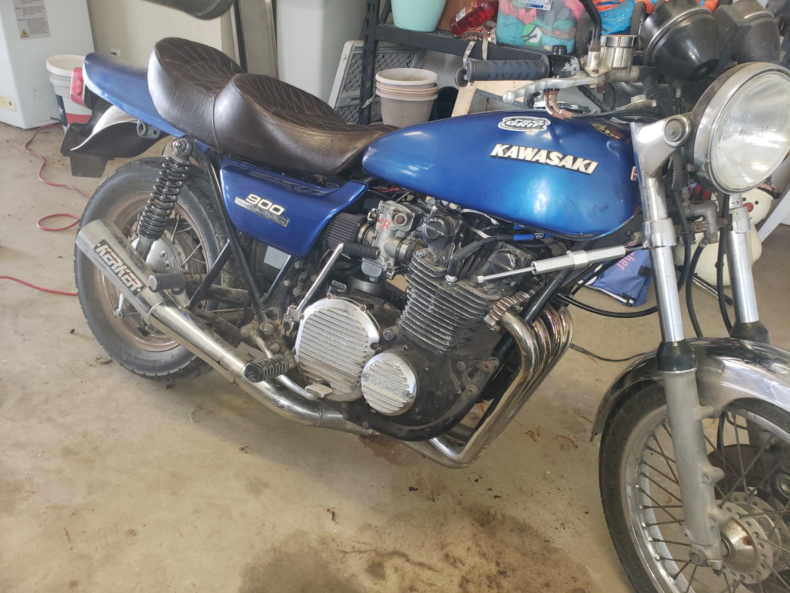

What seems to be the size of jets folks are running on bigger carbs? The only thing I have noticed is some times when rolling onto the throttle in 3rd it will surge a little. Plugs look dang near perfect but I think It may be a tad lean. Fixing to install a innovate AFR guage and see where we are at.

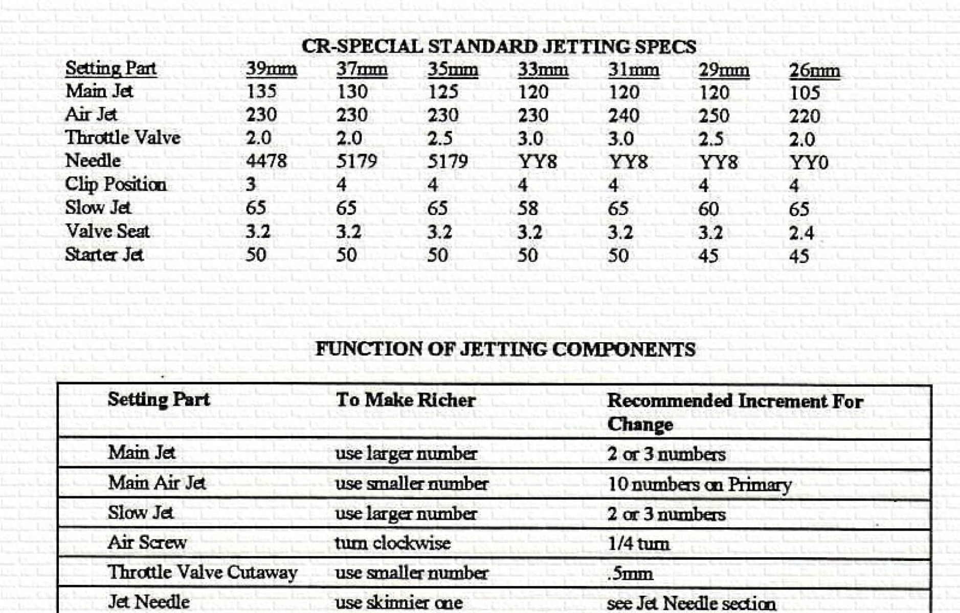

Try to set the jet needles one or two clip position higher before struggling around with main jets.
www.servicemotopieces.com/telechargement/Keihin-CR-manual.pdf

Do you know what the specs for the engine are? What's the displacement? Compression ratio? Cams? CR35 are pretty large for a KZ1000.
