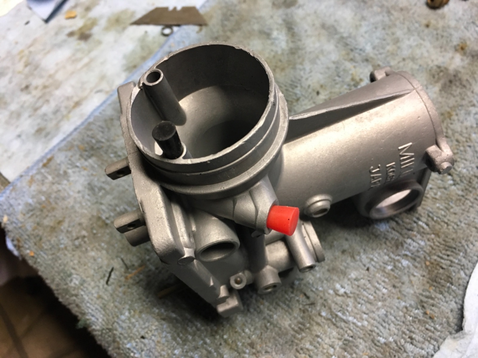

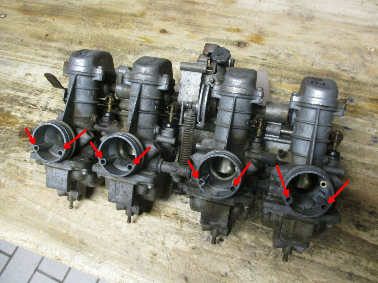

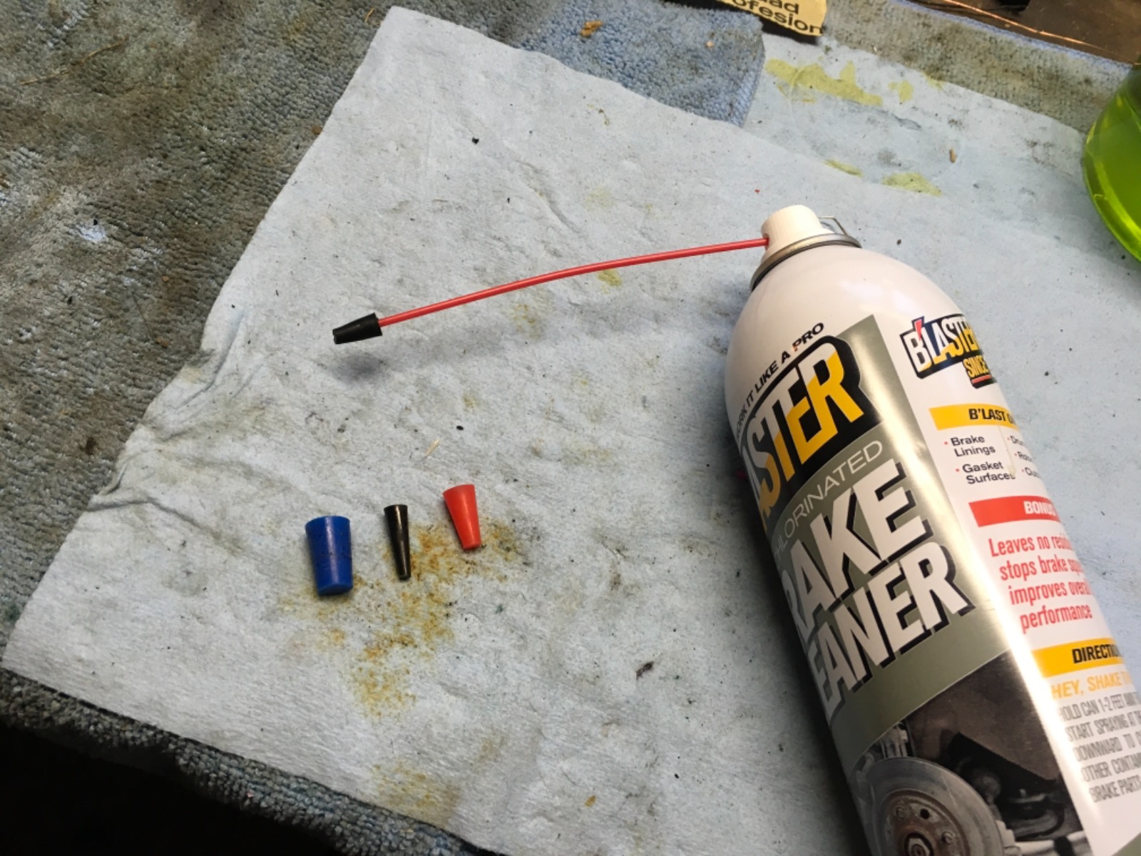

When it comes to passages within the carb body. Just blowing air through doesn’t mean all passages are clear. You will need to track every passage and block all exits on that passage. Use carb or brake clean, shoot it through a passage at its longes run. Blocking all exits between the start and the end. Then plug the end (furthest) and open the next furthest to the start of that passage. Working your way back till you shooting cleaner in at the exit and it is now coming out at the beginning. It’s the only way to know 100% all are clear. It’s time consuming but the only procedure that works. I use tapered cones for blocking off threads and holes when powder coating. I have different sizes gun drilled so the cleaner straw can be placed inside the cone and then fit into the carb passage. Just another way to ensure your getting your carbs clean.
