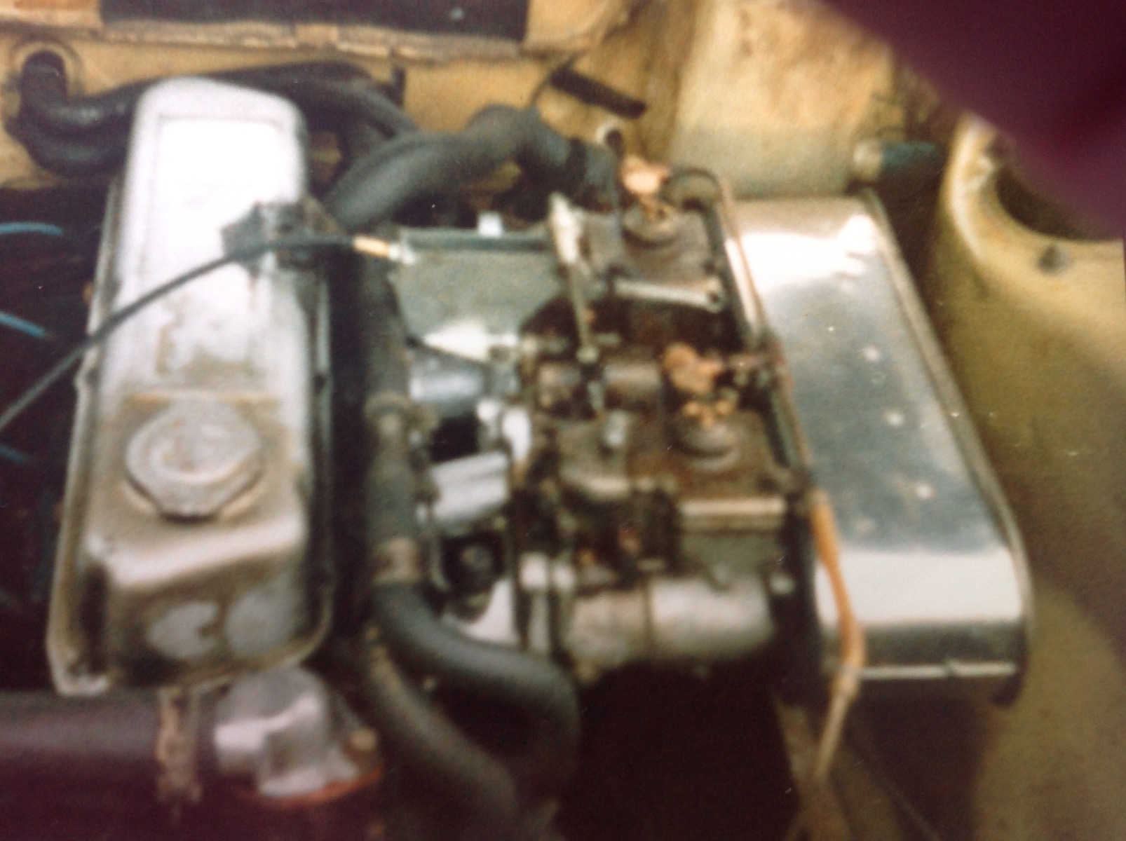

Not sure why you would consider this unless you want to puddle around with 60hp, poor throttle response and a rev ceiling of 7000rpm ( would get good gas mileage though). It has been widely recognised for the last sixty years that equal length intakes are at least as important as equal length header pipes to optimise performance from a naturally aspirated engine ( only achievable with individual carbs/ throttle bodies)
The list of disadvantages to a single or dual carb set up is immense but safe to say there is a reason why every tuner goes in the opposite direction.
As everybody likes pictures I have included a couple of my old "Avenger" from the late seventies (one Venturi per cylinder)
I know to our American friends a 1.6 is a motor for a " weed wacker" but you guys don't pay our gas prices

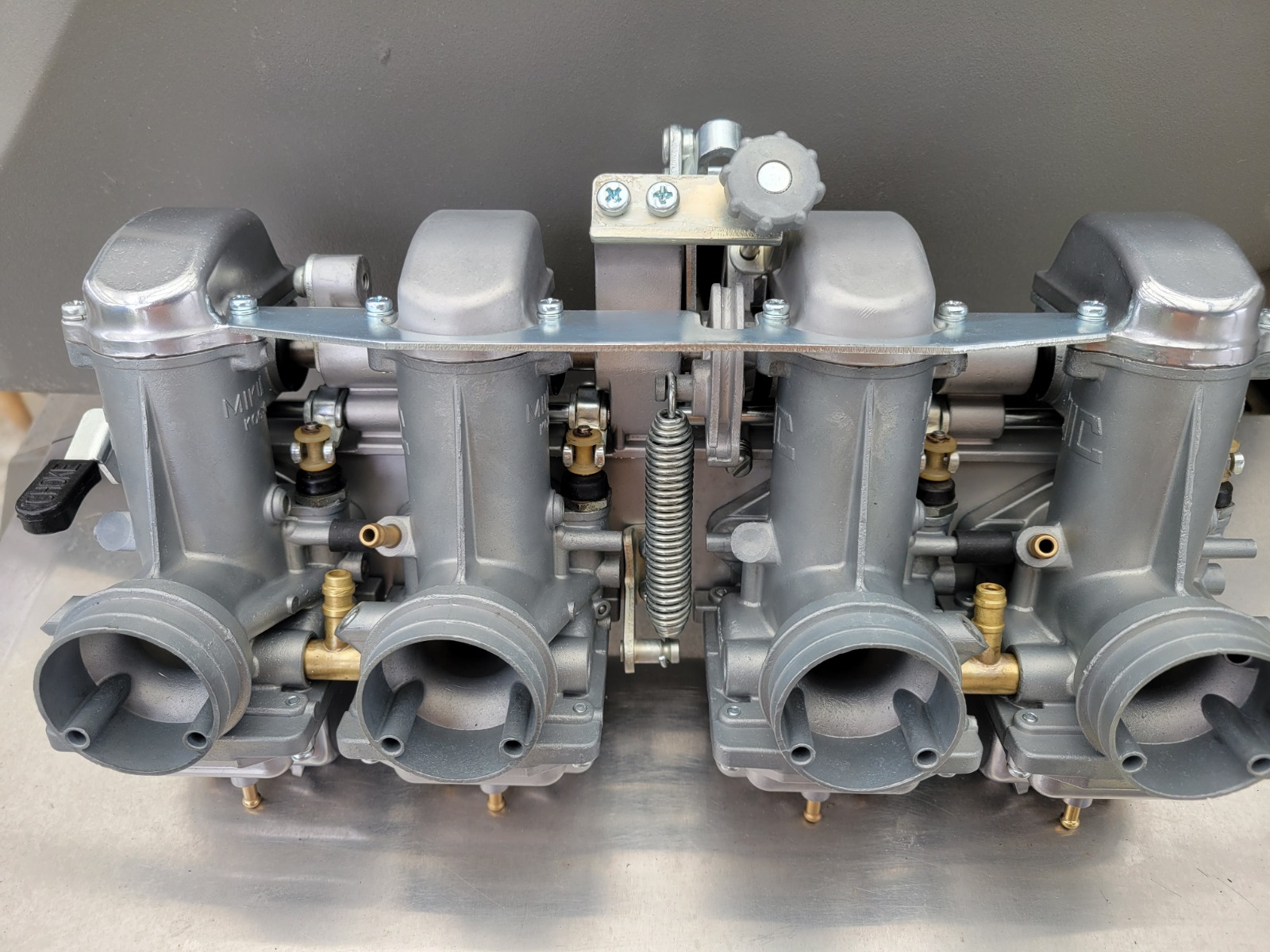

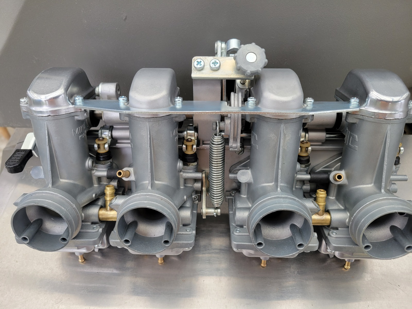

Check out Murrays Carbs / murrayscarbs.com I seen this carburetor set up ( custom intake with 2) VM36 Mikunis) on a 81/82 CB750 Custom at a local bike shop. I did not ride it or hear it run. But it did peak my interest..

05 Apr 2022 19:45 - 05 Apr 2022 19:48$700 dollars later, and you could have bought a righteous set of VM or RS carbs. Why?

Re: Kawasaki KZ900 Custom Intake
05 Apr 2022 19:50
Because some people want to spend more money for less performance...!

07 Apr 2022 18:35Super nice!!!
