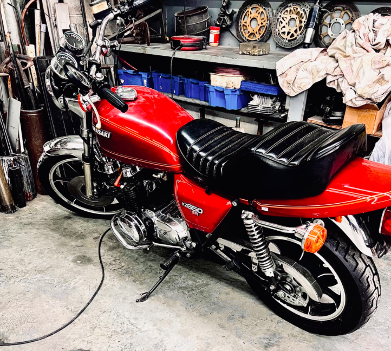

Can I put 26mm Mikuni’s on this Bike? I bought the bike without carbs. Will the stock manifolds accommodate these 26mm’s????
It’s got a 4into1 Kerker & I’ve got K&N Pods to use.
thanks!!!

Yes, you can use VM26's, but VM24's would likely provide better running. VM26's were used on 1000cc bikes, not 650's.
VM24's are MUCH cheaper to purchase, too. And Wired George will charge you a lot of money, and you won't know what you are getting. I've had guys send me their carbs that WG "rebuilt" previously, and they were all messed up. You have been warned...

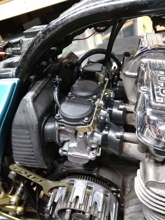

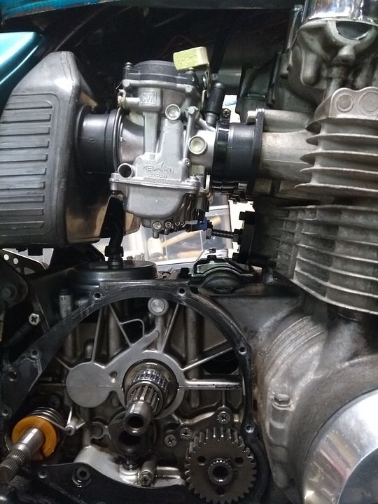

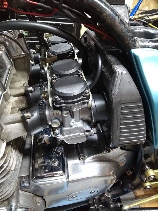

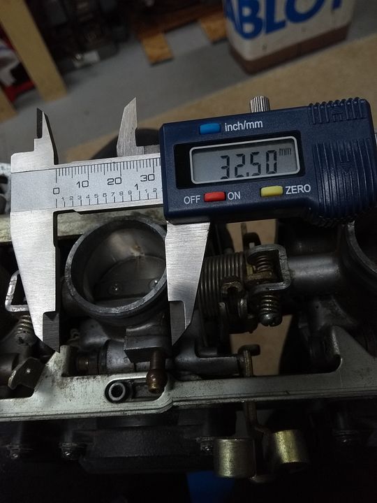

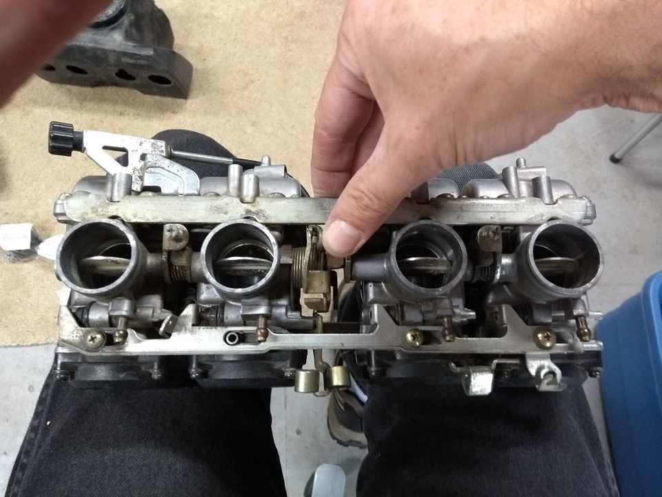

Welcome.
Nice looking 650!
KeiHin CVK32 carbs off an early Ninja 600, and the ZR7/S can work too.
Work well on a kz650.
ZR7 stock manifolds and air box boots will be needed.
CV carbs don't work well with pod air filters though.
Nice looking 650!
