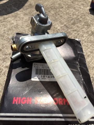

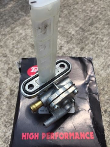

Tour Master brand is vacuum operated and 44mm spacing, "Made in Japan" - That is the key, make sure you can buy a rebuild kit for it.

Sorry, its "Tour Max", I believe you can purchase thru most dealers, Z1 ent also sold them as a Suzuki replacement. You can also find them on Ebay as NOS like I did.

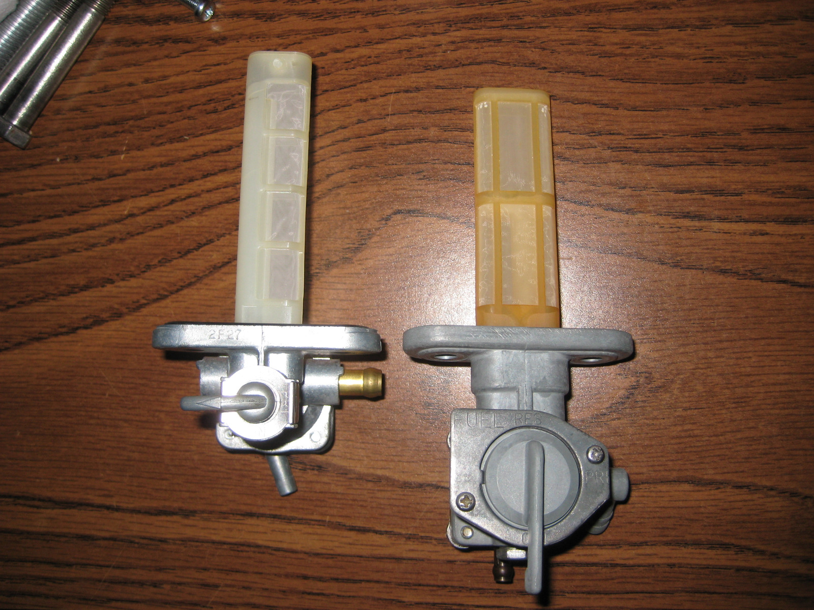

I just got an aftermrket manual petcock delivered to my mailbox for less than $15 for my '82 KZ750ltd. 34mm spacing. I prefer manual PC due to I want flow when I turn it on and not depend on a vacuum signal and I can turn it off at the end of the ride. ebay was my friend.

When you receive it make sure you open it up to clean out any excess casting flash. I ordered an "upgraded quality" manual petcock from a seller on eBay, for cheap. It had a nice big brass 9(?)mm outlet that I was looking for. When I received it it seemed half the weight of the factory petcock so I opened it up and was stunned to see O-rings made from I don't know what, once stretched they didn't want to go back to their original shape, like taffy, and tiny internal fuel passages and was so cheesey in construction that I could see it leaking the instant gasoline touched it. I immediately threw it in the trash and ordered a rebuild kit for my factory unit.
You pays your money and you take your chances.
Mine was made in China. Lesson learned for $23 bucks.

Thanks. I'm seeing K&L petcocks w the same part number on EB & they look pretty much the same. I've had good luck w K&L stuff. never had a problem.

06 Mar 2022 09:41 - 06 Mar 2022 09:51Yes, I believe K&L just rebrand them. The important thing is they have a rebuild kit listed for this model. I like it because its smaller than the Kawasaki unit so if your trying different carbs there is more room to work with.By Injected: Sorry, its "Tour Max", I believe you can purchase thru most dealers, Z1 ent also sold them as a Suzuki replacement. You can also find them on Ebay as NOS like I did.
