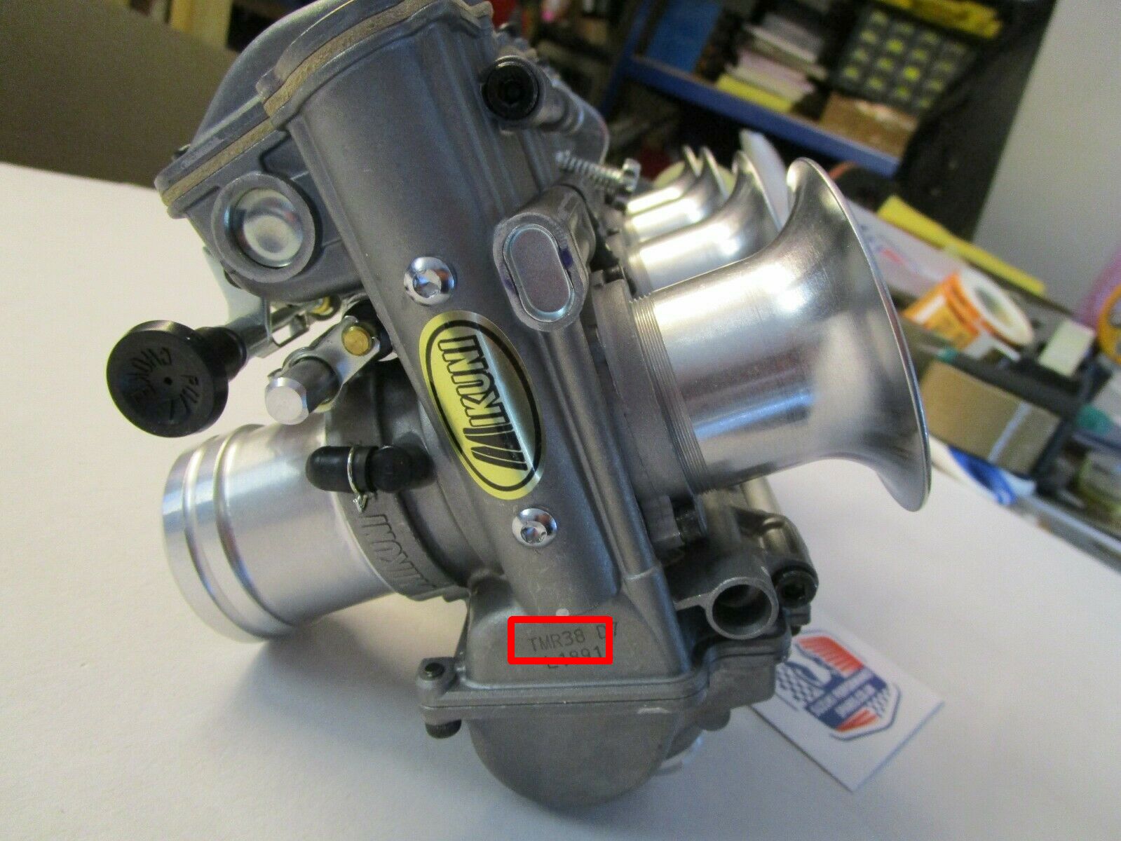

Anyone care to share opinions on these?
They sure look pretty...
Reference ebay item 274976018014

The picture shows a TMR38, would be a little oversize on your engine without any porting and cam selection done right.

32mm, 34mm, and 36mm sizes are available.  34 is NOT...go figure.
An alternative source:
www.classic-raceshop.com/mikuni-tmr-tdmr-carburetors
