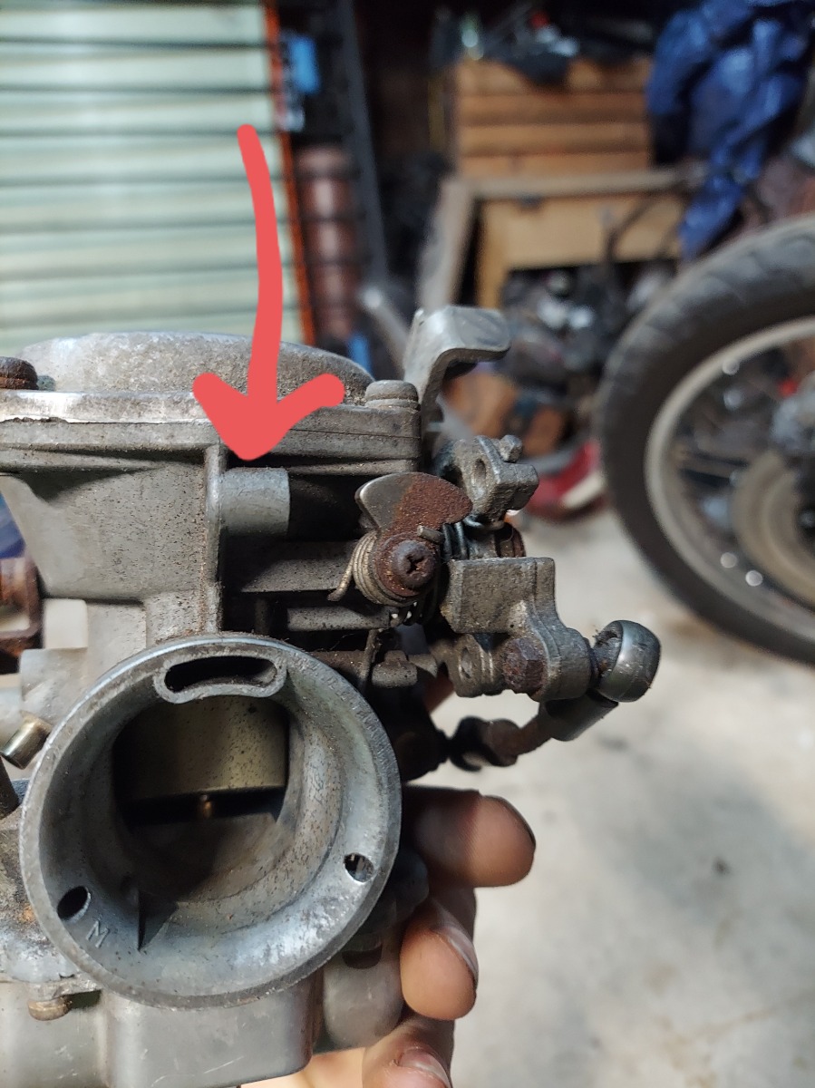

I'm talking about the idle speed screw, I will try to get pics of the situation in the morning

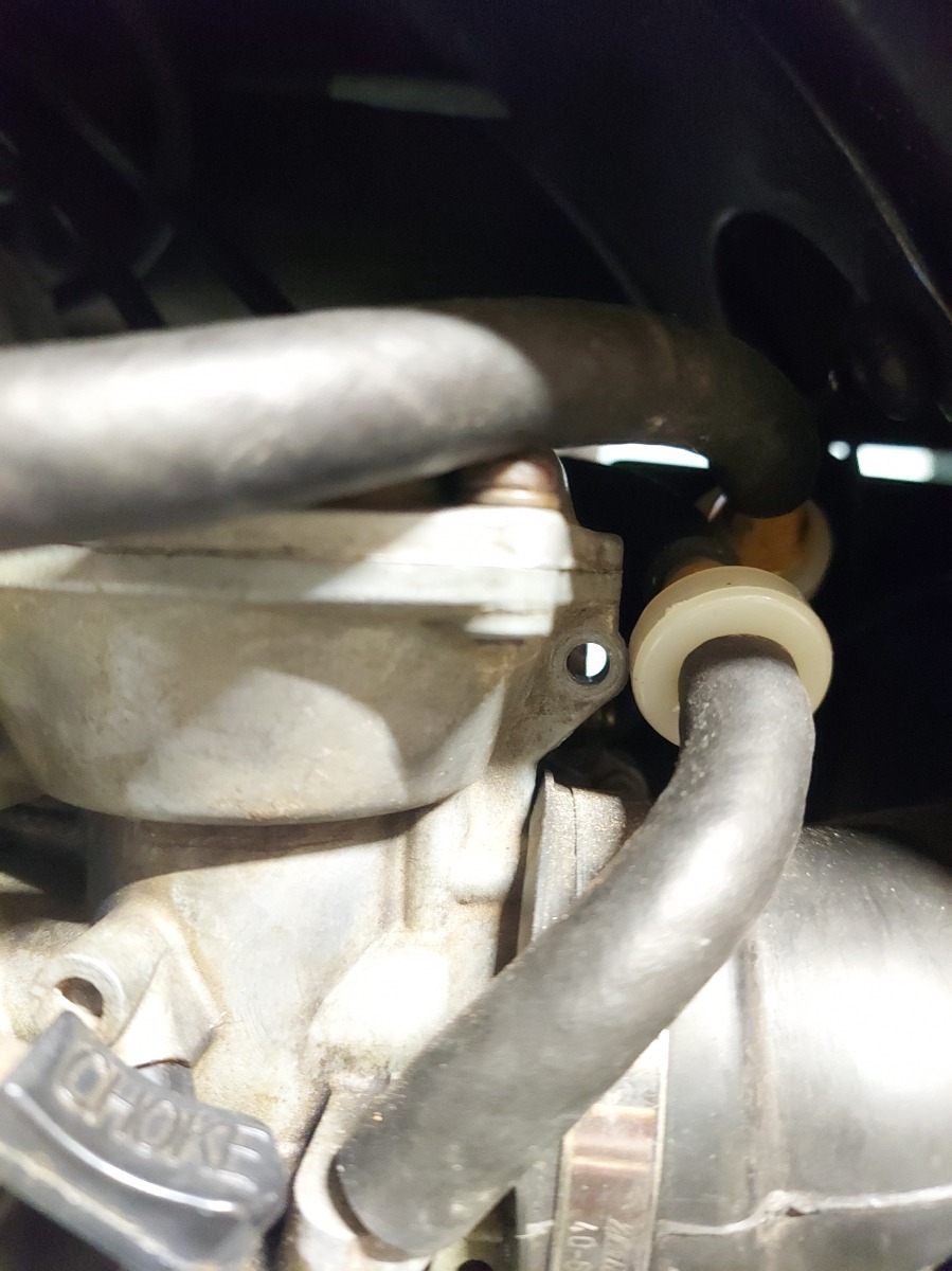

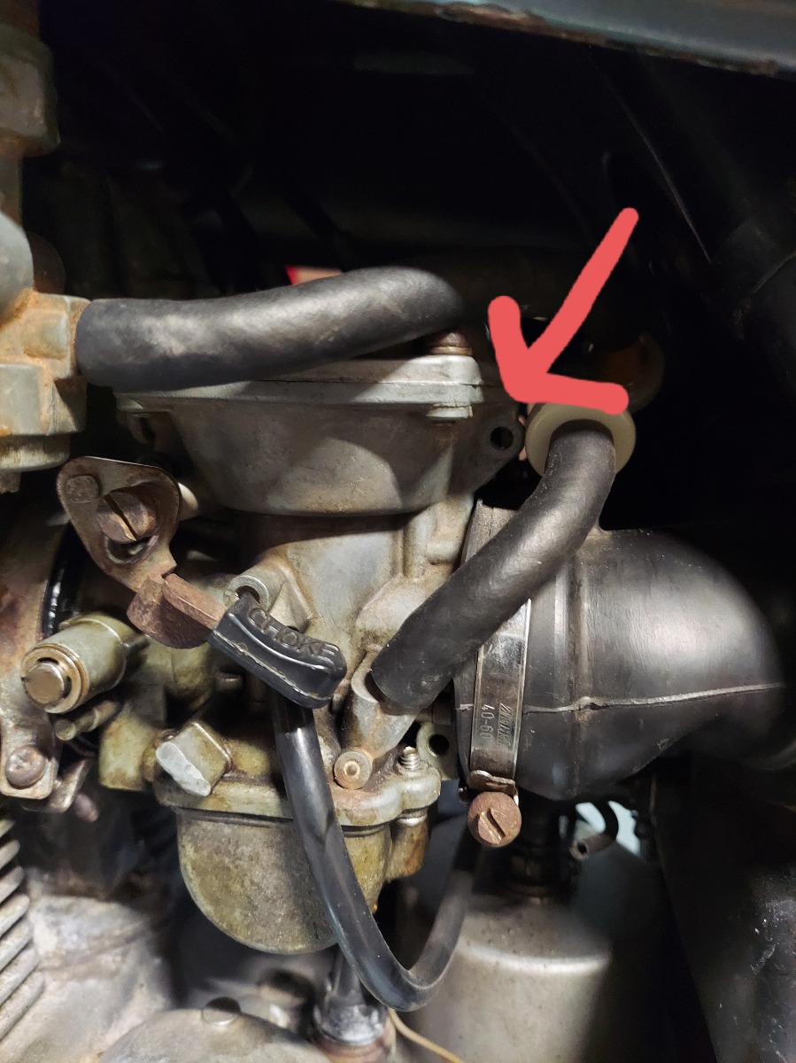

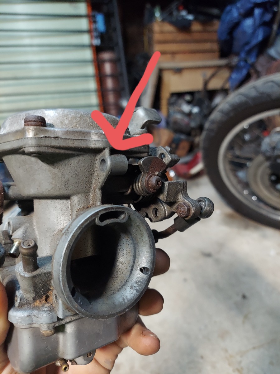

Here are some pictures of the problem I'm having. The first few are the carb on the bike, the last couple are a parts carb I have extra (cracked body of course) so I could shoe the part from multiple angles.
