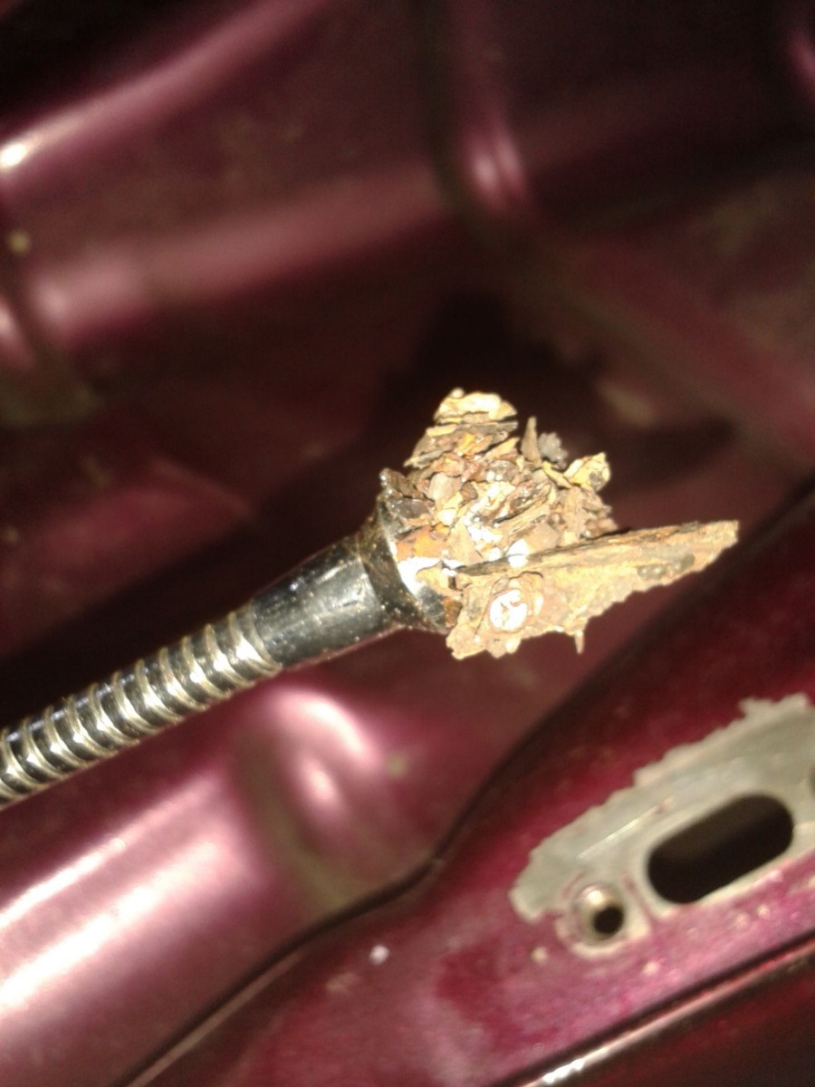

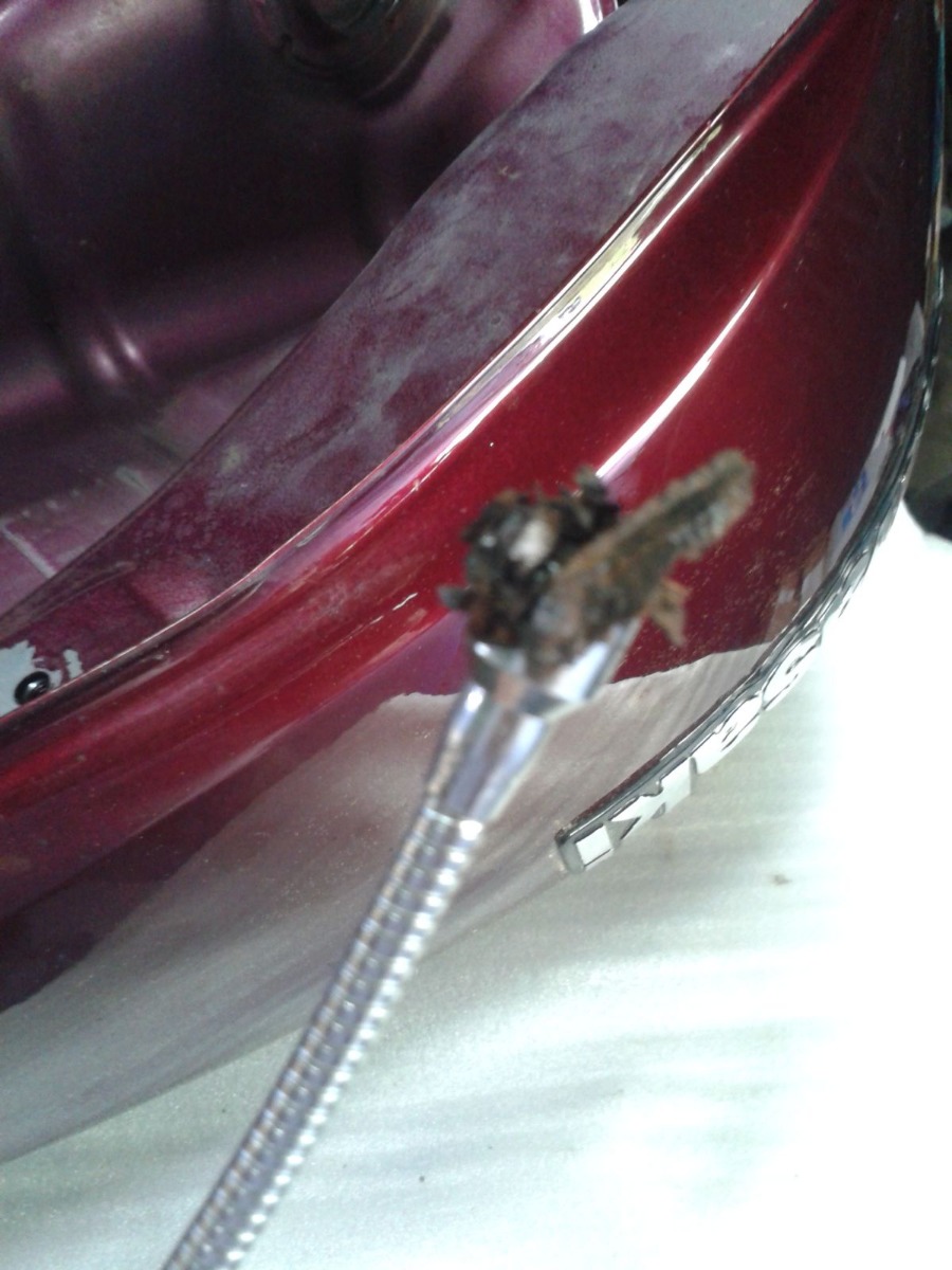

Had the same carb issue on a friends Euro Zephyr 750 after a carb and fuel tank (rust inside) rebuild. Those carbs are running very lean with modern E5/10 fuel. We had to setup the main jets size of#1-4 to 108 and #2-3 to 110 to solve the full throttle problem with stock air box.
