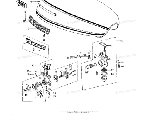

Your original Diaphragm is in pieces. And wow, your four-hole is wasted.
In the schematic you can see how it all goes back together. Partzilla is your friend here:
Also, do yourself a favor and peruse this tutorial on rebuilding petcocks . It's for a Yamaha but they are basically the same.

Thanks for your replies. That tutorial is wonderful. I'm going to try it; the parts look identical to the ones in my petcock, and it shows exactly how the spring goes on. If that doesn't work, I'll look into getting another petcock.
