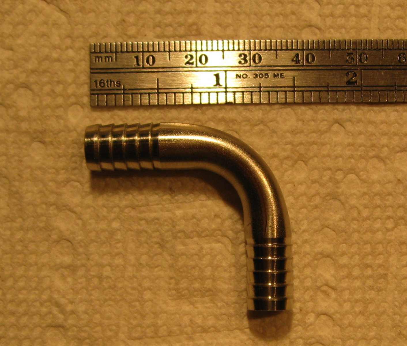

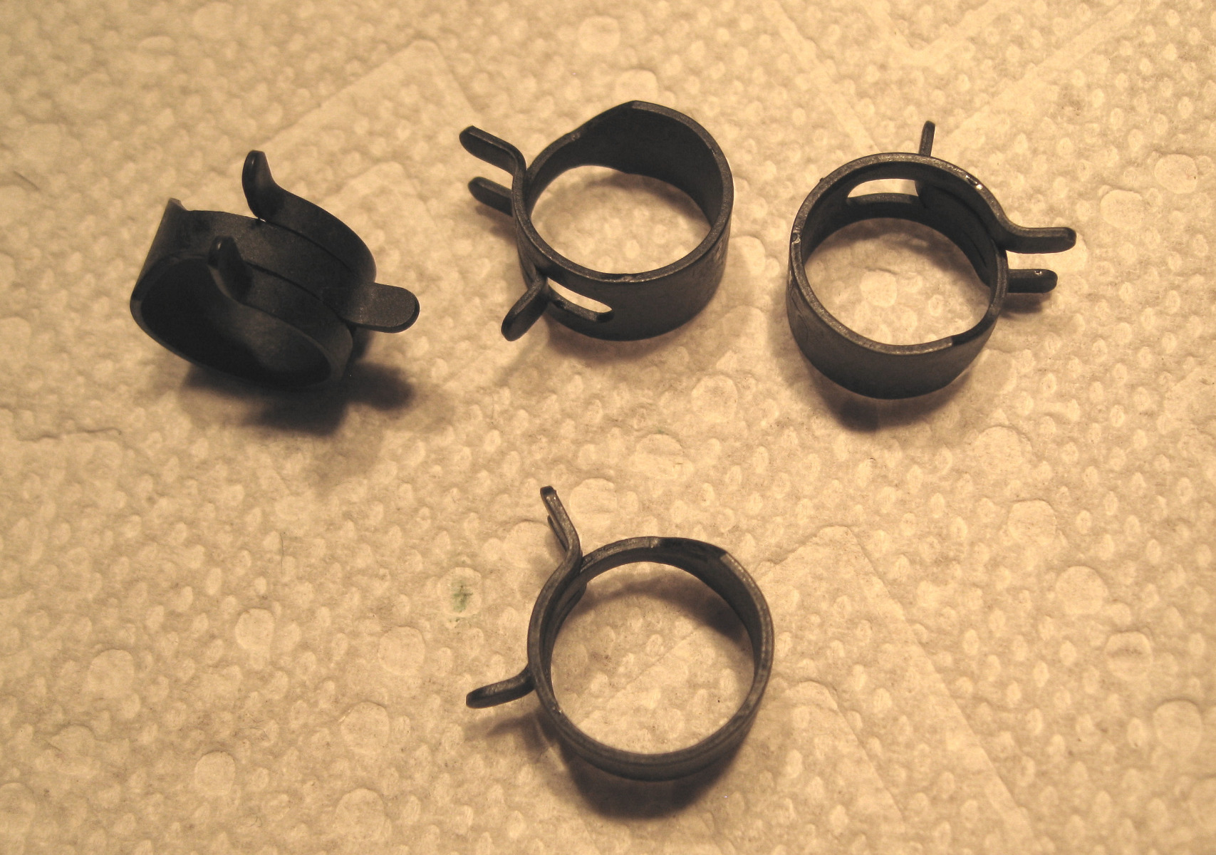

I've owned my 1977 KZ650C1 since it was new (45 years - eek). During that time I have tried several different fuel lines, filters, clamps, etc.. Here is what I have found to be the absolute best. A little expensive overall, but they will last forever. Ed
FUEL LINE (65123 - 5/16")
www.goodyearrubberproducts.com/2012pdfs/...wnloads/page0031.pdf
FUEL LINE CLAMPS (I found these at Willards Small Engines)
FUEL FILTER (The filter element is stainless steel and can easily be cleaned)
Golan Super Mini 5/16" SKU 1222522
golanproducts.com/product/super-mini-fue...r-5-16-barb-fitting/
STAINLESS STEEL ELBOW (I found this at a shop that sold propane components)

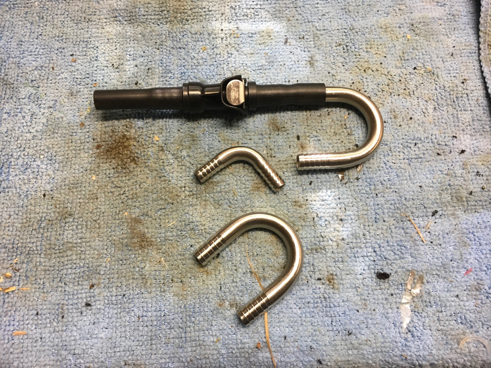

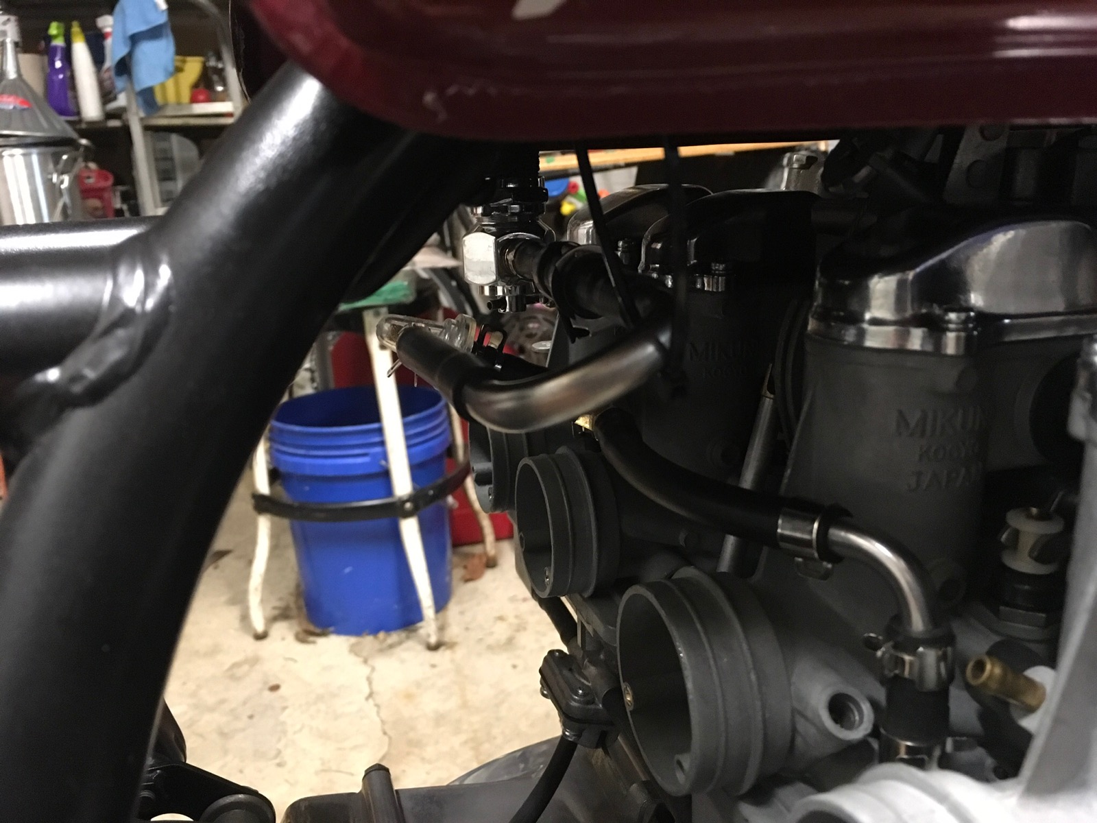

I took some cues from my elders… lol 650ed and Nessism… of course I mean in seniority, not age. Stainless beverage fittings from 650ed and fuel line from Nessism. You can get clamps sized by ID at Parts n more. Takes all the guess work out.

I like the way you used the elbows to route the hose
very clean !
thank you for the photo
very clean !

06 Feb 2022 15:08My version of 650ed’s idea.I like the way you used the elbows to route the hose
very clean !
