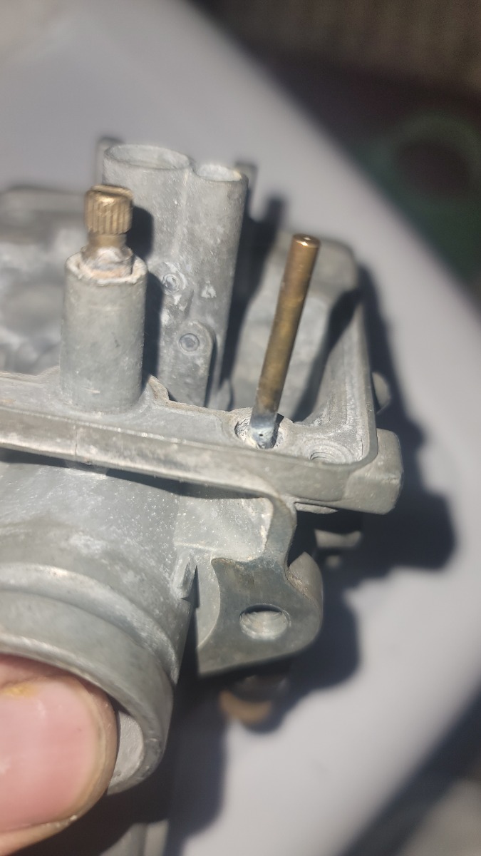

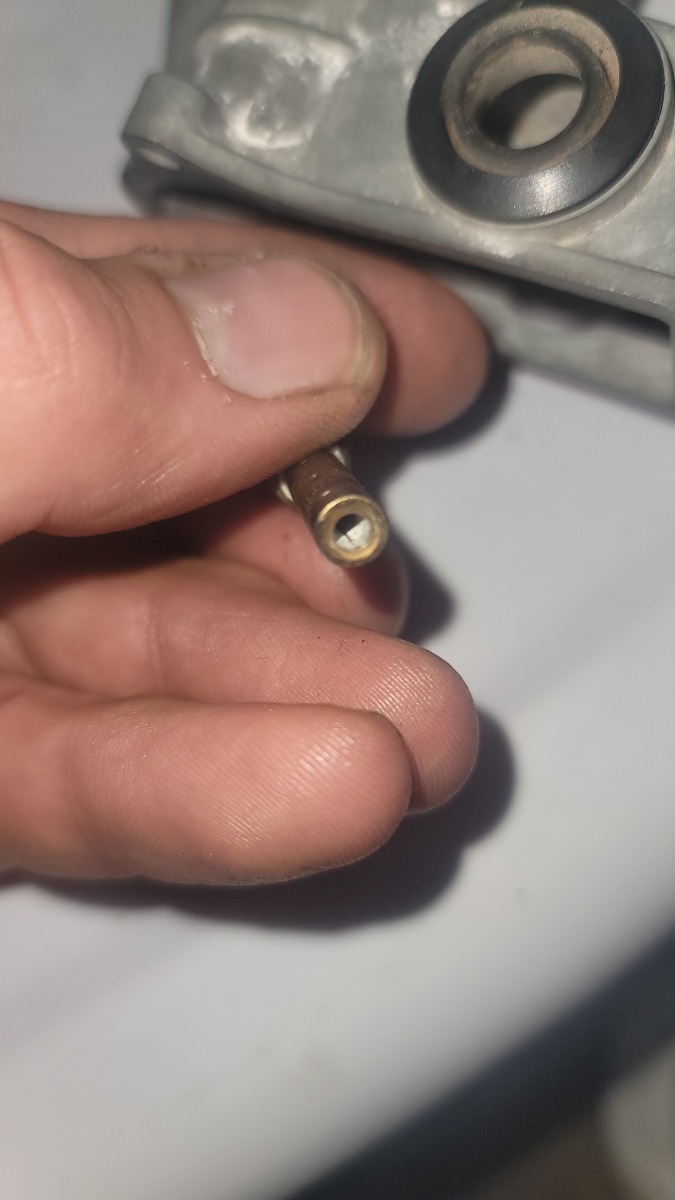

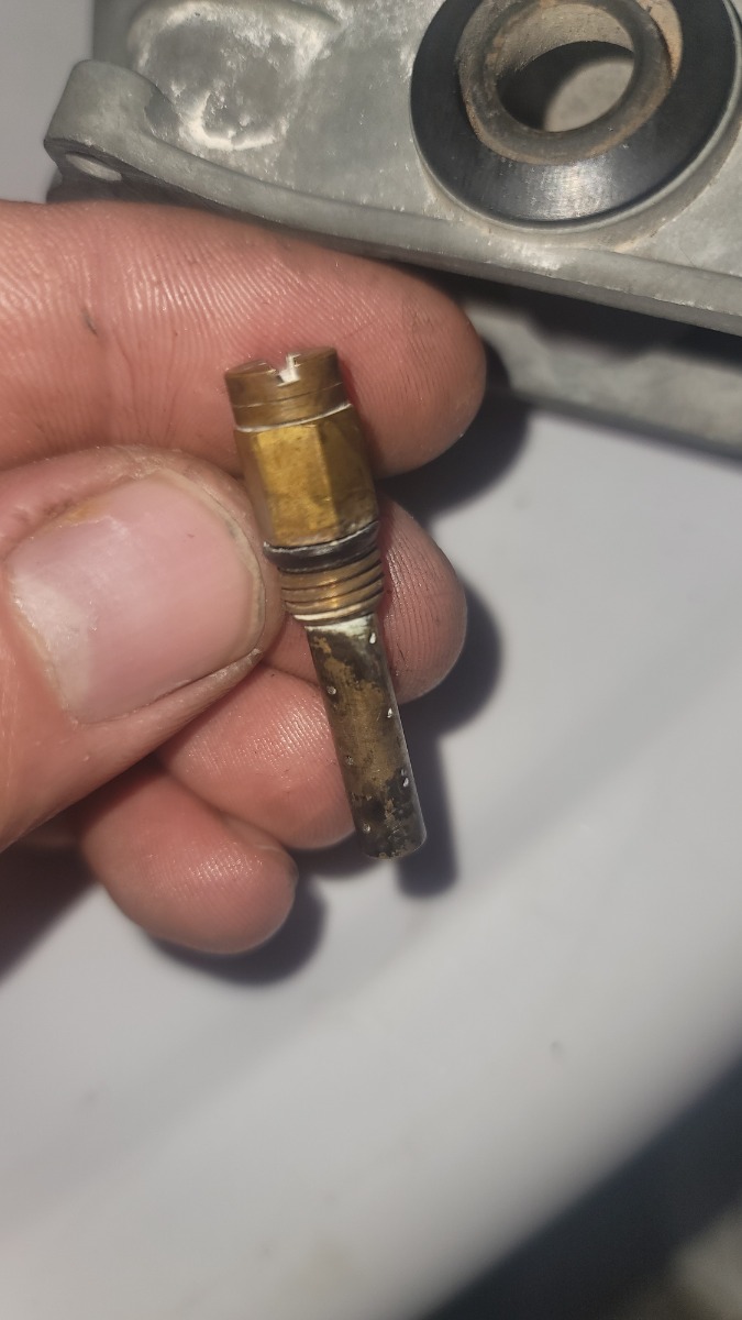

Hey guys another question, I figured I'd post it separately since it wasn't quite related to my other thread. I've been looking at tons of parts diagrams for different sets of carbs, and I cannot find what the parts pictured are called. As well, and most of the diagrams I see, the needle jet is three pieces, well four I guess if you count an o ring. So it is the actual main jet itself, and then the holder that screws into the place where the needle pokes out, and then on top of that they show another small piece that I guess they are calling just the needle jet. I've shown a picture of my needle Jets, I don't see how anything would screw onto it but I just wanted to make sure that I am not missing a part. Also, I'm having trouble finding the body of that needle jet, on ebay. Maybe I am calling it the wrong thing, is that just a needle jet holder or what would that be called? As well does anybody know where I can find this specific one?
the brass jet thing to right of mixture screw. I need two more of these, though, I haven't looked but it seems like they are the exact same on the VM 24s and two of them have them so I may be able to get them out and put them in the new carbs. I had the other two but I either damaged them getting them out, or I lost them.
It does not look like there was ever meant to be another part and I don't recall there being another part, and it looks as if the needle seats into it far enough to stop the flow, but I just wanted to double check. I also need one more of these. I'm finding lots of things that are similar but not exact.

The emulsifier (you are holding it in that last photo) screws into the center hole in the lower part of the carb and holds the jet needle in place. There are different emulsifiers for different carbs so you need the ones for your VM26 carbs.
The main jet screws into the bottom of the emulsifier. It should have a number on it on the bottom. Look at the lower photo.

In the first photo you are showing the pilot fuel adjuster. When the carbs are on the bike they are underneath and closest to the engine.
That long piece of brass thing in the first photo is for the choke circuit. It is not your needle jet.
If my other post is correct these carbs are off a '77 KZ1000. You can find diagrams on Partzilla. Here.
www.partzilla.com/catalog/kawasaki/motor...arts-77-78-a1-a2-a2a

The brass part in your hand is the emulsion tube, and the brass pipe in the carb body is part of the enrichment/choke these are not obtainable and are sweated in.
