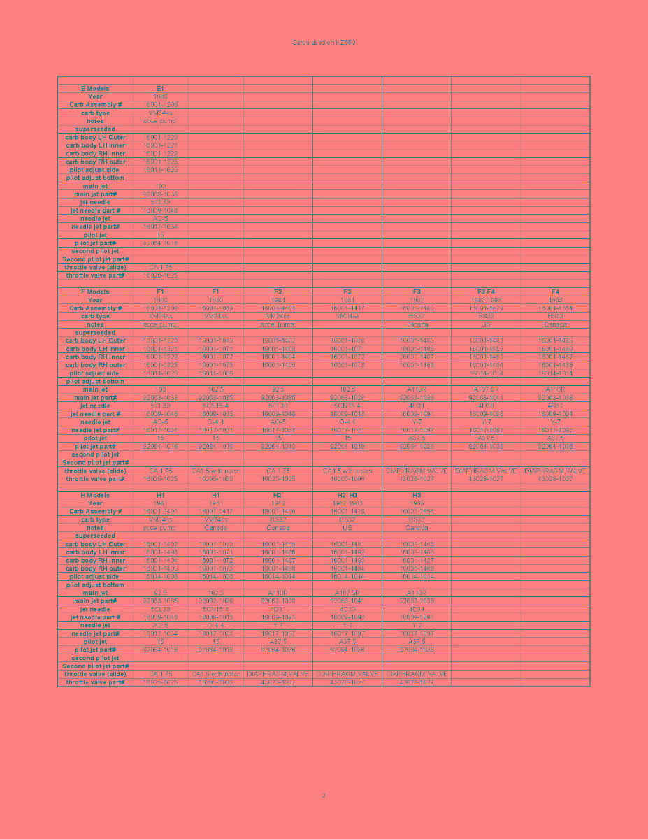

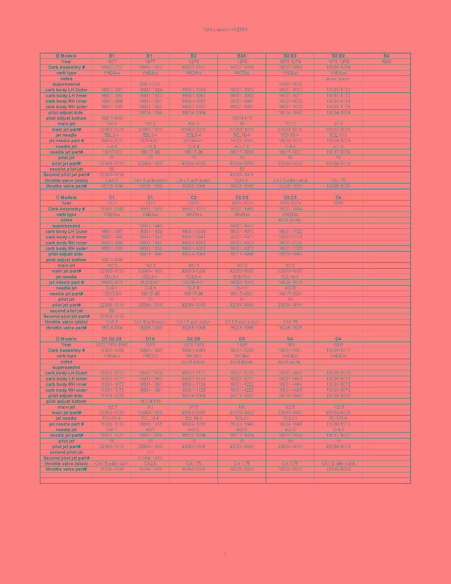

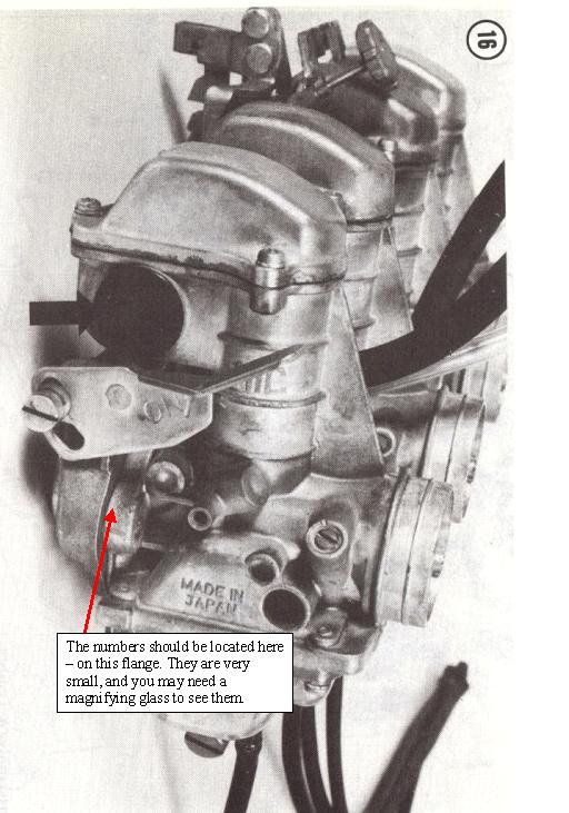

There are some differences depending on which models you are talking about.  Some have a pilot screw (sometimes called a fuel screw) and some have an air screw and some have both. Then there are the 78 models B2a and D1a that came stock with vm22ss carbs, which the other models came with vm24ss carbs. There are differences in things like the slide cutaway, size of main jet, needle jet and jet needle.  There should be an ID stamped just below the chock lever see attached pic.  I have also attached some tables with info I could find and make sense of which carb came on which model.

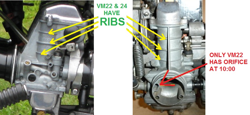

You'll get a few extra ponies from vm24's over 22's. Easy way to differentiate between the two is vm22's have an extra port at the 10 o'clock position in the inlet mouth.

VM24 carbs vs VM22 carbs.  Ed
