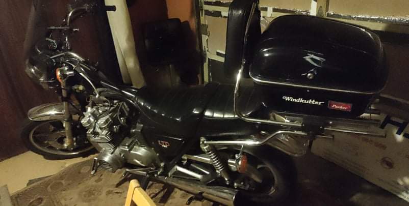

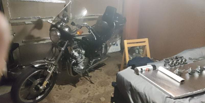

Thank you everyone for your time, and replies. Here's what I know for certain all lights work correctly, horn, back brake, clutch, and throttle all function properly as well. As I expected from a bike that has been sitting it needed new battery, new oil and filter, different gas, and new float bowl gaskets. I was lucky enough to find a replacement spring for my OEM master cylinder. The reservoir was really bad on it, is that salvageable? Right caliper piston is stuck and engaged, pads are fine. Left caliper appears to be in much better condition. I noticed it was leaking gas and checked the petcock, almost the entire gasket was shredded. Lucky I didn't blow up. What are the orange plugs that resemble thumbtacks in the float bowl next to the main and secondary jets? This is my first time OWNING a motorcycle. Have ridden since I was 6 years old. Never had the opportunity to work on them until not. Any tips or guidance is much appreciated. Thank you all!!

PLEASE click the insert all tab to complete your picture install so they will be full size .
I fixed them for you this time
Nice Project
