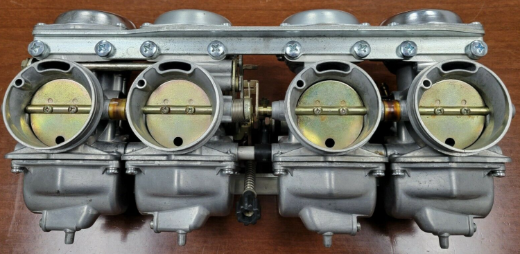

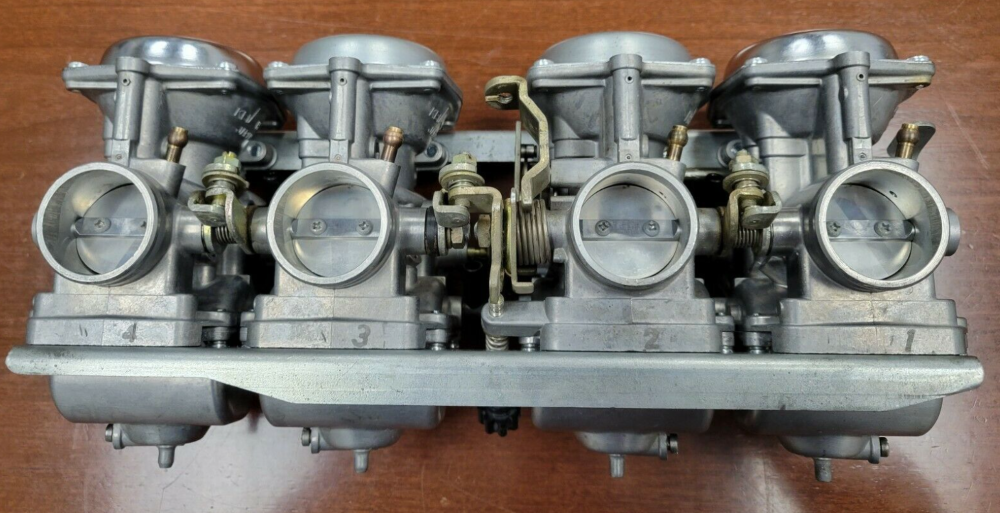

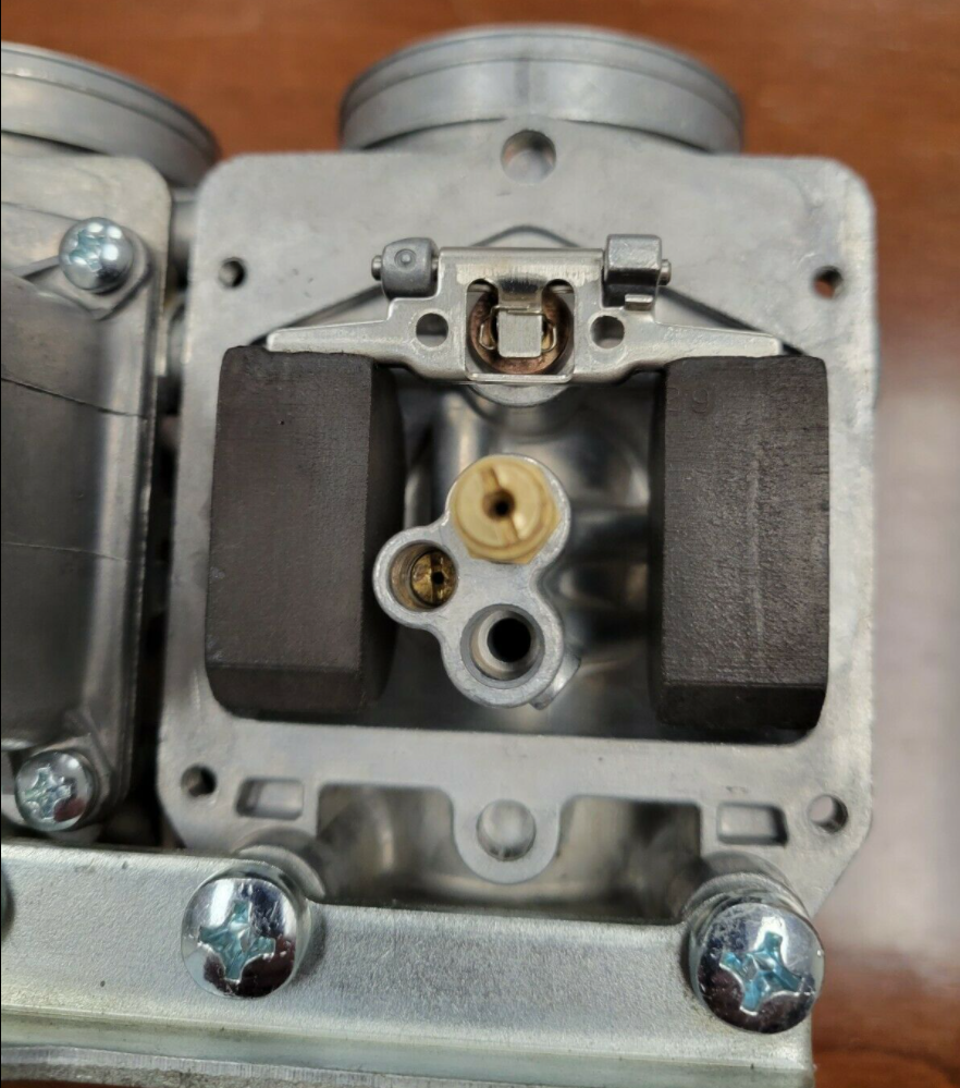

Finished the carbs. These carbs were much easier to restore than most other sets I've done. A really good clean job followed by replacing the soft parts like O-rings and float valve needles and they are ready to go.
The simplified jetting setup is going to be a plus too, I think. Just like a set of Mikuni CV carbs. Less prone to plug up.
Anyway, I've listed these carbs on ebay but if anyone is interested I'll give a forum discount. PM me for details.
