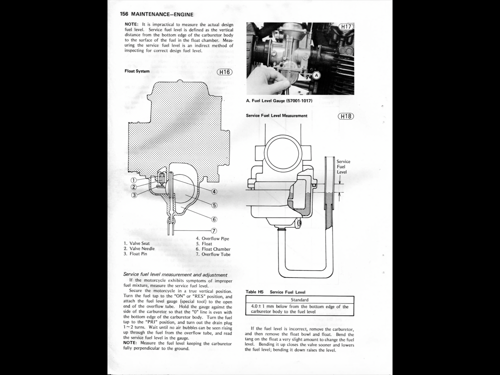

Hello all first of all Happy Holidays for you all. and for those that believe God Bless my question is does anyone of you know is there a standard float height that I can use as as a default to set my carbs on a KZ 750 E 1 1980.

I've never seen a float height for the CV34 carbs. Fuel level is detailed in the manual though and is what really matters.

In case you aren't aware. There's an 80-85 750-4 pdf manual available, probably linked here on KZR in the filebase. Yellow-gold cover w color wiring diagrams. There's also a poorly scanned black-&-white version floating around the internet, so be sure to get the good one.
