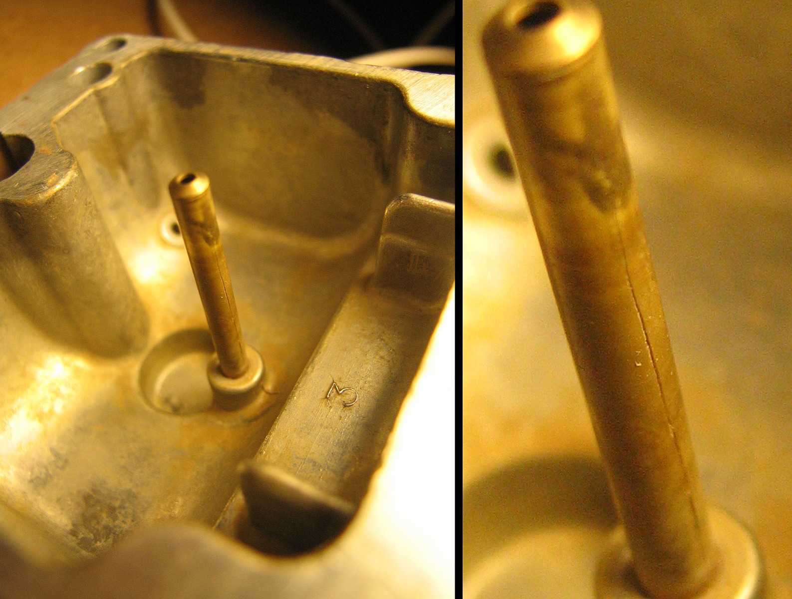

Check for cracks in the float bowl brass overflow tubes. If cracked, the tube can be replaced fairly easily using info posted either here or on the internet.

Cracks in the overflow tubes are typically visible when you look close.

Qsmothers3 wrote
Is there an easy way to tell if that over flow tube is cracked?
-Yes
Bowl off the carb. Drain screw open. A bit of rubber tubing on the drain nipple outlet. Finger over the top of the drain tube. Fill bowl with water and blow in the rubber tube
See any bubbles ?
Like looking for a puncture in a bicycle tube
And yes I have done this myself and it works

Check the fuel level with clear tube method. This should tell you if the carburetor is over flowing or if you have a cracked tube.
