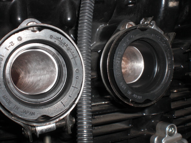

The manifolds listed here are what you're looking for:
kzzone.com/carbs.html
. Be aware, though, that with a stock KZ900 head, you'll now have a step between the new manifold and intake port - not the ideal arrangement from an airflow standpoint. Part of a porting job is to blend the intake port to the larger diameter manifold boot.

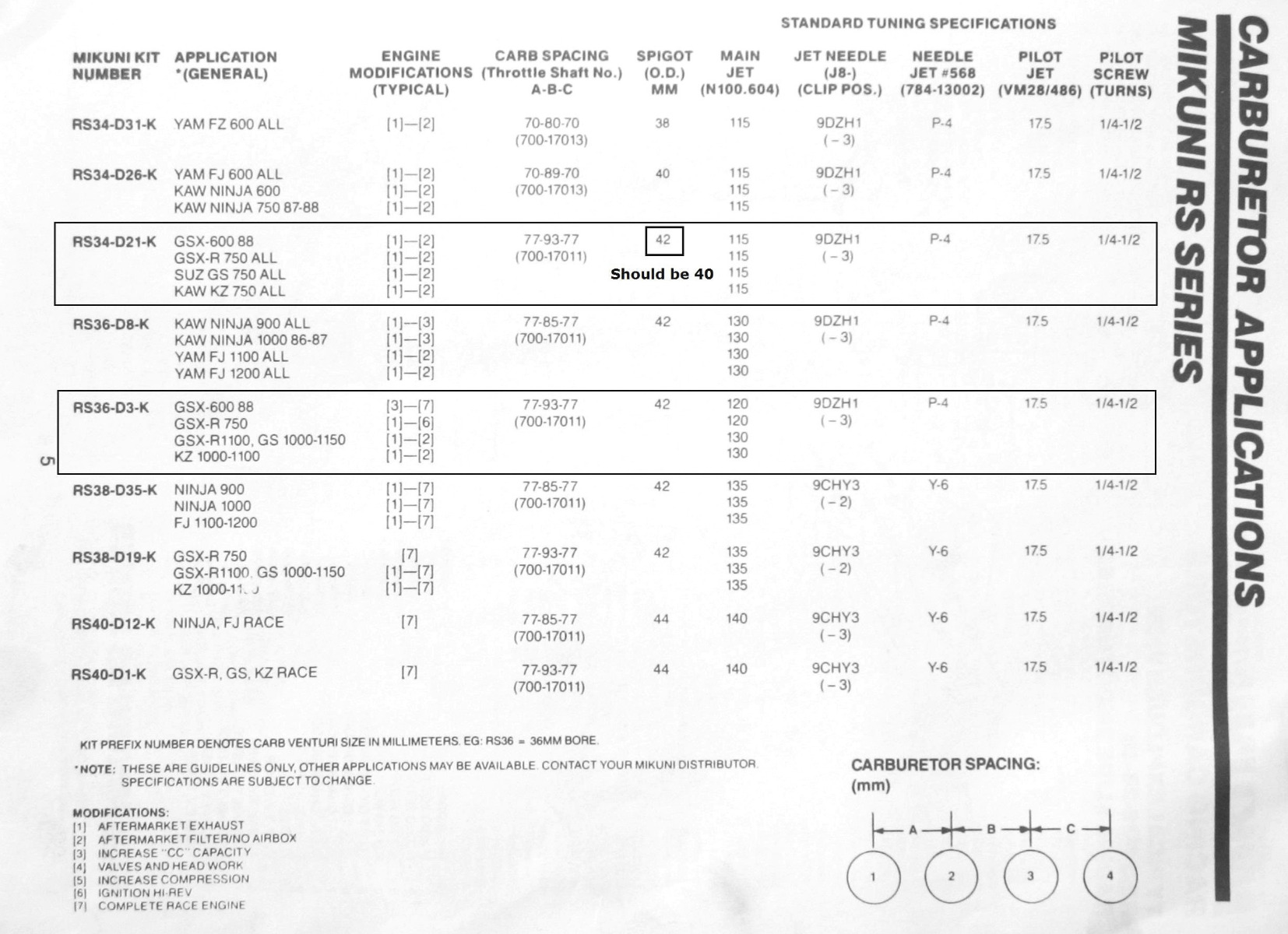

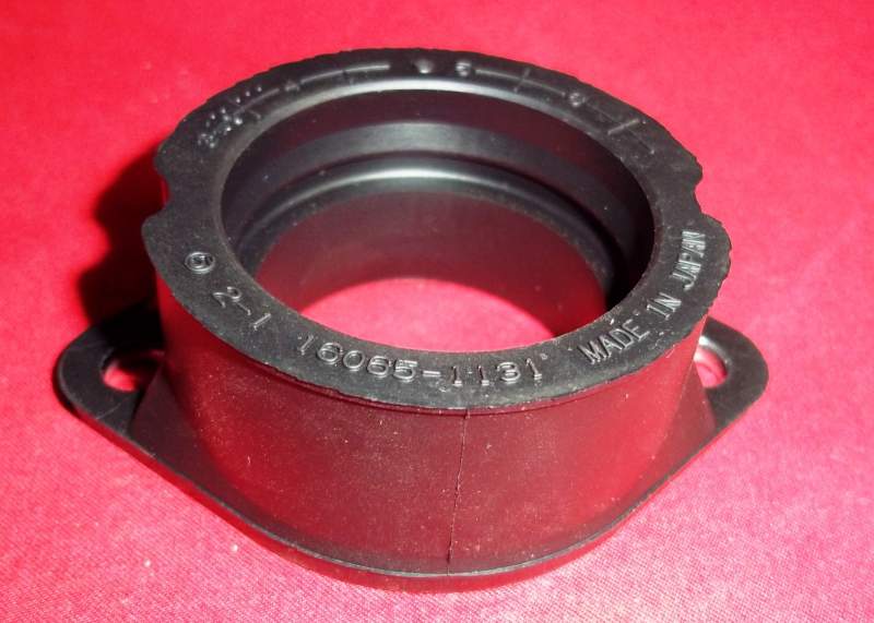

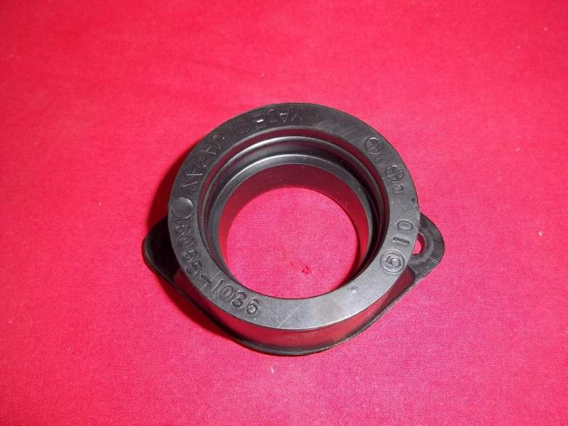

Can barely make out the numbers 16065-1131 on that part image...but it's there

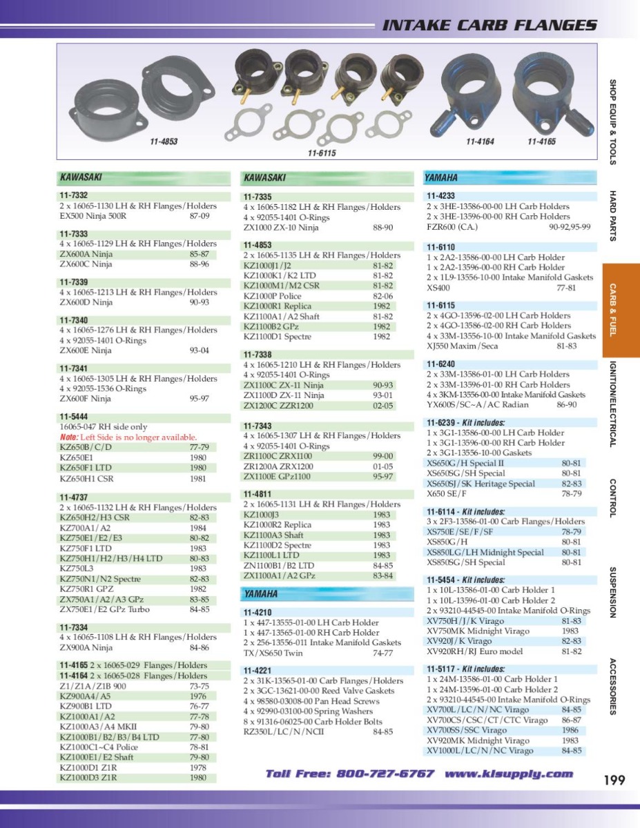

For Genuine Kawasaki manifolds which are not cheap, Ebay item 255201898786 (set of four) is currently available.

He need the 16065-1131 mainfold boots. Mikuni RS 34 O.D to boot inlet is 40 mm.
16065-1066 suspended by 16065-1131 = I.D to carb 40 mm , I.D to cylinder head port is 33-34 mm.
16065-1036 (I.D 41 mm) suspended by 16065-1135 = I.D to carb 42 mm, I.D to cylinder head port is 35 mm.
Dragbike_Mike is right, you have to blend the KZ900 intake port for better airflow.

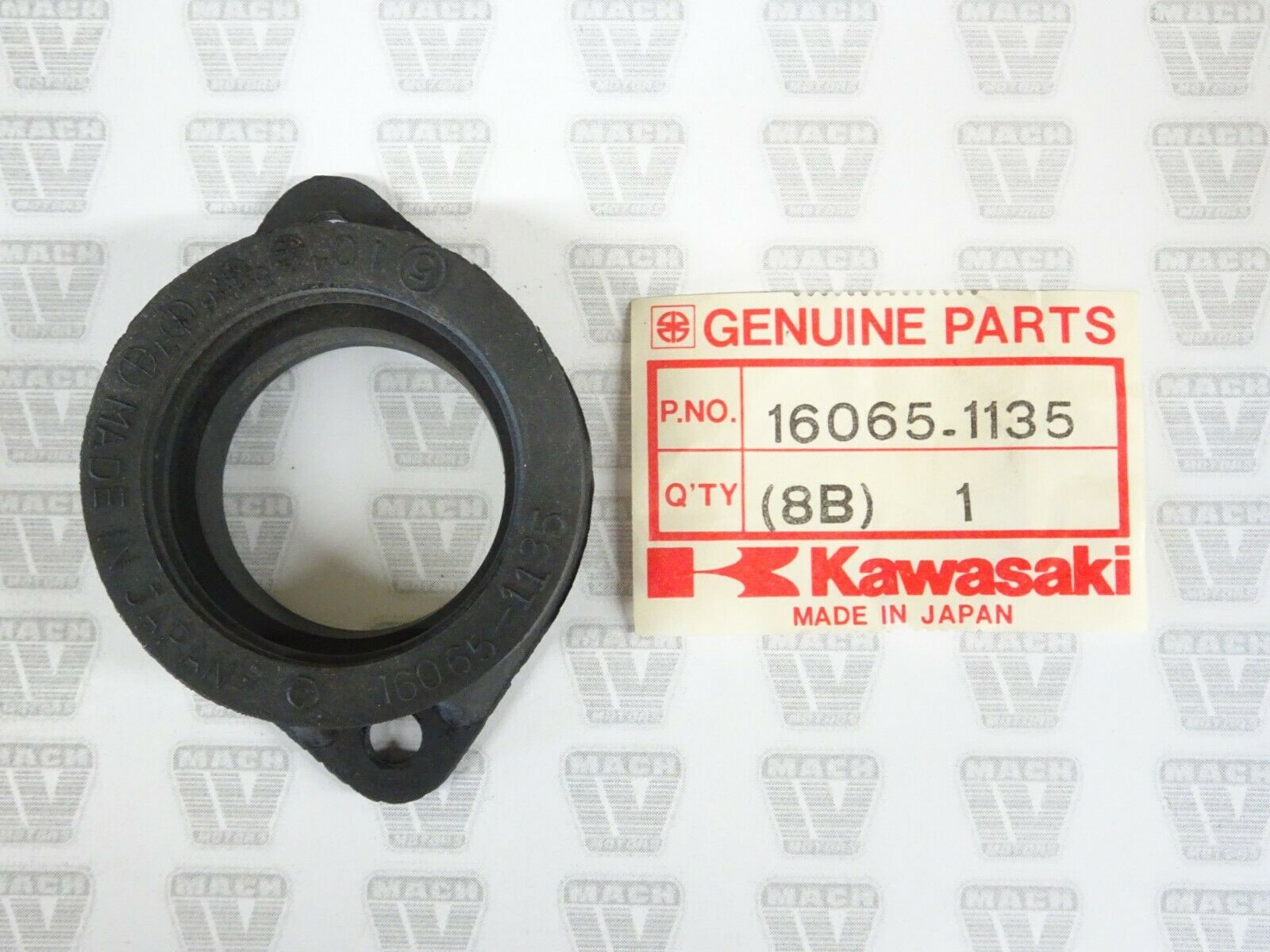

The 16065-1135 manifold pictured above has an internal ridge that mates with the RS34 40mm spigot perfectly.
Bolt hole center spacing measures 58mm.
Spec discrepancy noted below:

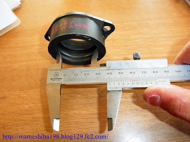

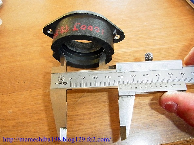

Daveo you are totally right. The 16065-1135 mainfold is a perfect fit on the RS34 spigot. I did measure my new spare set of 16065-1135 boots today and the I.D is 40 mm.
The 16065-1066 and 16065-1131 used boots I.D i have measured today are 37 and 38 mm. Will post pics later....
