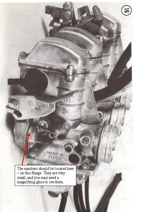

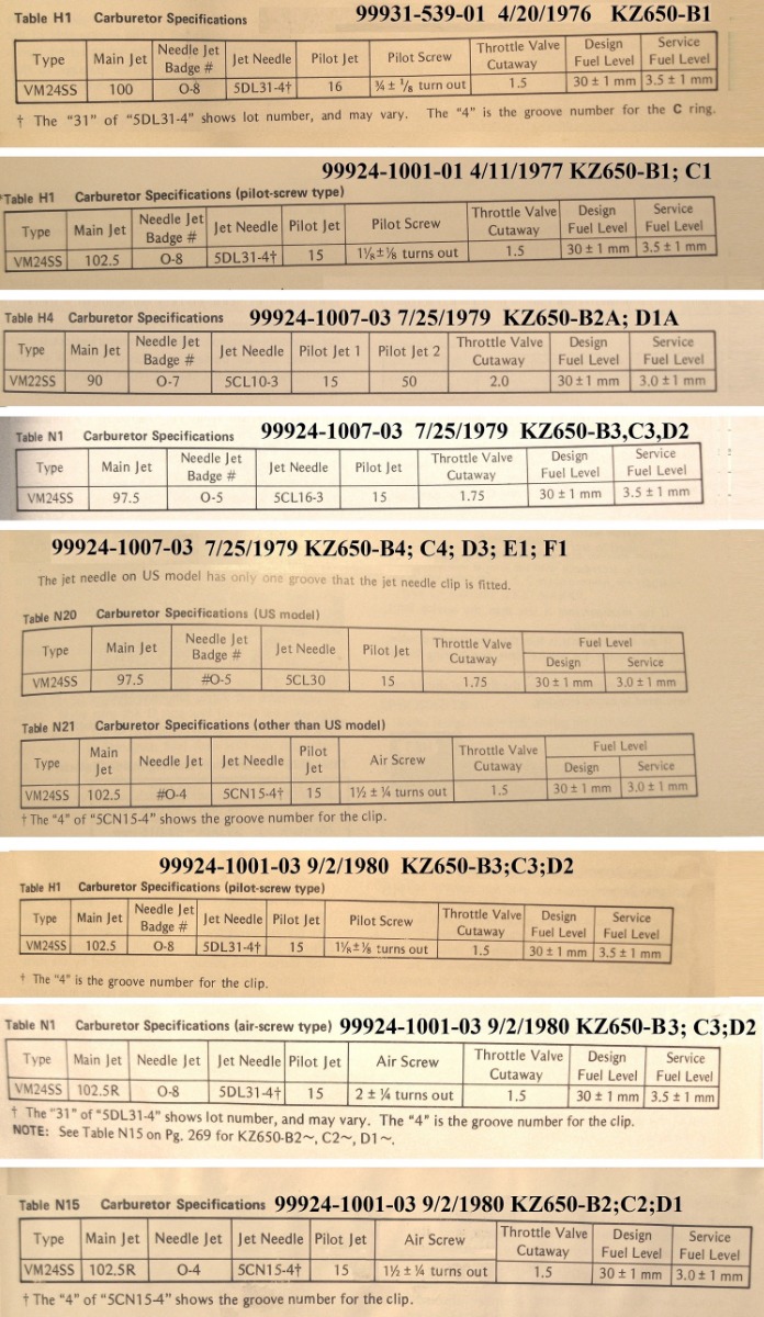

Not sure if this will be of any help or not. The KZ650 LTD is sort of a confusing model. In the US market it was known as the E1 model for 1980, but was also offer in other markets in 78 79 as was much like the SR (D) models. There are some differences between rear tire size and the number of front disks, and shoe or disk in the rear. If your bike is an E1 it would of come stock with an accelerator pump on the carbs and the air screw will have a plug over it. The carb settings tables from the manuals do not indicate what the air screw settings are for any of the accelerator pump carb with the plug over the air screw.
I have attached a jpg image of several different FSM carb tables one of which does list the E1 model. Also there should be an ID stamped on the carbs on the flange below the choke lever and if you post it I may be able to tell you more. The second attachment shows where this ID is stamped. Keep in mind it could be on the outside of carb #4 instead.
