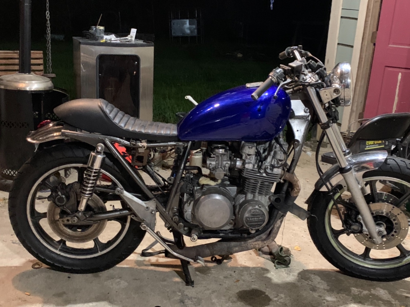

Hey everyone, and thanks in advance. I’ve got a 1980 kz 750 H1 with the third slide stuck so bad it’s almost like it’s welded on.there was so much trash and what not. I’ve been reading thru the forums and saw that you could heat the carb and it might free it up. But the rubber and plastics in there seem like they would be harmed. I’m open to all suggestions and thanks again in advance

Red flag trying to run stock jetted carbs without the airbox. It should start okay if the carbs are clean but the engine will run drastically lean. And installing pods won't help the matter. And (2) running cheap dimestore pods like Emgo's are worst case situation. If you insist on running pods spend some $ and buy quality K&N's, UNI's, APE (not sure they have the correct size,) etc, jobbies.
