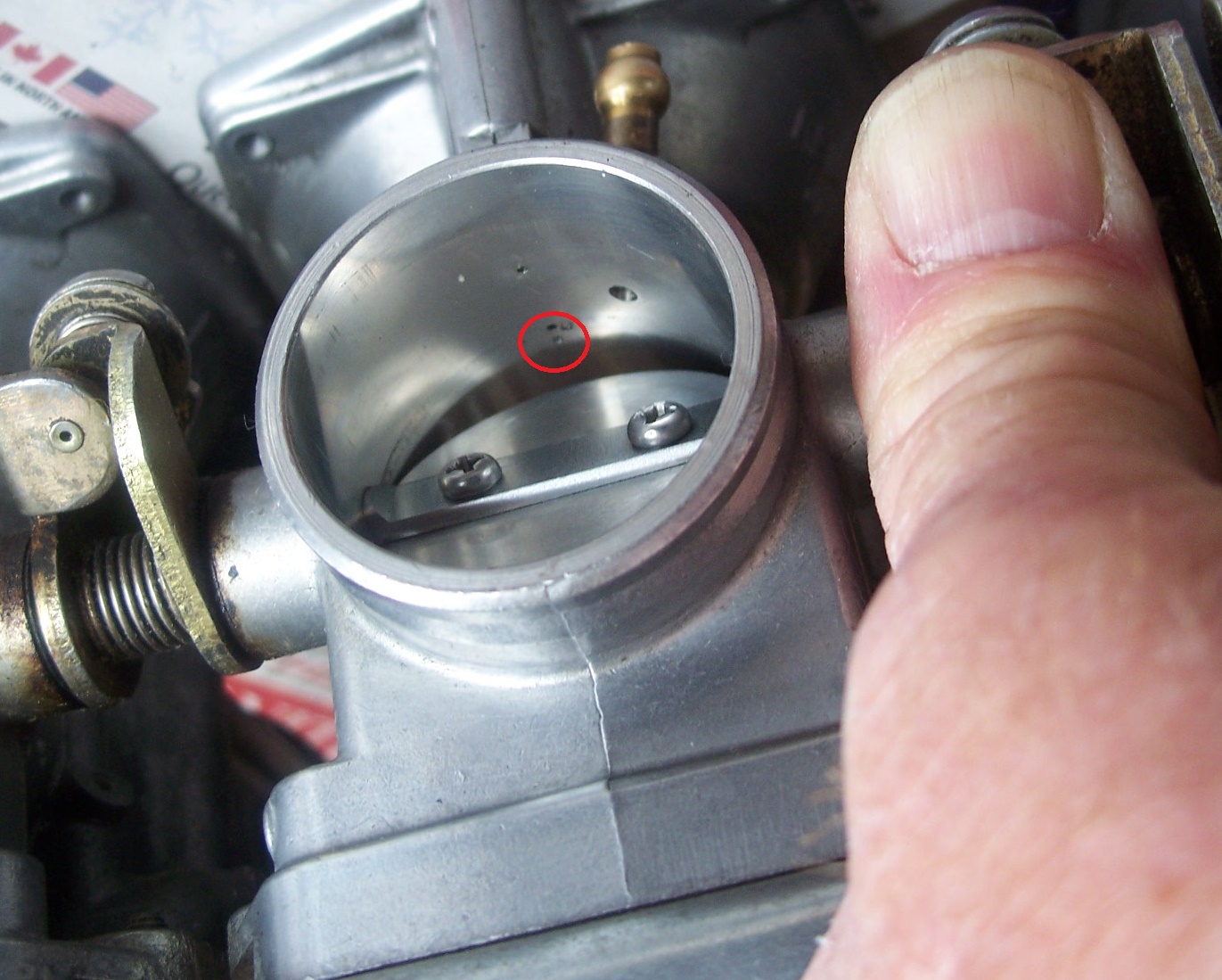

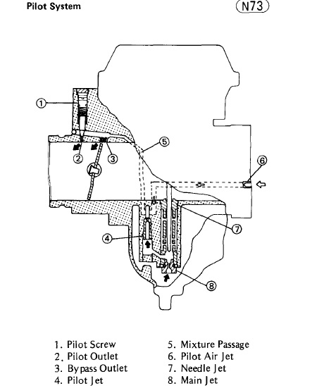

These 3 tiny holes (Pilot Bypass ) are easily blocked and easily overlooked. A fine pin with tip bent 90 degrees works well to poke out crud
Carb cleaner sprayed in #4 should exit at #3. Wear safety glasses as spray may exit elsewhere and carb cleaner in the eye is painful.

Thanks, JR for the insight on the pilot system! My service manual unfortunately doesn't go that deep into it. I carefully checked those with a needle and a spray and all of them seem to be clear. I noticed different happy little issue though. Back then when I synchronized the carbs I only had to use the center adjusting screw as both pairs seemed already synchronized in between. However I now noticed that the screw for the problematic carb was loose. That means I'll probably have to check it with the vacuum meters again and take it for another test ride.
