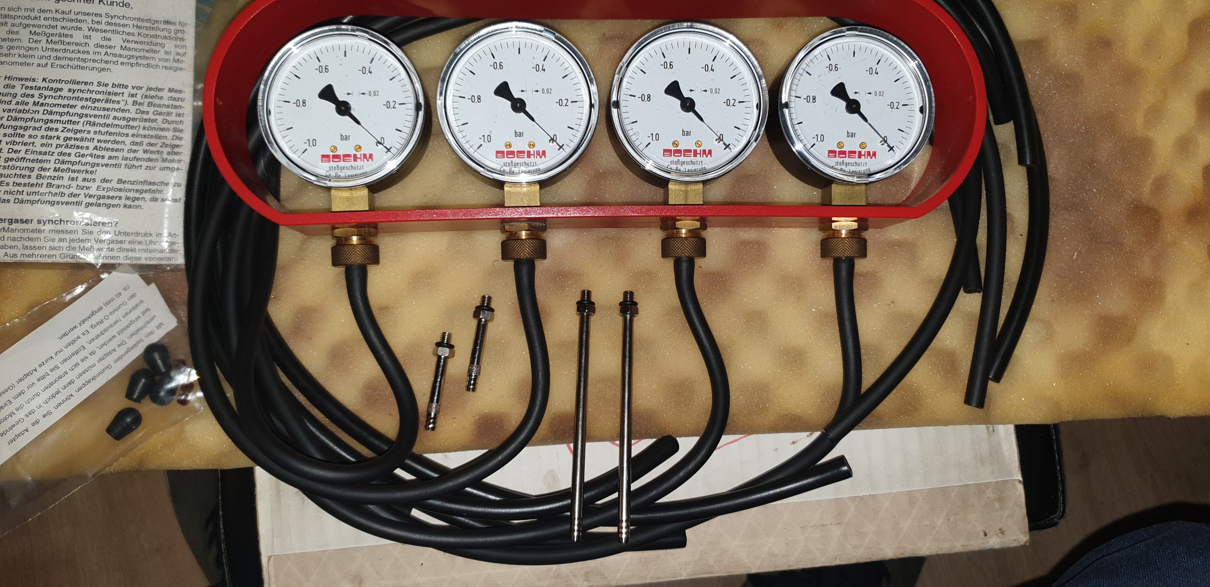

I sync carbs with my Boehm sync gauge (Made in Germany) for more than 25 years. Stay away from cheap china knock off clocks.
Look at the clock hands and you will see the difference in precisin....

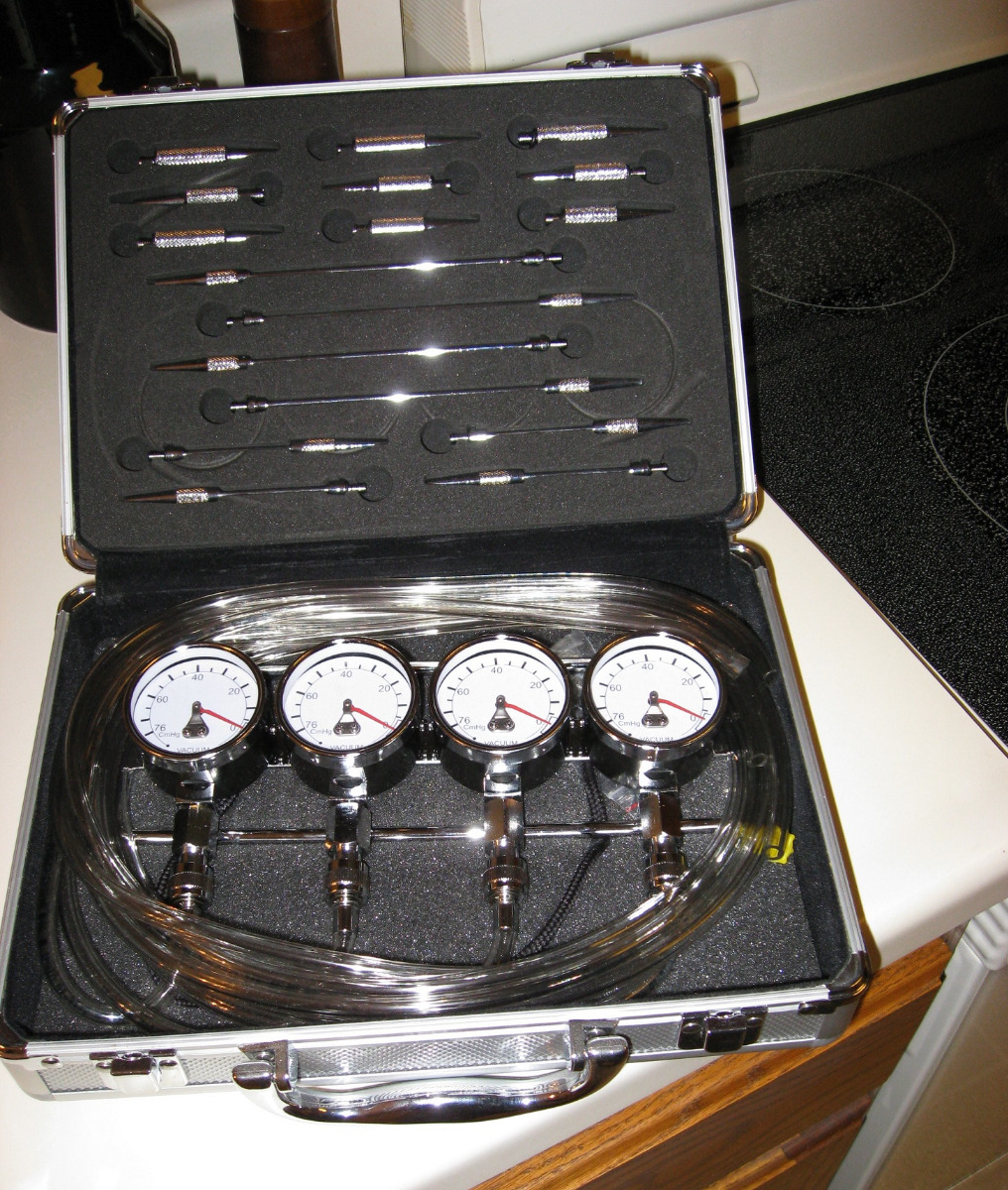

Below is a picture of what I use; they work great! They look very much like the ones in your posting. Previously I had a set of cheap gauges and they were crap! Ed

I have both the Morgan Carb Tune and the gages that Scirocco mentioned. They each work well, but the Boehm gages are super accurate. I had to go in a round about way to purchase them as the retailer didn't want to sell in the USA, so I bought them from a place in England. Just make sure to follow the directions with the gages or risk damaging them. I use the Carb Tune as a backup to verify the readings I get with the gages. Cheap gages get you nothing but frustration in an important area.

What brand are those Ed?
- Posts: 15339
- Thanks: 2833
Re: Fed up with my motion-pro sync gage
10 Oct 2021 07:45The set I have doesn't have a brand name on it, but it looks exactly like these:What brand are those Ed?
www.amazon.com/ALPHA-MOTO-Synchronizer-S...a-451671400718&psc=1
