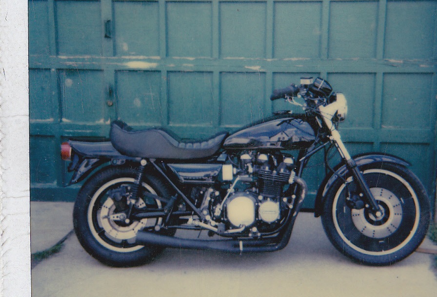

Any foam? Upholstery shop? Furnace filter foam?
I bought my 1st ABE bread box from "Beck-Arnley" in 1978 for $19.99. For the 1000,
Then it cracked my paint job side cover up by the gas valve from vibration. Because the air box rubbed at the plastic side cover.
Old pic copied.
Old pic copied.
