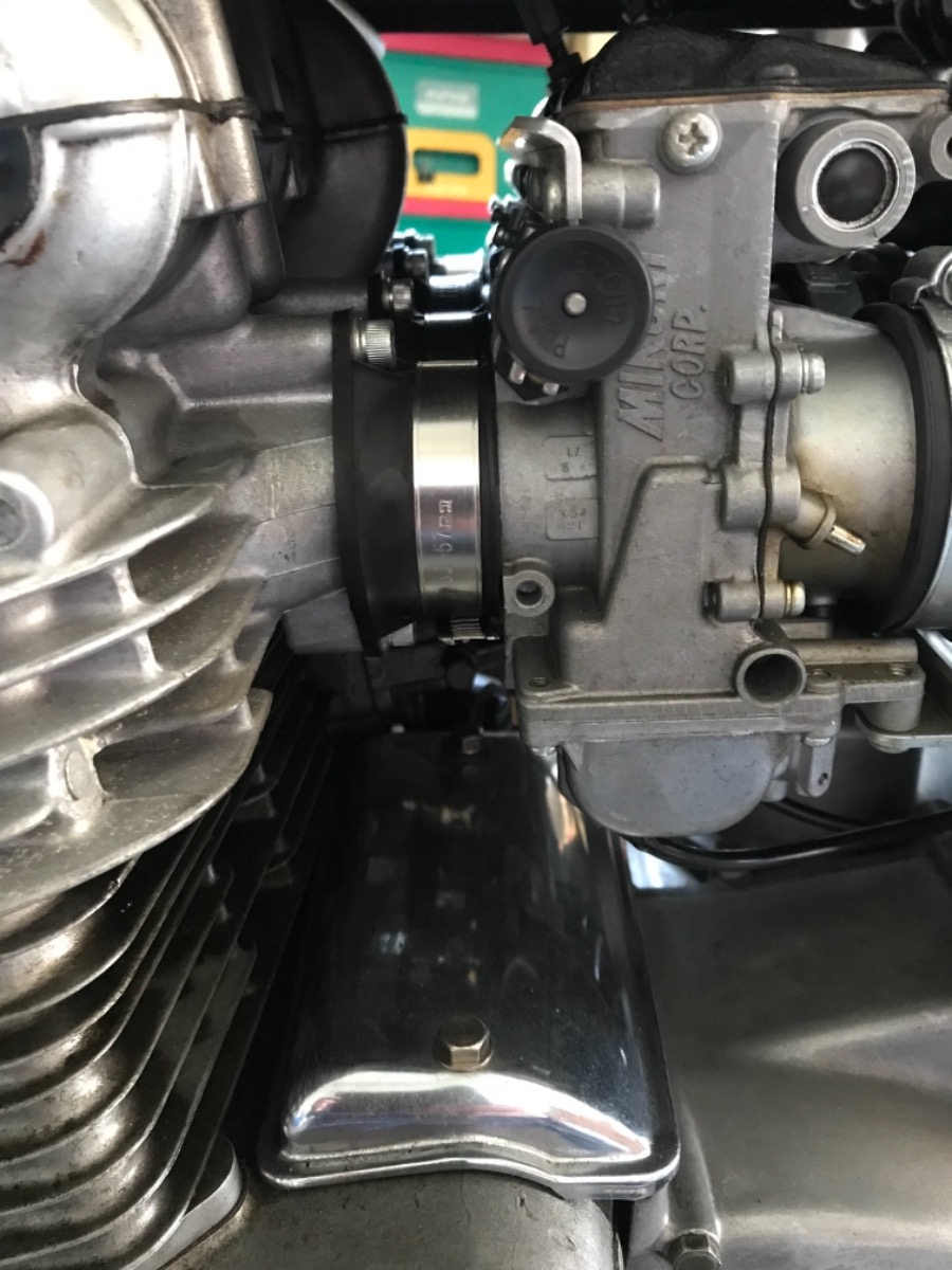

Hey, (‘77 kz1000a) I have changed OEM 26 mm round slides to RS 34 flat slides.
I would now like to dynamically check sync.
The intake manifolds supplied that I am using do not have a vent for connecting a manometer type tool to.

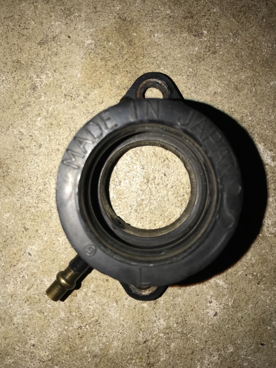

Has anyone here modified intake rubber boots to include a vent as in OEM pics?

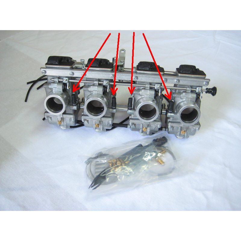

Re: Intake carb boot manifold manometer spigot tap off vent
05 Sep 2021 04:48
The following user(s) said Thank You: martin_csr, kz_1000a

Well... that was a major oversight on my behalf!
Is one of these ports a master port?
( I usually calibrate my non-mercury 4 column carb synchroniser to a master vacuum port )
