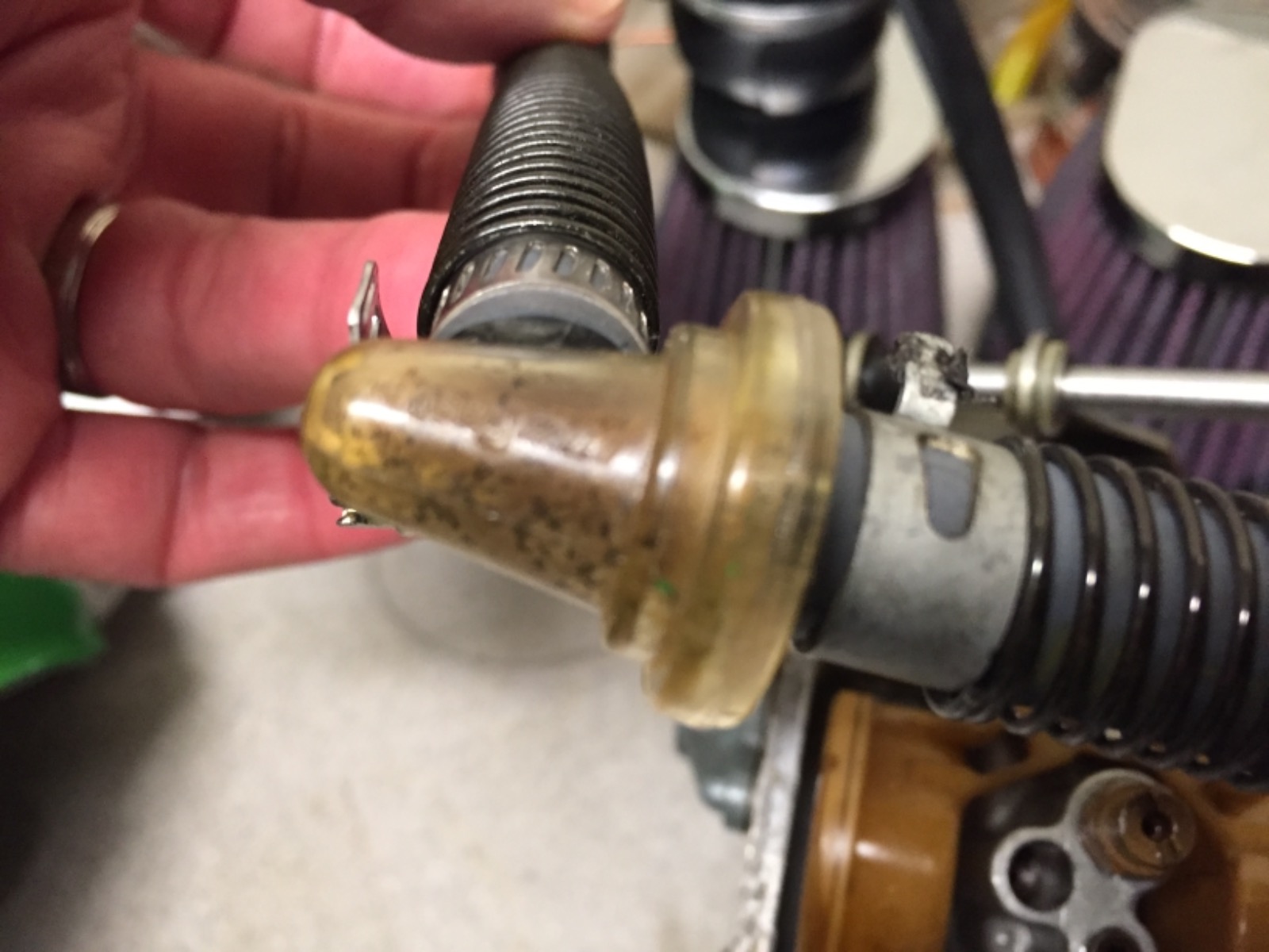

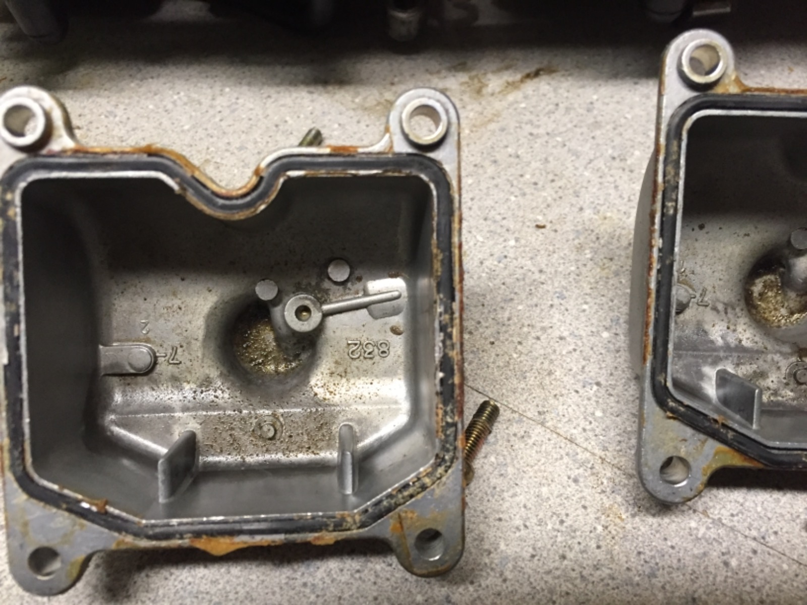

After some more thorough testing it seems that one float is sticking open and allowing the carb to drain the residual fuel in the lines after the petcock.
Lesson learned to not make assumptions, I really thought they wouldn't be dirty, but a slight tapping on the float bowl can make it start or stop leaking. To be fair the interior of my tank is pretty rusty
