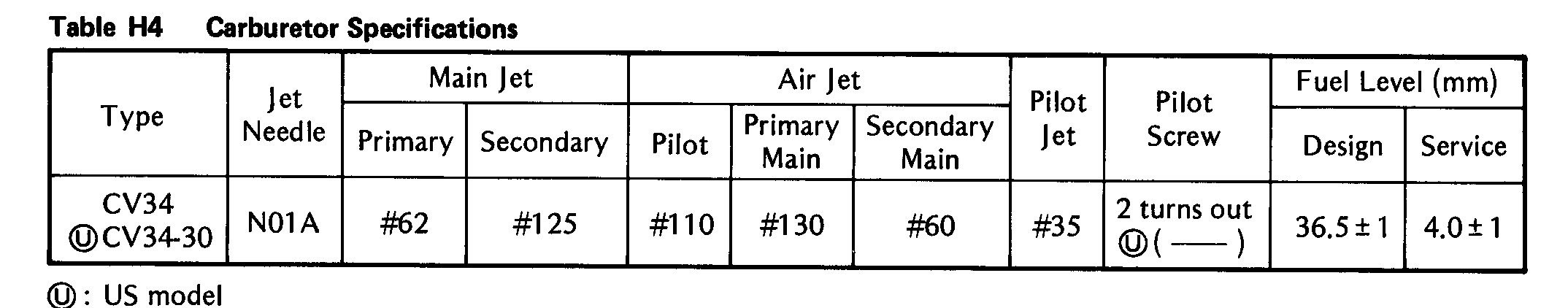

If I remember correctly the stock carbs on the H models were Keihin cv34. I have attached a table from the FSM for the carbs stock settings.

The secondary mains go up in increments of 5. I would suggest swapping out the stock secondary 125 for a 130 and leaving the stock primary 62 alone at least for now. Thats what I have done with the new Delkevic shorty which does have a baffle but is more free flowing I believe than the old Mac.
