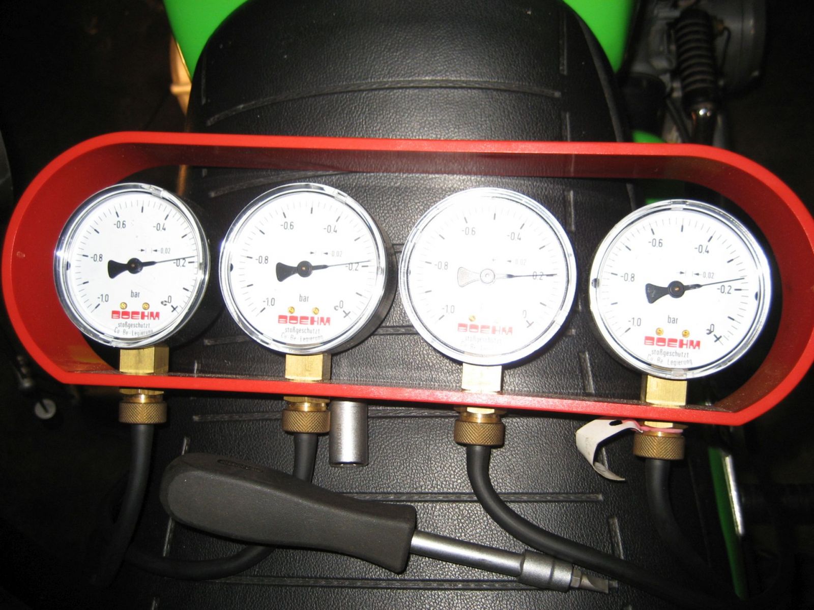

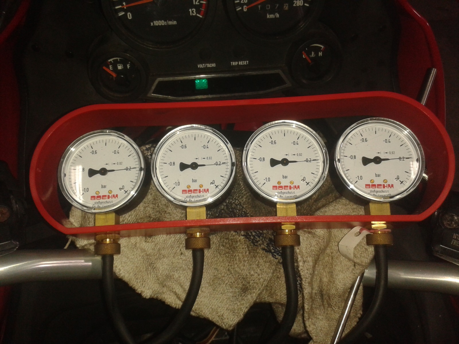

Take your time and took off the float bowls and clean all parts, like pilot and main jets. The bleeder pipe air openings,(where the pilot/main jets are screwed in), can also be clogged.
You will find a lot of info and manuals here how to clean, maintance and adjust a carb set right to your bike. As always: "Read the f**king manual!"
To answer your question about the vaccum value on a good runnig engine.
