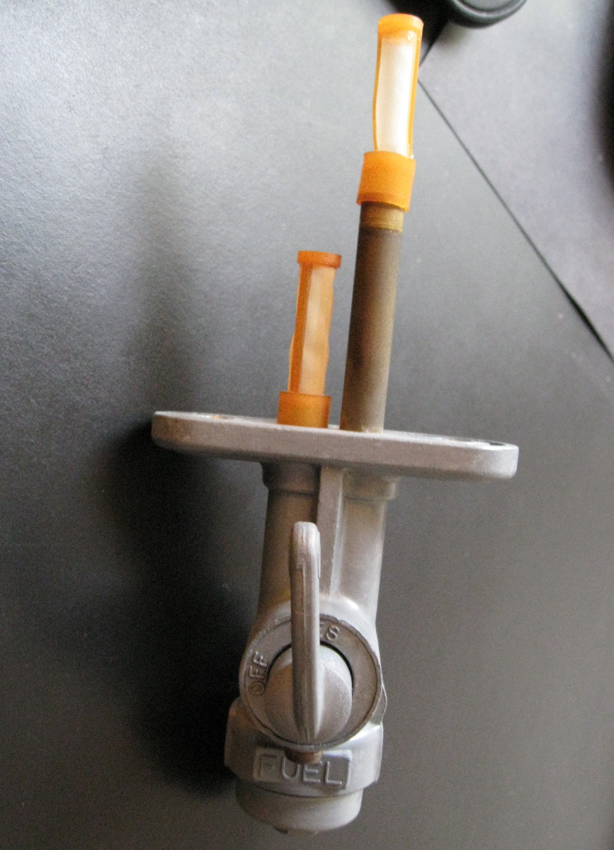

I took a screenshot from my other website of the photo I took comparing the OEM to the new Chinese petcock. Note the difference of the internal fuel passages and the dull rough finishes on the oring mating surfaces.
