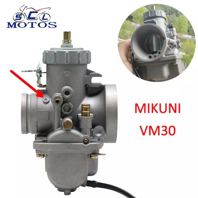

I did it, pulled the trigger on a dual VM30 setup. My question is with the petcock or "fuel tap" as kawasaki calls it. The petcock has a vacuum line that connected to the old carburators, what do I do with this now? Do I need to replace my petcock with one that has a different setup?
Re: Dual VM30s on a KZ440. Anyone done it yet?
28 Jul 2021 16:11To get a vaccum tube connected to your petcock you have to add/modify one of your VM30 carbs. Drill a hole, cut a thread and screw in a brass tube.....I did it, pulled the trigger on a dual VM30 setup. My question is with the petcock or "fuel tap" as kawasaki calls it. The petcock has a vacuum line that connected to the old carburators, what do I do with this now? Do I need to replace my petcock with one that has a different setup?

Son of a f*cking b*tch. Just another thing to tackle. Currently, I would not advise anyone to purchase the dual carb kit from Speed Moto Co at this time. It came with zero instructions, it did come with a brass barbed "tee", but the tee does not reduce the fuel tank line down to carb size. It came with a fuel filter, which is nice, but again I have no means of reducing the fuel tank size down to the carb size...unless I use a hose clamp to clamp the oversized fuel line to the tee ( which it also didn't come with ). I went to 4 hardware stores looking for a 3/16" to 1/4" brass barbed reducer and failed. It also didn't come with enough hose for to properly get the lines down to proper dump location. Now I have to drill a carb, tap it, and buy a brass connector. I'm thoroughly pissed off with this since they called their kit a "big red easy button" during one of the conversations I had with them prior to ordering. I'm really unsure how they can charge what they do, when they don't provide the necessary things to make the connection...especially since at the bottom of the
product page
they say: "Q. Why is your kit more than that other guys ? A. It is a better kit." I sent this very same question that I posted in the OP to them, I'll see what they have to say for the solution. But I'm probably going to go after them with the better business bureau if they don't set things right.
Off hand, can anyone tell me how to differentiate a real VM30 from a fake? I'd be royally pissed if they sold me fakes too.
Sorry if I'm a little incoherent. I'm a bit pissed and don't feel like proof reading too much.

Yeah, that's why I went with the Chinese knockoffs. I knew any "kit" was still going to take a lot of extra running around and problem solving. The knockoffs, with other parts required, ended up less than half the price of the kits.
In the build thread I included details about the main jets. Real Mikuni will have a non-standard bolt thread. The Chinese knockoff main jets use a standard thread. This allows us to use Keihin, Teikei, and Dynojet main jets, which luckily we have a bunch laying around from our 550's. So the main jet thread will distinguish the Chinese carbs from real Mikuni. If they say Mikuni on them, like the photo Scirocco posted, they are more likely to be real. The fake ones have no cast-in name. But I think the jet thread is a better method of distinguishing.
kzrider.com/forum/11-projects/611489-due...00-s?start=24#812095
