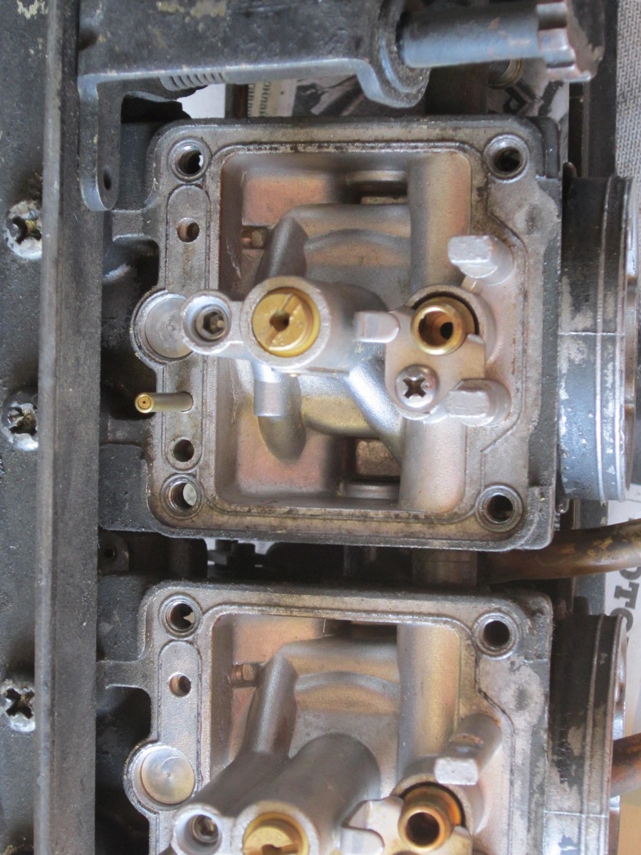

hi guys, the pilot jet plugs are missing in my mikuni carbs, how would they act without those plugs? actually, i've threaded the holes and installed m6 stainless steel plugs on fuel resistant gasket maker, see the piccie
another question, any info on rejetting both KZ750 keihin carbs and GPZ750 mikuni carbs for pod filters and straight thru zorst (i have both of them, tho d'rather use keihins and keep mikunis for my gpz engine)

01 Jun 2022 16:16To my knowledge, it would probably be a little rich, since they share the inlet from main jet. Or the main would be rich, because now both jets have unrestricted flow. I do have those plugs installed, so i cant give you any better answer right now.hi guys, the pilot jet plugs are missing in my mikuni carbs, how would they act without those plugs? actually, i've threaded the holes and installed m6 stainless steel plugs on fuel resistant gasket maker, see the piccie

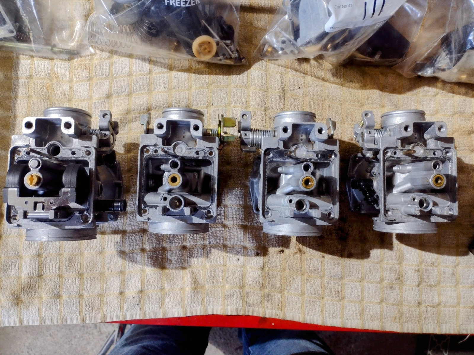

Maybe I missed this somewhere on the thread, but what about the large aluminum plug? What does it do, and does it just press in? I have one missing (see carb on far left) and I think the ones that do have the plug had an oring on top to mate flush with the bowl gasket, as they're recessed slightly into the carb body. Can someone set me straight? '82 KZ0650 CSR, Mikuni BS32, coded 1479. Thanks!

The aluminum plug is required. When Mikuni is manufacturing the carbs, machining the carb bodies, that passage allows them to drill some of the passages in the carb body. After the drilling, they press fit a plug into the carb body to plug the hole.
The plugs over the pilot jet are needed also. There is a small O-ring on the plug to seal the passage. On these carbs, the pilot jet pulls fuel from the main jet passage, via a diagonally drilled passage in the carb body.
BTW, I have carb O-ring kits for those carbs. And I may have a spare aluminum plug also.

That is a great explanation...thanks! I'd love to get one of the o'ring kits and a plug if you have one. Looks like I may be to contact you at the link in your signature? Thanks again.
