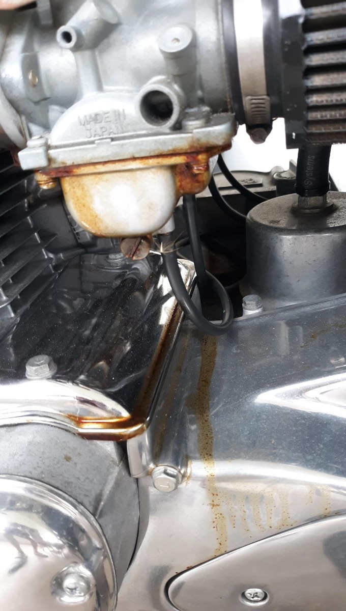

Hello everyone, it's been awhile since I have needed some advice. Been lucky my bikes been running well.
the other day I went for a ride and it ran as good as always. When I was done I parked it,and 2 days later I noticed the carberator looked like it was leaking. Anyone know how involving it is to fix this.
thanks mitch

I always shut my fuel off to prevent any leakage into the carbs.
Your carb floats may not be set to the correct level. What year is the bike? The carbs look to be '77.
Your floats may be set correctly but one or more float valves may be leaking.
I also always leave my bike on the center stand to prevent fuel from reaching the top of the bowl due to the lean.

Your 40+ years old bowl gaskets need to replaced. Keyster sold rubber gaskets (YFCG-27R) that are much better than the paper gaskets and last longer.

18 Jun 2021 18:42Same, but I also close my petcock 1/2 a block from home. It helps lower the fuel level in the bowls. I wouldn’t panic to much. If it’s running well it might just be a stuck float or a small piece of shmutzs caught in the float needle and seat. I agree it’s time to swap in some new gaskets. Keyster rubber are my go to also. I’d drain number 4 bowl, pull the float and needle. Clean up the seat with a Q-Tip and reassemble, with the new bowl gasket. Drain the other bowls and swap in the last 3 bowl gaskets. It would be a good time to eliminate the float levels and check them with the clear tube method.I always shut my fuel off to prevent any leakage into the carbs.

Thanks for the info. I wasn't aware that it could be more than just the gasket problem. It is a 1977 kx1000a. however the carbs. are micuni. they were on the bike when I purchased it. all so I just purchased A new complete chrome kerker exhaust. I want to change out the baffle for the 2 inch competition. But there on back order right now. I am sending the pipes out to jet hot to have them ceramic coated. keep them from blueing, and it will help the engine run a little bit cooler. So after I get the pipes back and get the 2 inch baffle i am planning on taking the bike to a place called jupiter cycle. want to have it serviced and the carbs pulled and cleaned and prolly re jetted, But the main reason that i am bringing it to them is that they have A dyno tune. I am looking forward to seeing the difference this will supposable have on the performance of the bike. Thanks for your response.
