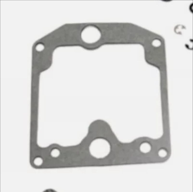

As you can see from the photos, one has an extra hole in the back.
What is that hole for?

Accelerator pump fuel passage
Edit: make that the acc pump vacuum passage...

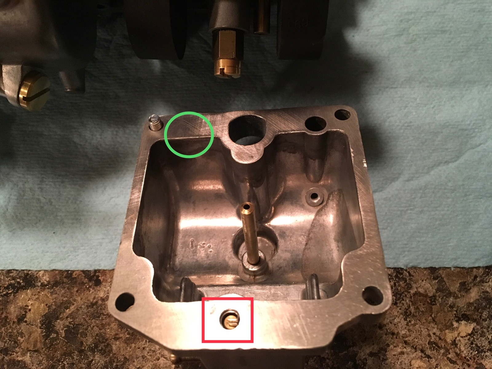

Fuel pump squirted is in the front. He’s showing an additional hole at the rear Red square is pump passage, Green circle is where the additional hole is. Non this is specific to the 1980 LTD 28 pumpers. In order to help we need photos of the carbs, where is the pilot adjusters,

Maybe you are right about the accel pump passage but don't forget, the carbs that used two diaphragms in the pump have a vacuum passage where the green circle is. That's only for one carb but gaskets are often made one size fits all.

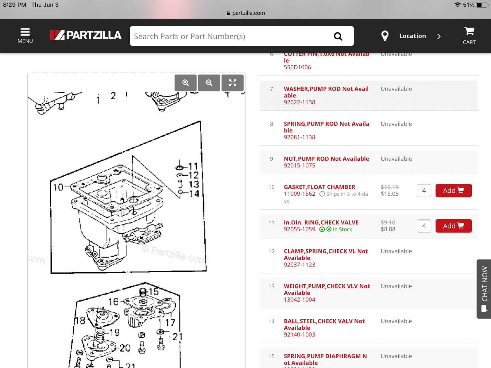

Nessism, I have never worked on the 26mm pumpers with the signal diaphragm. The Partzilla fishe shows the gasket with the hole at the green circle. Thanks.

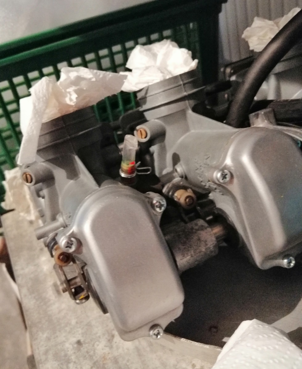

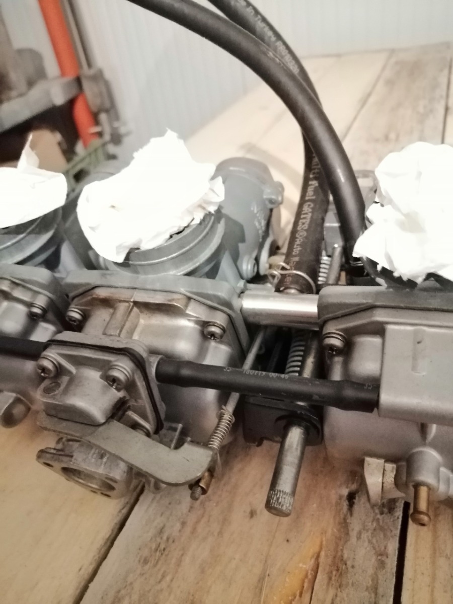

These are 2 old photos, from before I installed them.For sure they only have one diaphragm, the one with a square shape.I don't know if this will help to recognize them, otherwise I'll have to disassemble them and check.

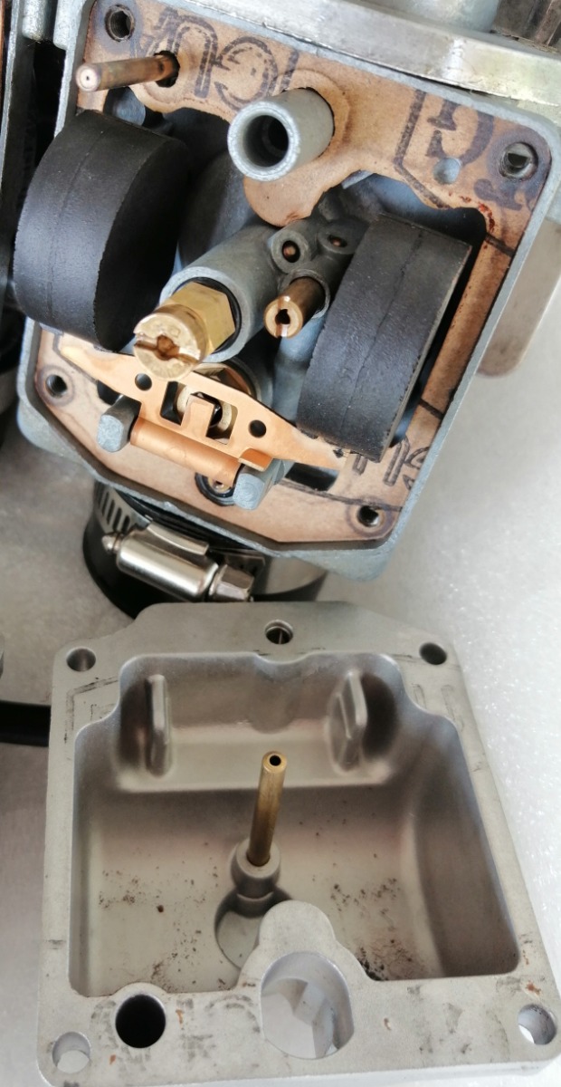

05 Jun 2021 05:22Your carbs are VM28 pumpers.The additional hole in the gaskets shouldn't be a problem.Carburetors just opened, the gasket has a hole, but there is a dead end hole in the carb body. I think both gasket are OK for this vm28. Thank you
