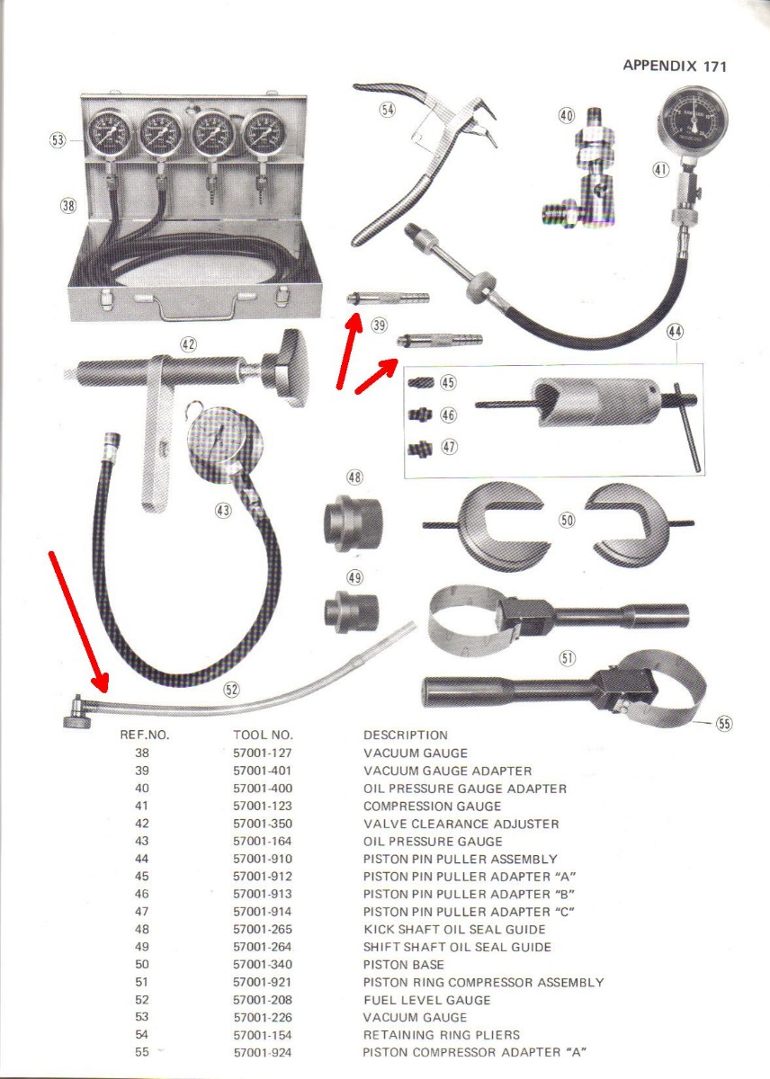

I rebuilt my carbs, and got the bike running ok, but i have a couple questions.
please refer to the image for reference.
What should #1 be connected to? i believe it went to the airbox, but that's long gone.
The choke lever #2 is missing whatever keeps it engaged. i assume it was a ball and spring? any clue where i can get a replacement?

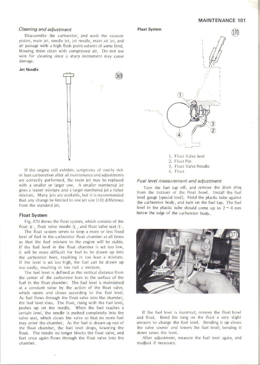

I need to sync the carbs, and check the float levels. Where can i get the fittings for #3 & 4?

#1 need a tube to atmosphaere
#2 yes, need a spring and steel ball to engage the choke leveler in position
#3 vaccum port block off screw, need special tool/tube M4
#4 bowl drain screw, need special tool to set up float high

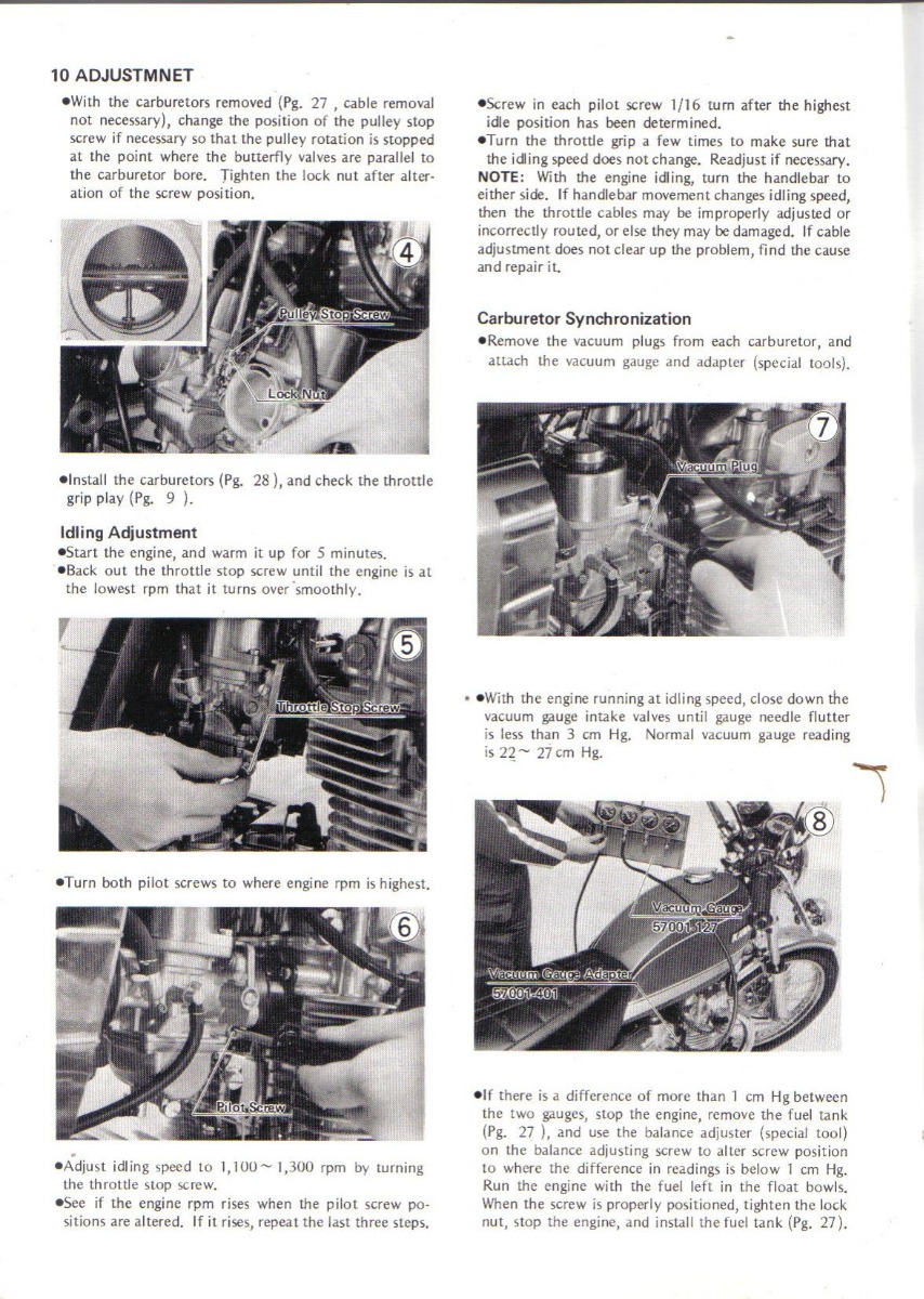

Thanks for the info, I have most of that already, but neither my Clymer or Shop manual have that appendix (that i can find).
Aside from the first one, my question was actually "where can i get them?"
I will check my sync tool. I've never needed an accessory for my Yamahas, so i didn't think to look for it.
any idea if this will work with my keihin carb? Z1 fuel fitting
it claims to be equivalent to OEM:57001-208 (number from the appendix), but i can only find that number in reference to Mikuni Carbs.
Want to be sure the threads are the same.

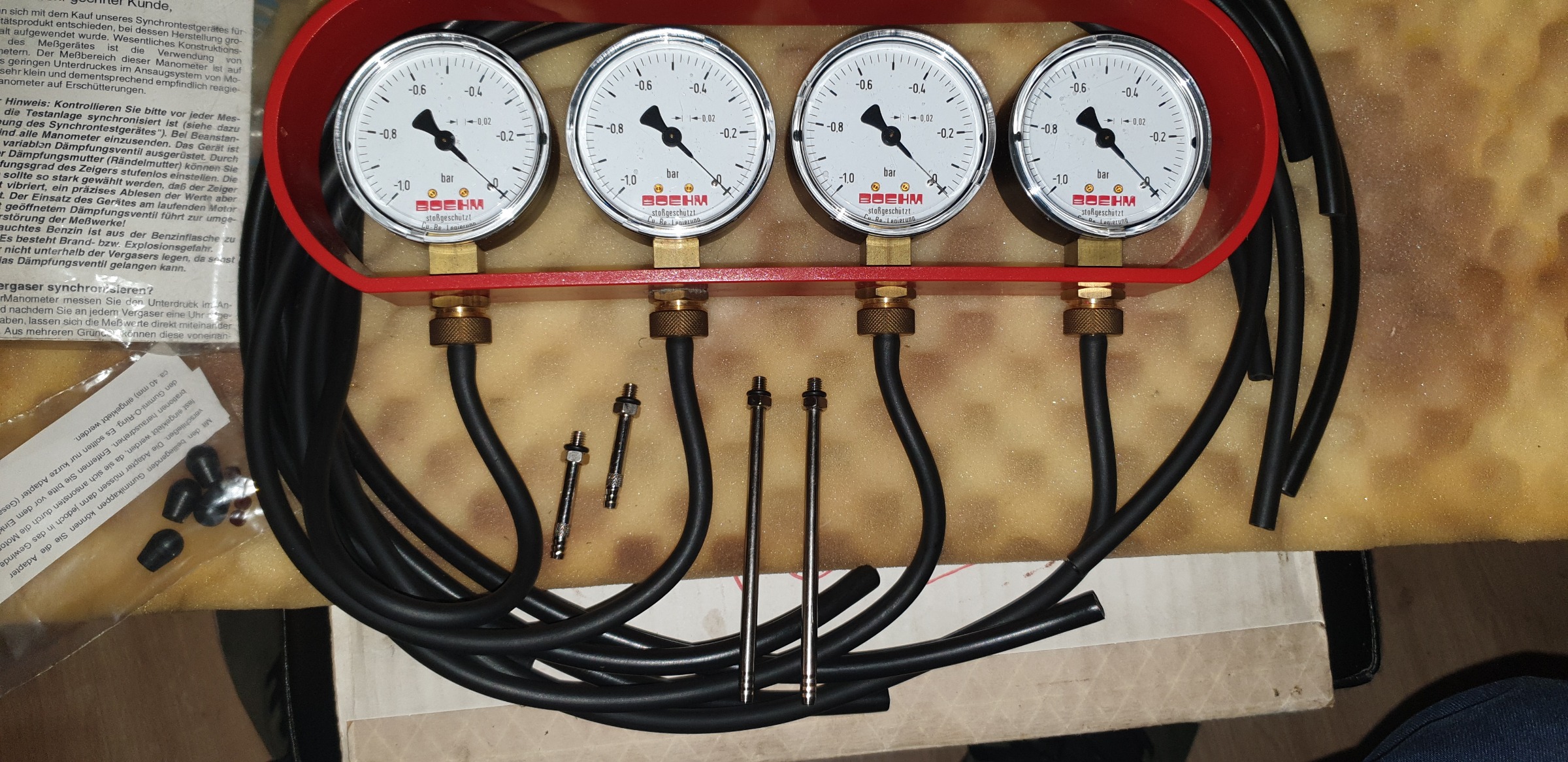

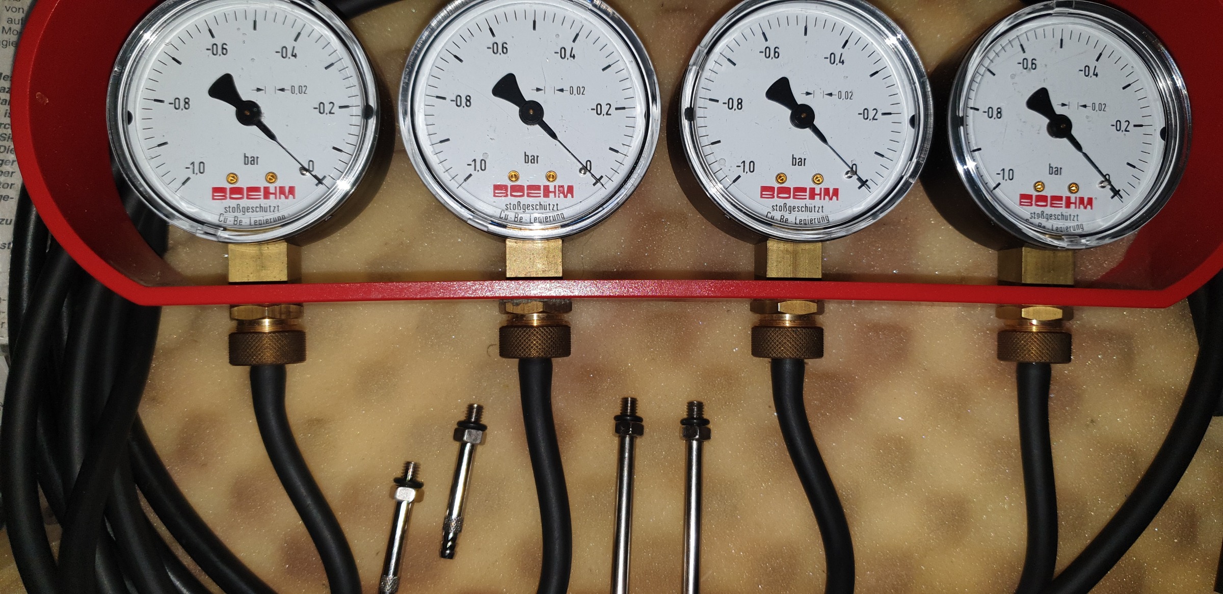

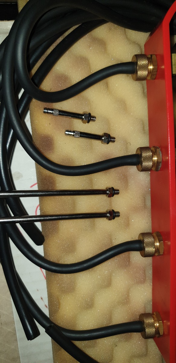

I checked my sync tool, and the included adapters are way too small for the Keihin carb.
i searched for P/N 57001-401 as referenced in the appendix, but all i can find are 2 sketchy listings on ebay, which want waaay too much for 1, and partzilla "might" be able to get one in "a few weeks"...
someone has to have found an alternative...

I made adapters. The threads are a standard metric thread. I drilled a hole through a bolt the long way and cutoff the head. The bolt should be long enough to have a smooth shank. I then brazed a nut on to seal it. With a small oring, it did a decent job during the sync. I then left it in the carb instead of the plug screw, and put a rubber cap on it.
If you can find brass bolts, that would probably be easier to drill and solder.

according to my thread gauges, it's a M6x1 thread...
I found these nipples , which hopefully will do the trick
I believe the drain plug is also 6mm, but a different pitch.
haven't had a chance to drain my fuel bowl, to check.
Fingers Crossed
Fingers Crossed

In order for a vac synch to work properly, you want a restriction as close to the carb as possible. This is so the synch tool doesn't alter the vacuum reading.

- Posts: 4836
- Thanks: 1851
Re: A Couple Carb Questions
07 Jun 2021 16:14
The following user(s) said Thank You: PoodlePuncher

07 Jun 2021 21:33Thank you, That is exactly what i've been looking for.
