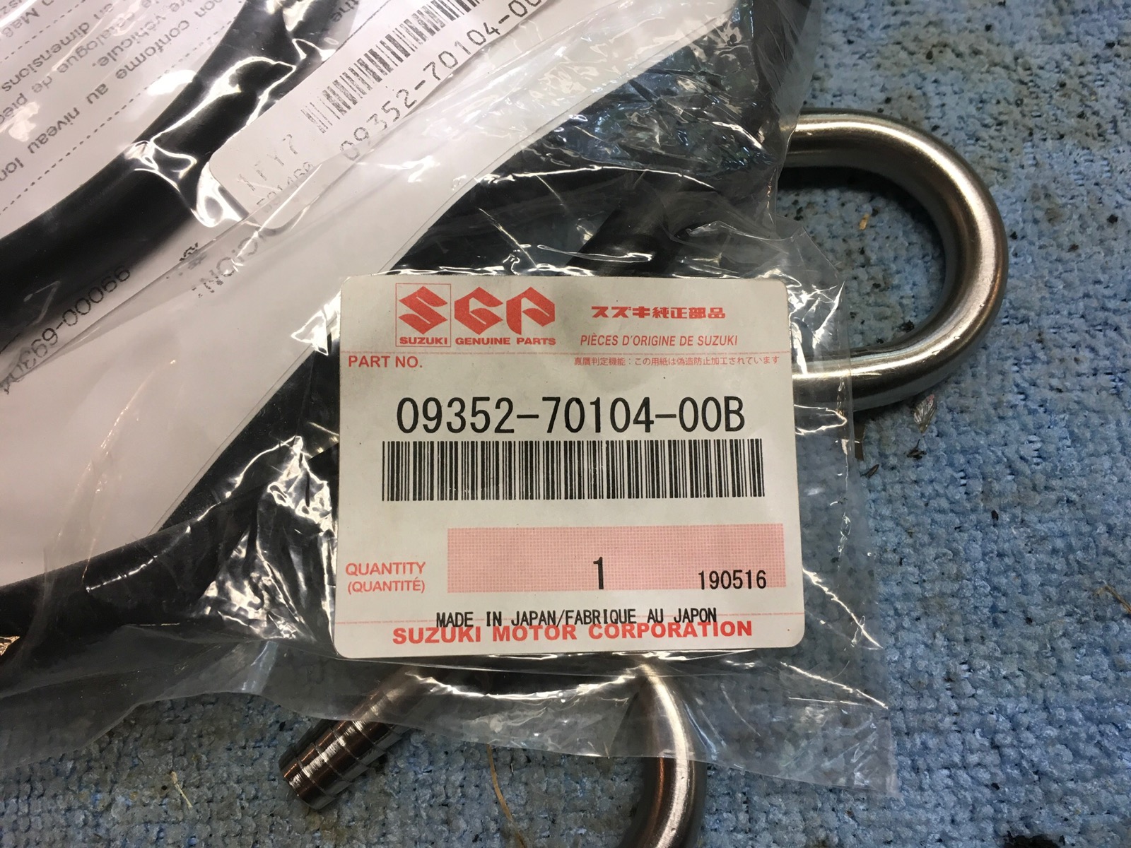

Re: Correct fuel hoses/clamps info needed
01 May 2021 11:31
