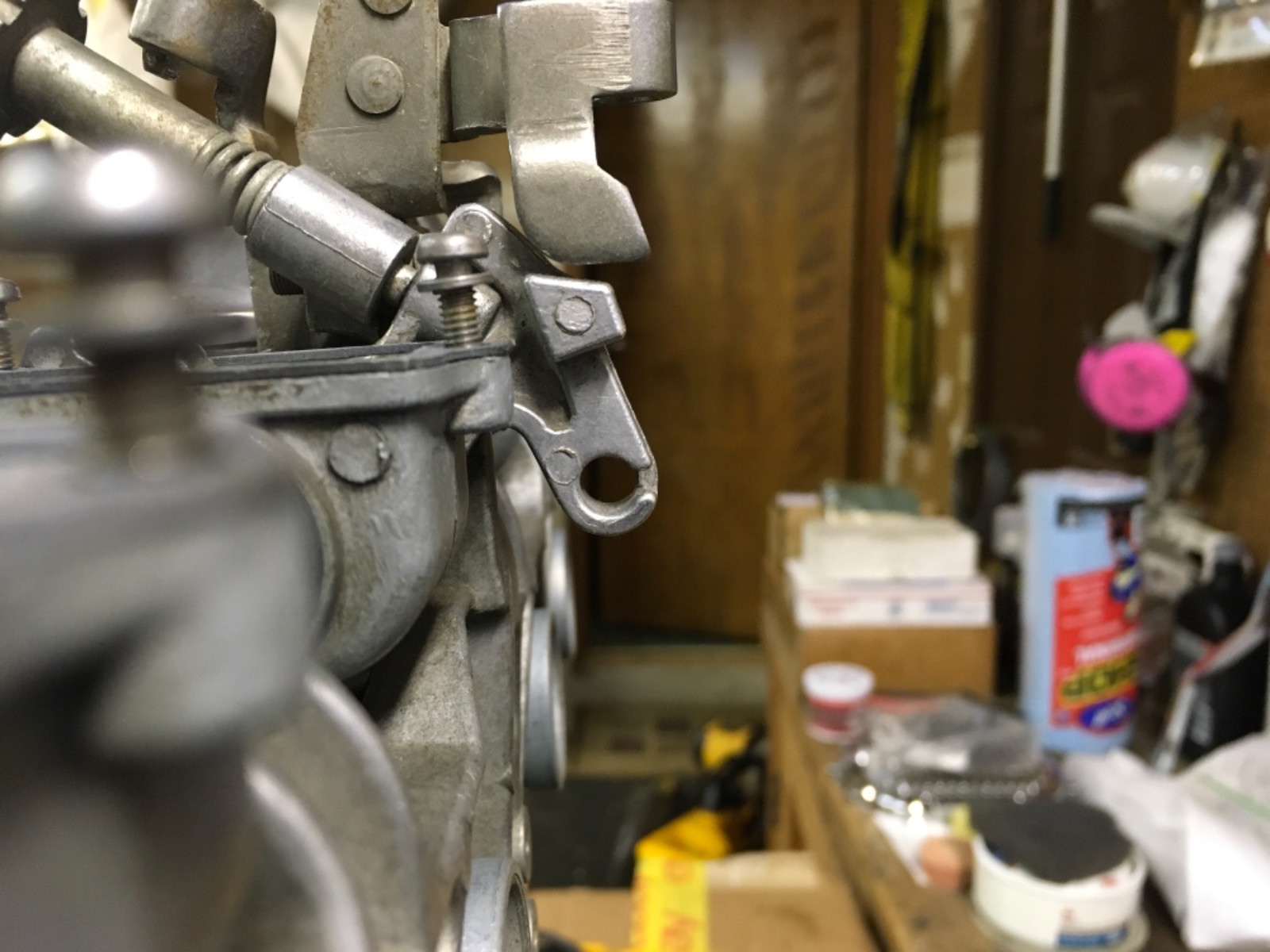

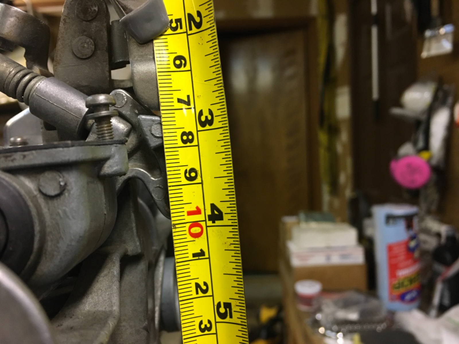

So I’ve got the bike back together after a bunch of work. And it’s running clean except that I’ve got a bit of a hanging idle when blip of throttle or ridiing and of throttle. I’m thinking I bench synced the carbs too far open. I’m gonna go back and re sync. My main question is, if in theory one is too bench sync .5mm-1mm wire with throttle stop screw set centered. Wouldn’t it work the same if your settle the carb slides gently closed with the throttle stop screw are out 3/4 of its position work the same??

Bench sync is to get the carbs close so the engine will start. It’s also to get the idle speed screw into the correct range for proper idle adjustments. Your correct in theory if you lower the slides by the idle speed screw you have effectively bench sync’d them with a smaller wire. You hanging idle is not from a bench sync with a wire to dig. It’s a sign of a lean mixture. You can try adjusting the pilot screws. If they are between the air box and slides they adjust air. Turning them in will make your mixture rich, less are added to fuel. Out will be lean. If they are between the slid and the engine they adjust fuel. Out more fuel, rich, in less fuel, lean.

My reasoning behind thinking i need to reset my slides lower is that I don’t have any more out adjustment on the throttle stop screw . Which tells me the carbs slides are set too high and/or didn’t set my throttle set screw close
enough to center for adjustment range

Open this manual and read pages 17-19.
www.kzrider.com/modules/ServiceManuals/K...Service%20Manual.pdf
The first step to a bench sync is to adjust the idle adjustment screw to 1.6 to 2.0 mm gap between the throttle pulley and the stop bracket.
