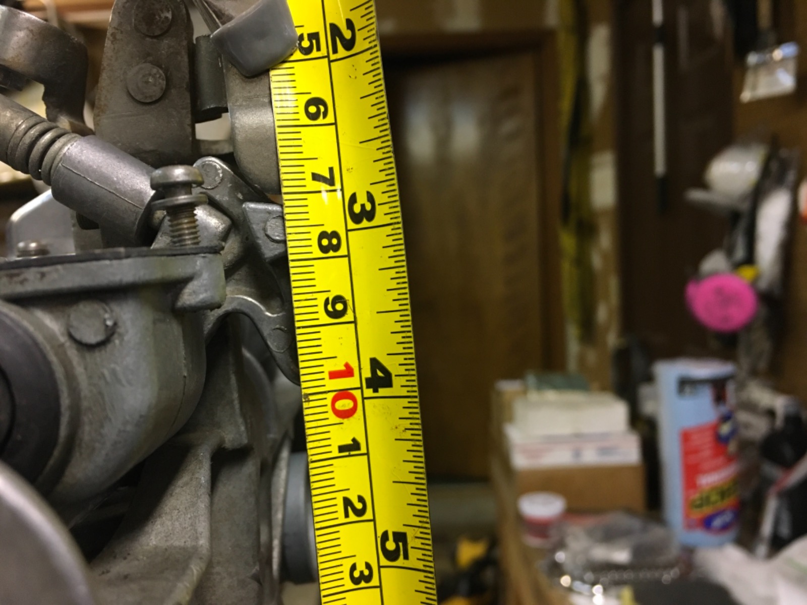

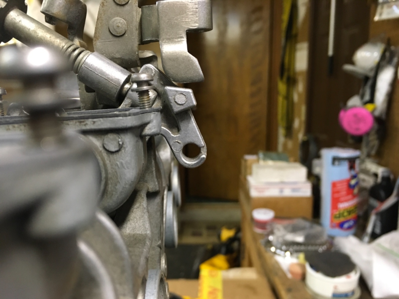

Re: Carbs sync
23 Apr 2021 17:28 - 23 Apr 2021 17:37
Last edit: 23 Apr 2021 17:37 by Mikaw.
The following user(s) said Thank You: Fox

Re: Carbs sync
23 Apr 2021 17:39 - 23 Apr 2021 17:39
Updated to the correct model. I first posted for the Z1R “D”
Updated the FSM page to the “A” model
Last edit: 23 Apr 2021 17:39 by Mikaw.
