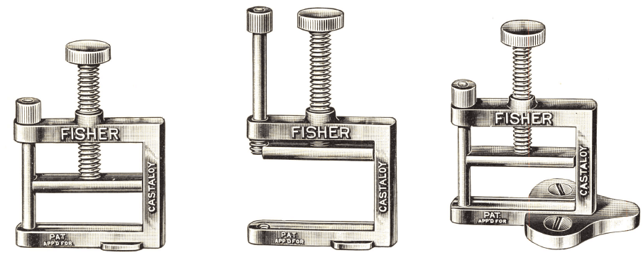

Clamp the vacuum line shut with g clap, small grips or similar, saves having to disconnect and block ports etc.
start engine and run until it starts to die then lift choke lever increasingly until it dies on full choke.
The choke pick up is lowest point in the bowl after the drain screw so if it's dies on virtually full choke then both jets and all passages will be fuel free and won't clog.
