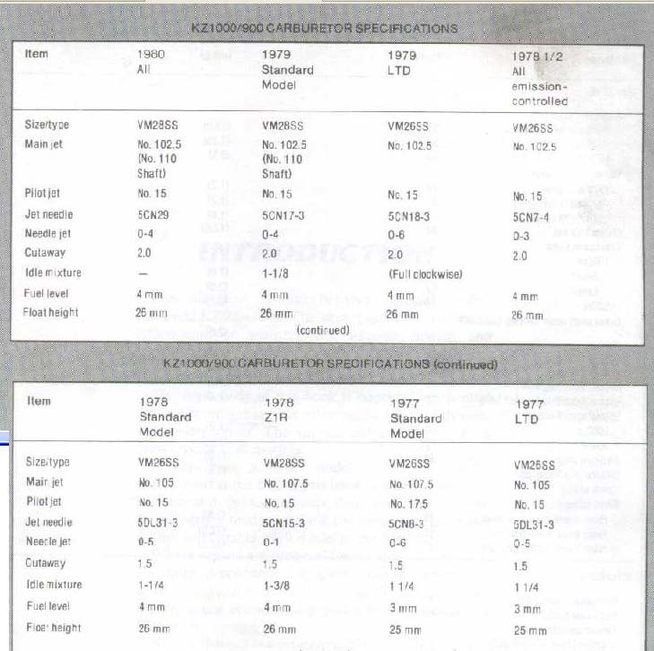

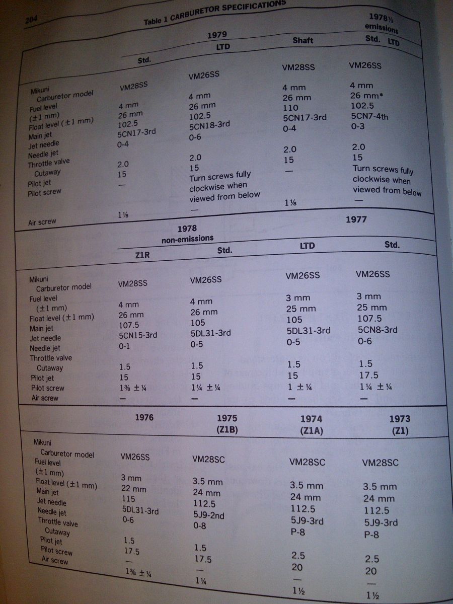

VM28SS on kz1000 1978 thru 1980.
Z1R , LTD, MK2 , and ST shaft.
Just look at your current jet sizes and needle code to determine what model they are off.
You can cross reference either from a factory manual or by matching up to the contents list of the Keyster kits.
Unless damaged you must retain as many genuine Mikuni parts as possible.
Main parts to renew = Gaskets, 'O' rings (use viton replacements) and usually the float valve and choke plunger.
Fuel tees also perish. If they don't soften and expand after being soaked in fuel a while then brass or alloy 'O' ringed replacements are available.
If you must replace any brass internals then go for genuine Mikuni first with most available from Niche Cycles and Jets R Us.
I don't recommend any pattern jet kits apart from KEYSTER.

So With the cabs picture. I guess I have a 5cn29.. so difficult to find adjustable needles. I dont trust so much Dynojet, but they have a full kit for 150$. Its only that that I can find
Kz750e 1980

08 Apr 2023 08:55
Jets R Us
jetsrus.com/individual_parts/JRU-8027A.html
sells needles and shims.
