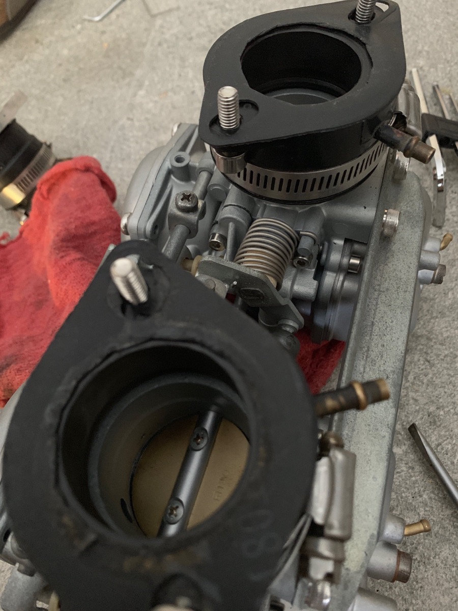

I recently found new (old) BS-38s for my KZ750B after fighting with the VM34s for over a year and not getting the bike to run properly. Plug after plug got carbonized, bike was running too rich, tried everything single pilot out there with every float height and setup and nothing did it. My next step was, let's try the original carburetors this bike was designed for. I finally got them and got the new (old) boots as well, but they’re an incredible tight fit. I can only get the carbs half way in, can’t go over the rubber 'ring' that's in the middle that I’m guessing is was fully holds them in place. Is it suppose to be this difficult to get them in ? Also do I use a gasket between the boots and the engine or just screw them in without any gasket?

The lower one in the picture looks used. If the rubber is hard, there is a good chance they will leak. A picture or two from the side might make it more clear to forum members if the boots are fully seated.
No gasket should be used. If the rubber is hard, they will not seal. Some Three-Bond or Hylomar may help for a while, but they will only work if the rubber is supple.

I managed to snap them in place using a little bit of red n tacky but that was with the boots not installed of course, would’ve been impossible if they were mounted on the engine. Getting them screwed to the engine was another challenge. The rubber is definitely rock hard, no way they were made that tight of a fit. Looking for a better solution for boots though if i find one I’ll post.
