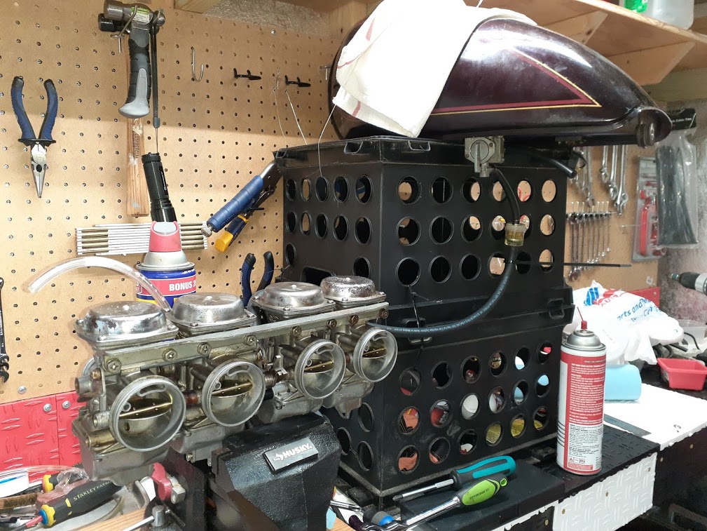

Last edit: 25 Feb 2021 20:49 by Bluegoose. Reason: added pic

Ugh. Re-installed the carbs and now get a fast idle (`3k rpm). I didn't mess with the floats or needles or anything really. I just took them apart to replace the o-rings in the fuel tubes. Trying to think if there's anything I could have missed when re-assembling but it was pretty straightforward and didn't have any issues that I could see. Thoughts? TIA.

26 Feb 2021 18:49Nessism wrote: Have you replaced the intake boots that bolt to the head? If they are the originals it's common for them to leak vacuum, particularly when pulling the carbs which stresses them.
Yeah, that's what I'm suspecting too as they are the originals. I'm going to look at them very closely tomorrow and use the starter fluid trick around the boots where they connect. It's possible I didn't get them seated all the way properly too as they were a real bear getting them on. Any tips on re-installing them? Is it safe to use a little petroleum jelly or something to lube them a bit? Thanks!

Re: Fuel "T" tube leaking
26 Feb 2021 18:56hardrockminer wrote: What Matt said. Or possibly your throttle valves are too far open at idle.
The throttle valves look like they are correct. I have a very slight gap at the bottom and all 4 look exactly the same. I'm definitely leaning toward the boots as they are the original 40-year-old boots and I've been taking the carbs off and on a lot before I finally smartened up and did a bench wet test. Thanks!
